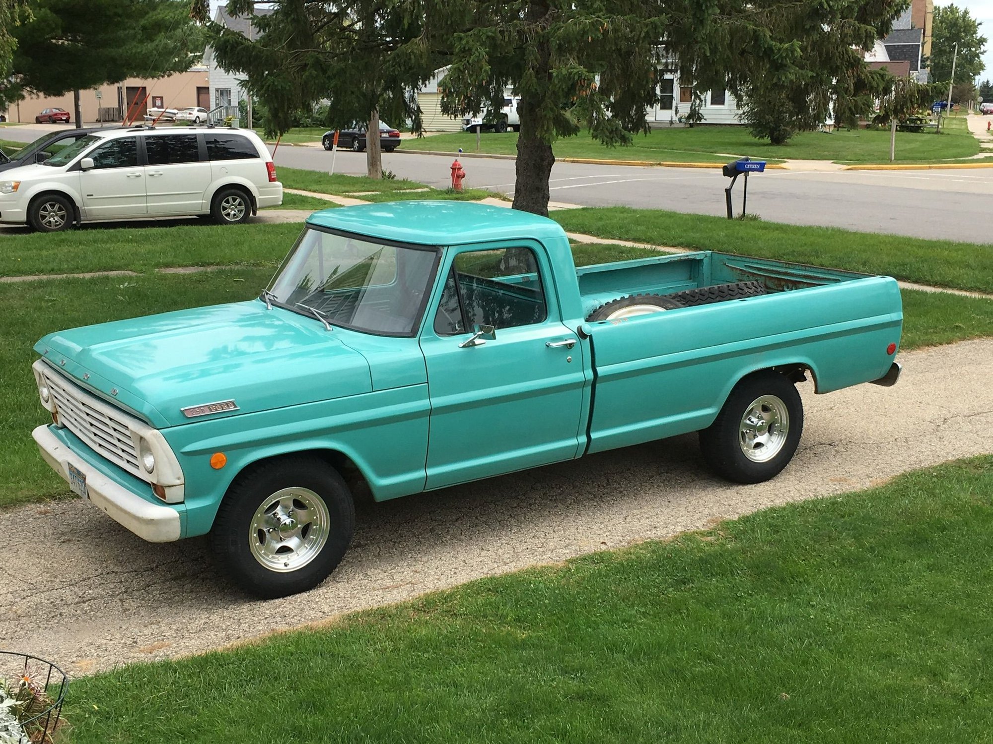

These are the wheels. Currently they’re on my 67 f100 2wd running 245/75r16 the wheels are 16x8 with either 4” or 4.5” back spacing. Looks like the 265s are just over an inch taller and about an inch wider. If this helps. Thanks guys.
