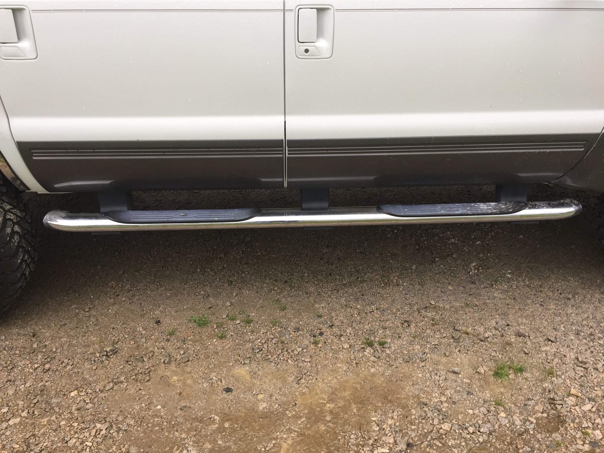

You might be able to do the Ford accessory Nerf Bars, then it looks like you'll still have room for side exhaust below those.
My Nerf Bars below....

That was actually something i had thought about, but instead of just using those in conjunction, i kinda want to figure out a way to have mounts like that, and have the exhaust in place of that bar.
The issue with that would be that it would look kinda goofy, and it would be hard to insulate it where you would want to step
In reality the idea i like the most is to tuck the pipes as close as i can to the rockers, while still being out a bit to keep something in that area
