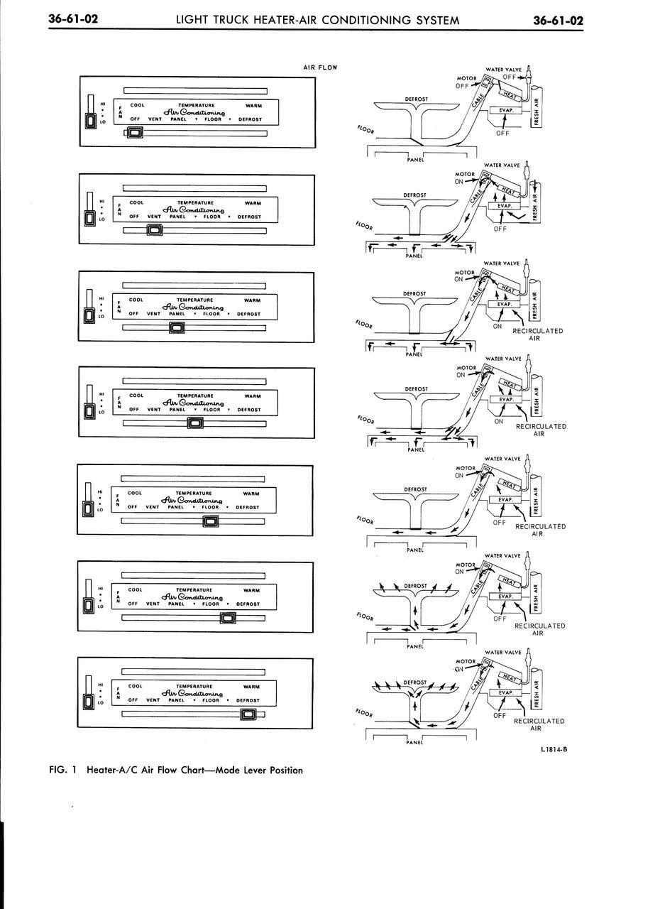

Update, both new switches are in, have full fan control and power but it only come out of the defroster , cold and hot work.
Must be something affecting the blend system somewhere. Rich any ideas?

Are you sure all the vacuum controls (door motors/vacuum motors) are working?

UPDATE:
I now have fully functioning heat! Replaced the switches and also sorted out that the main vacuum line for the A/C controls was disconnected. Reattached that and walla!
Now i need to source some of the black mounting screws (and really a whole climate/radio plate) and start buttoning up the dash. HOWEVER i am getting a whistle/whine from my system at times so might need a new blower motor (which i have already)
One step at a time!
Big thanks to Rich for the advice and parts and to everyone who chimed in!
