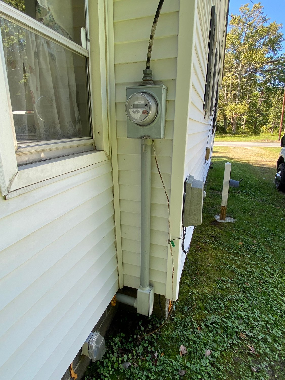

Thought maybe some pictures might help. Took awhile to upload them with my parents slow internet.

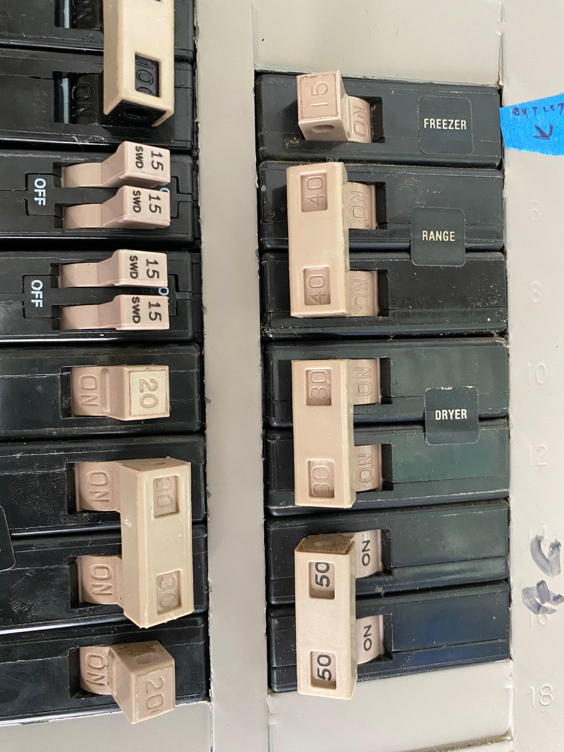

Currently this is whats in my breaker panel. Im sure thats been upgraded since the 1950s because everything ive found said fuses were popular then not breakers. And i know these particular type breakers are hard to find because i had trouble finding them. (Guy at the store i finally found the replacement at said they were being phased out). The outlets in the house are a mixture of 3 prong grounded and 2 prong not grounded. The 3 and 2 are not on the same circuits though. There is a couple that are 3 prong but not grounded with the 3rd wire because its not there. (Hope to fix that eventually). Been reading i can have those pass by just installing gfi breakers.
Which the guy that was supposed to be helping me with this wanted to throw a fit over the 3 doubles on one side of the box. (Was like that when i bought the house).

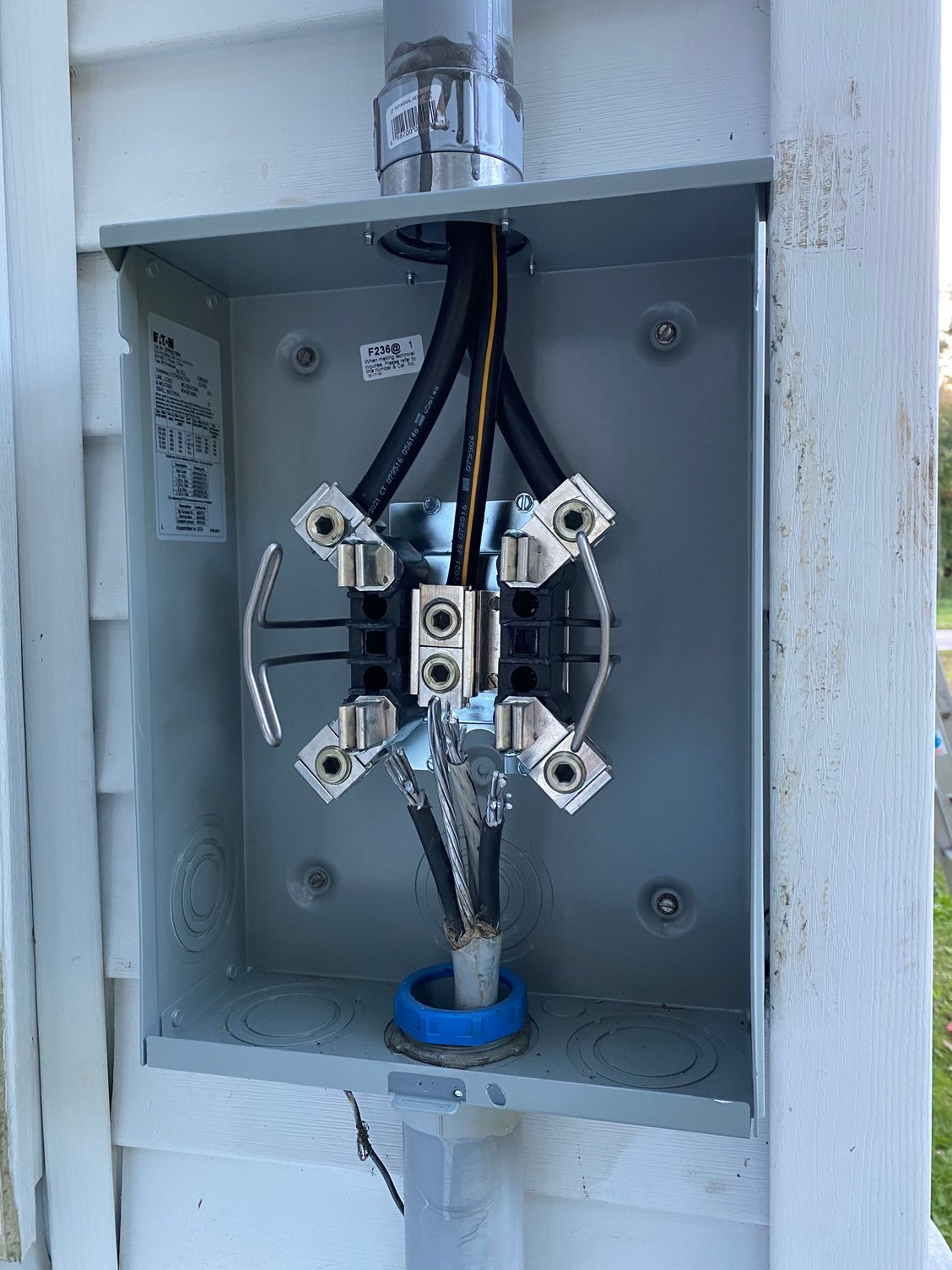

Current meter box how its set up.

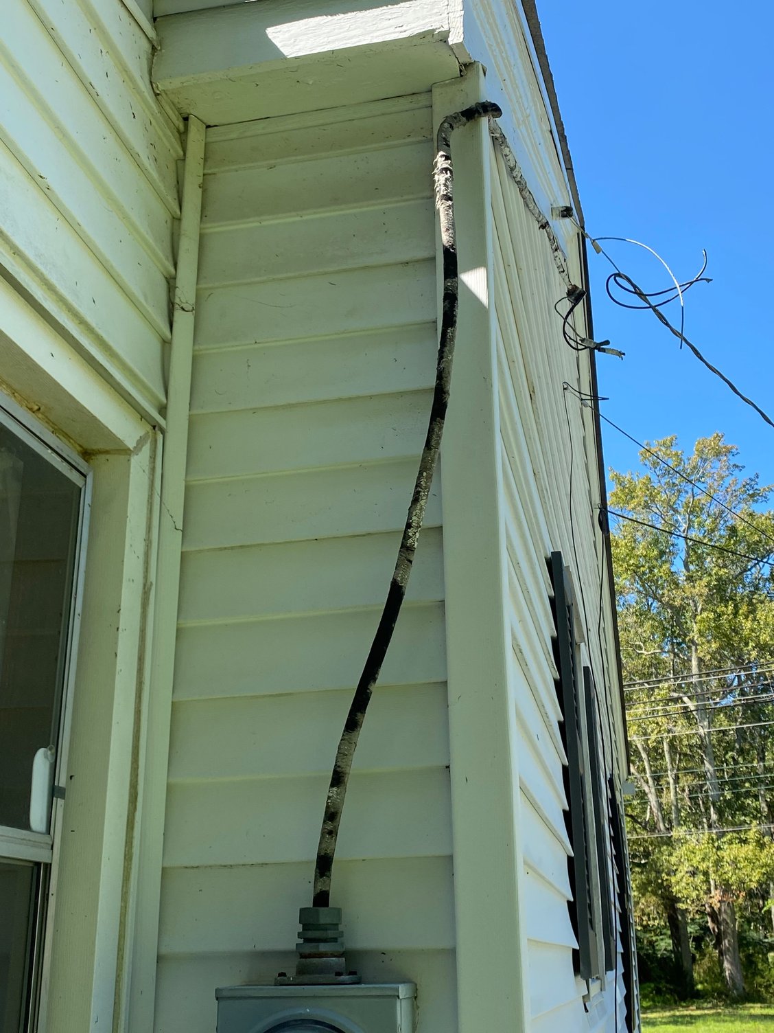

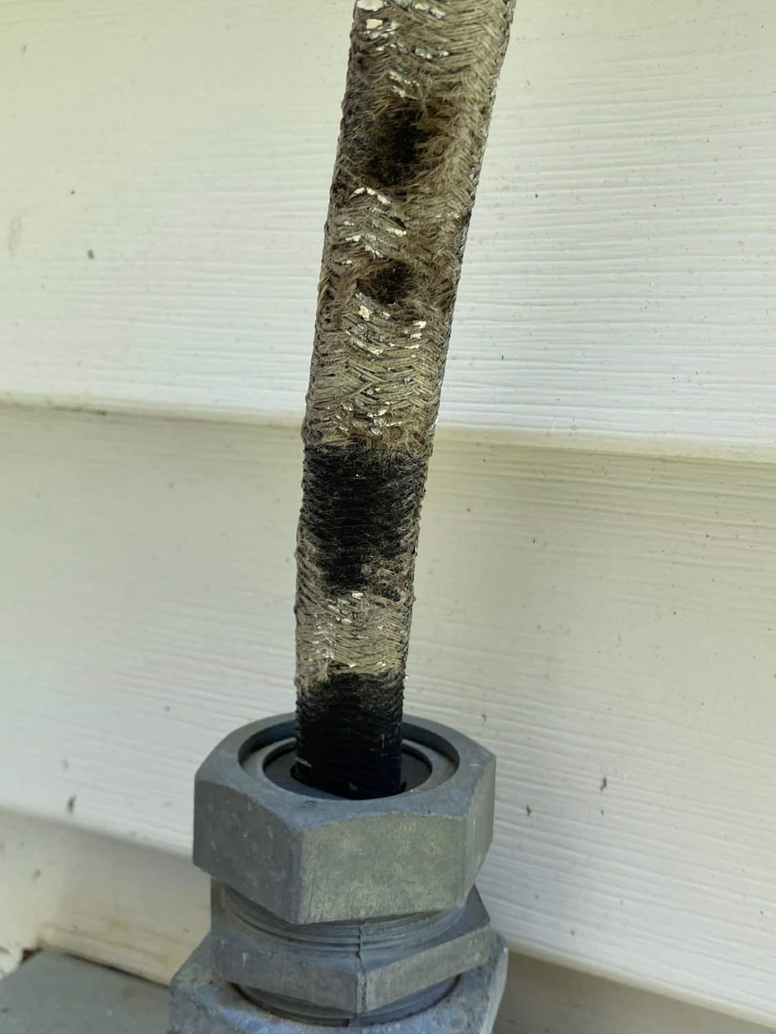

Im told thats asbestos covered wire.
Also was told the way the wires run from the meter box wasnt to code for even 1950.
Currently powers disconnected. Because i was told it was a fire hazard (see why in last pic.)
The smaller wire there is the "phone line". Not that it works lol.

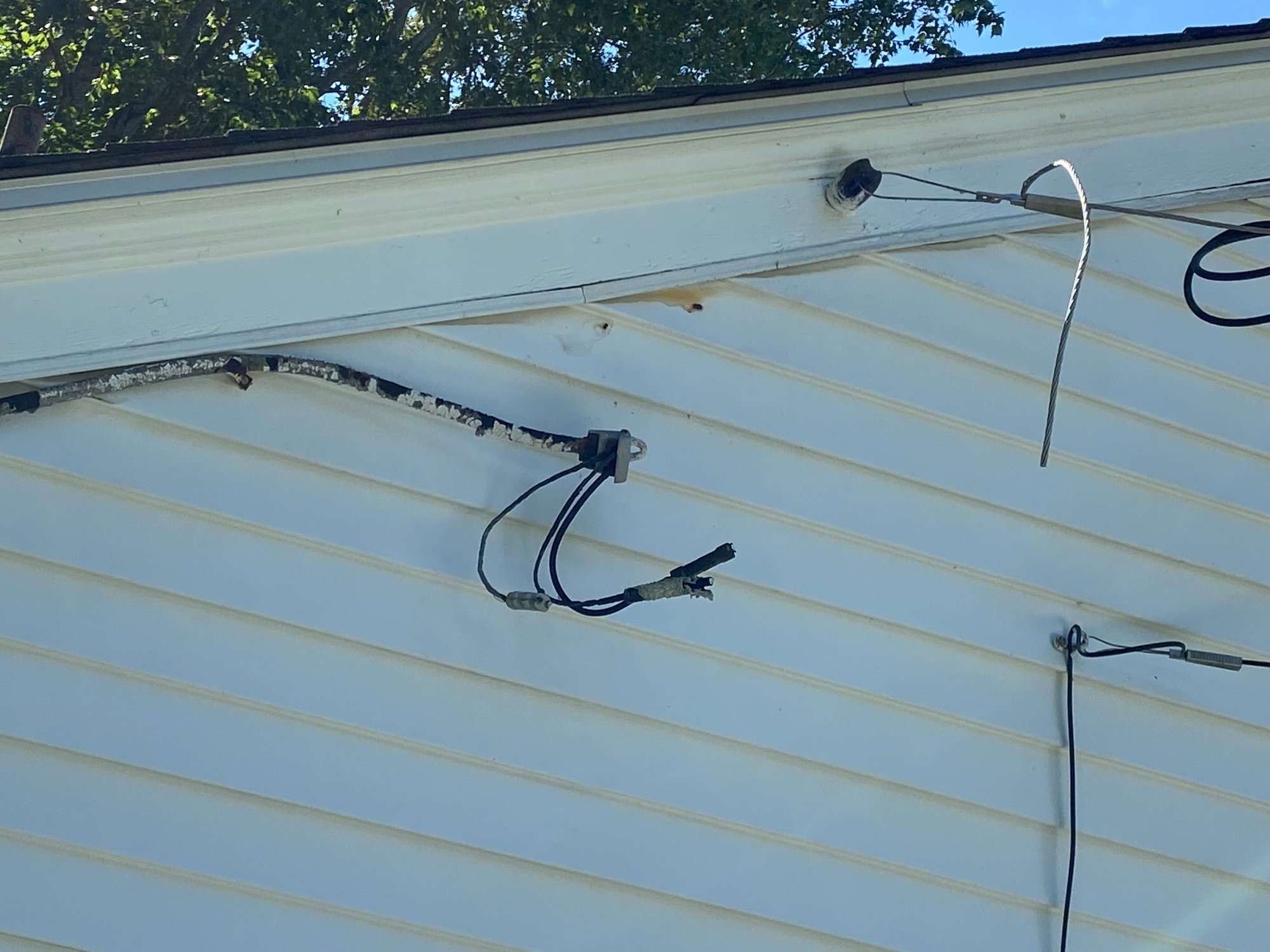

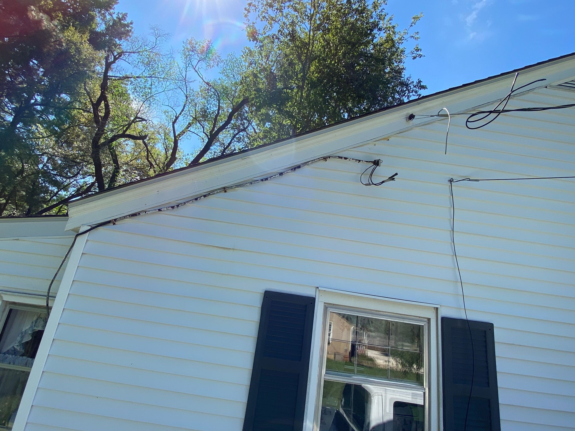

this is why i was told my house was a fire hazard and had to be disconnected right now or else. Bare wires from the service connection to the weather head.

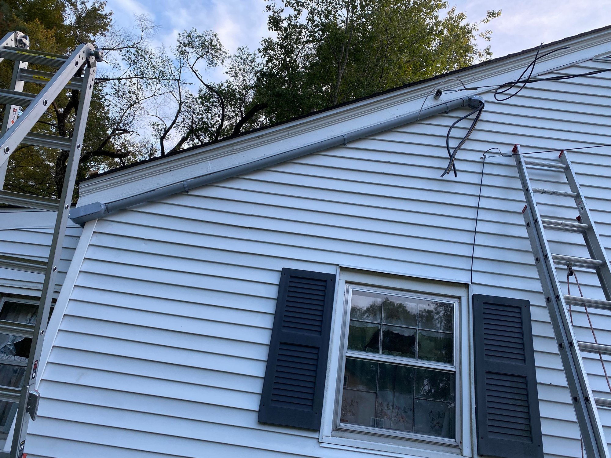

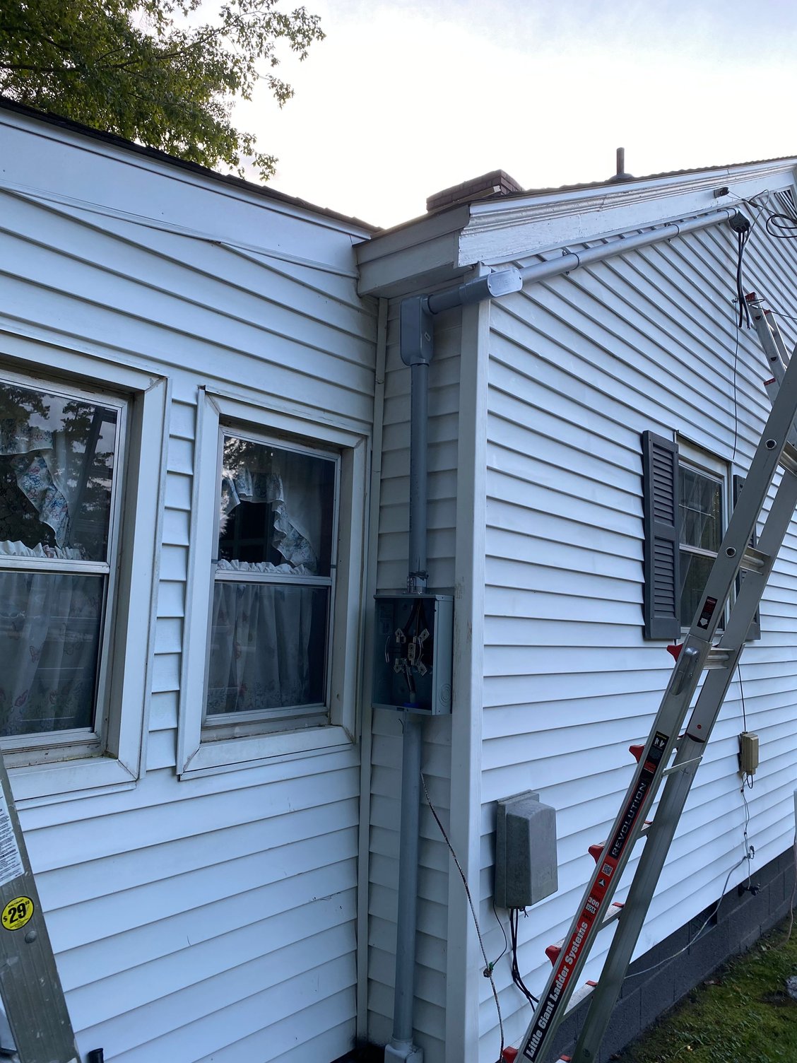

took me all day. But finally got the conduit and wires up. Had the meter box on over a week ago. But didnt know i needed the hub part. When i was getting the pieces originally the ppl at the hardware store never mentioned it. Then when i went back for it they were like "ohh yeah they all fit the same." Ummm no they dont. So had to wait a week for the right one to come in.
least that parts done. Just gotta replace the breaker box and wires to and from it. Hoping that will be easier.
