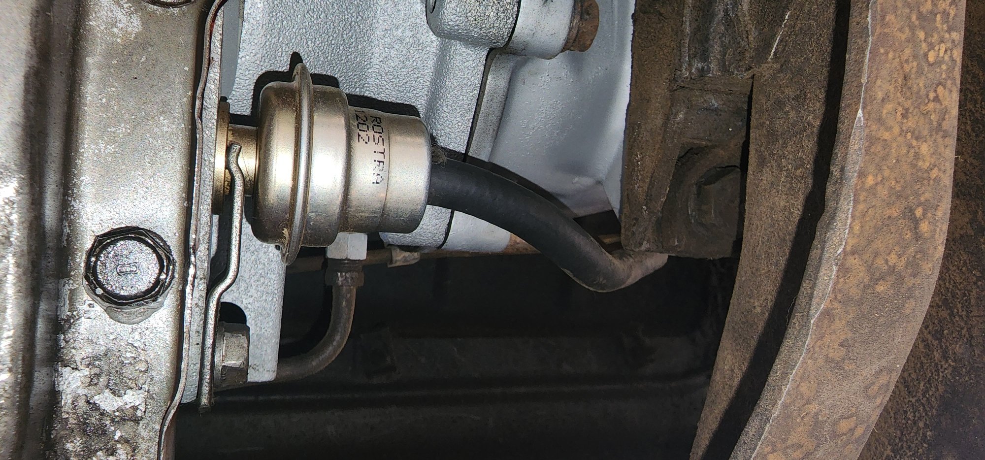

As others have said, you will be fine without kick down. It's only needed to assist in down shifting. Lever should be spring loaded from the valve body and be fine with no kickdown rod attached. Almost sounds like the vacuum modulator isn't hooked up. Look for another shop, they don't want your business. Only thing simpler than a C6 or C4 is a powerglide. Aamco answer is pretty lame. Try to find an old shop, like been in business since the 60's.

Modulator is hooked up and not filled with fluid.
