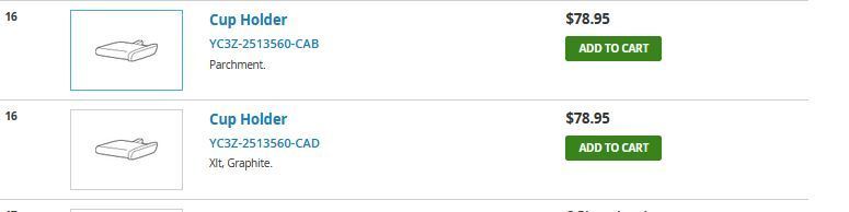

I find these for the 2001.
When you enter a 2001 Limited, they show as NOT compatible. Those two numbers show as for an XLT. Probably a color difference?
can you post the link where it shows compatible with the 2001 Limited?

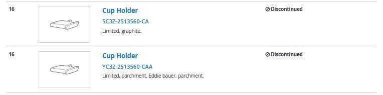

Here are the part numbers for Limited.

Apparently there’s a fourth part number.
YC3Z-2513560-CA
YC3Z-2513560-CAA
YC3Z-2513560-CAB
YC3Z-2513560-CAD
When I enter any of the part numbers above, the only one that comes up fitting the 2001 Limited is YC3Z-2513560-CA. This part lists as “graphite” color. Mine looks more like dark brown. My interior is no different than any other Limited in tan (Medium Parchment).
01_Excursion, you have always had the best answers to my dilemmas. Swapping the faces is definitely an option.
I’ll get this cleared up tomorrow when Ford dealer parts are open.

Well, a quick call to Ford parts and he came up with the part number YC3Z-2513560-CAA and as luck would have it, not a single one available.
