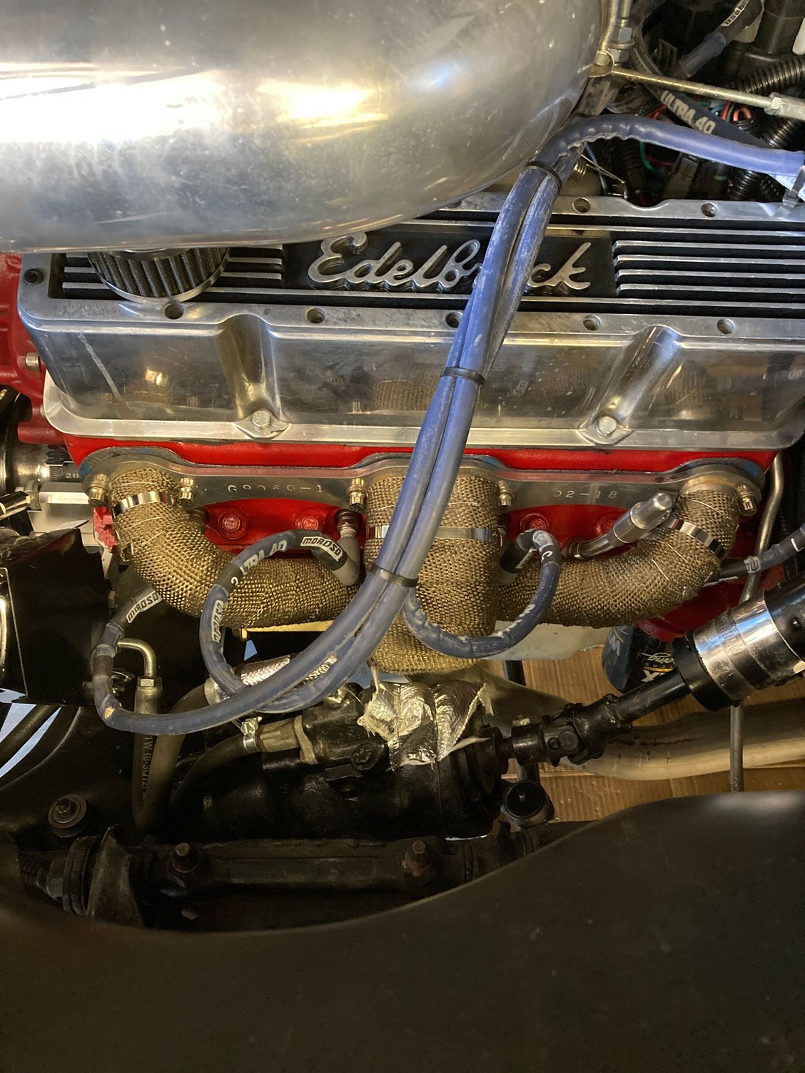

Due to the location of the steering box and the headers, it turned out to be a heat issue. I wrapped the headers as much as I did not want to, but they look pretty good. I did have to replace the pump as I believe the extended heat cycles effected it. I did find some synthetic power steering fluid. I have driven it several trips of 30 minutes and the issue is gone, It does not get so hot now that I cannot hold my hand on the steering box or pump like before. I have since remove the foil from the steering box as it is not needed. Not sure if that helps you out.
