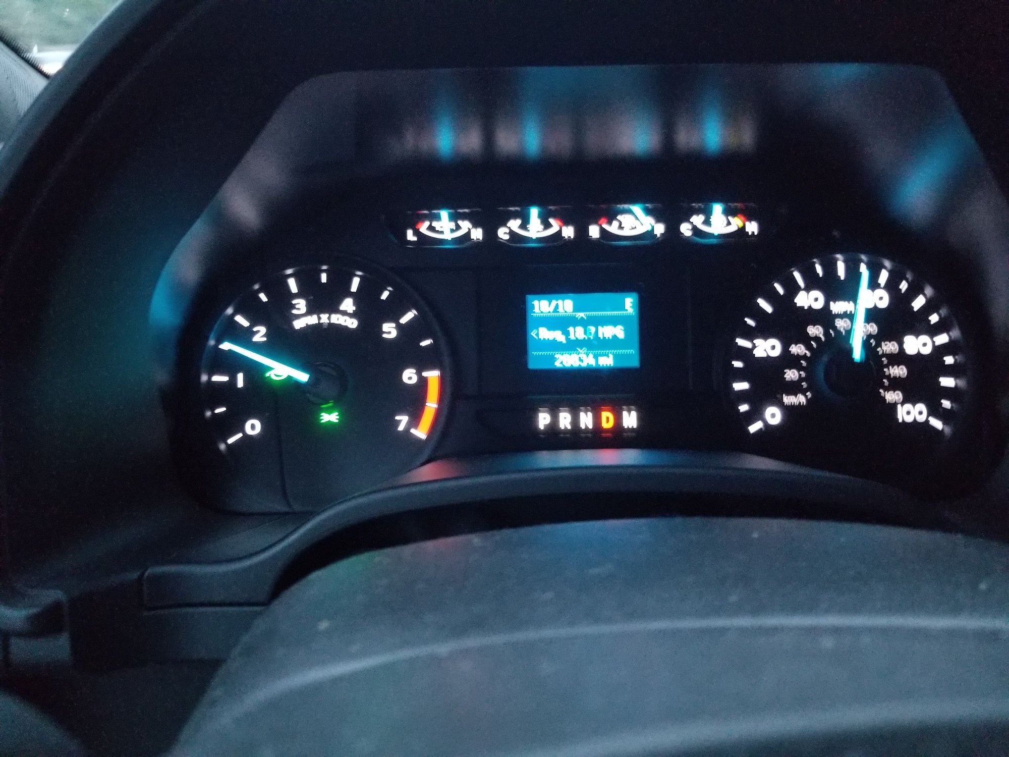

Interesting "Lie-o-meter" issue
Many of you may have experienced this,but if you haven't you will.
Preface: At 8000 miles i changed my mileage number on the computer to accurately give the correct mileage. Mine is set at .964.
I keep mileage on my f350. The other day i filled up my truck with $100 worth and reset my trip meter. My mileage for the pryor tank was 15.5 mpg.
Notice the mileage, 18.7 mpg. My truck is a 7.3 with 4.30s. I knew this was off by 2 mpg. This is the problem. The inaccurate data continues to display until the truck is turned off and sits.
This is the mileage driving the same way going home. Notice the difference. This happens every time. So for those of you looking to check mileage, the computer is off even when you reset it to account for factory calibration. This morning is right where it should be at 16.6 mpg for my commute loop.

I don't even look at the MPG average on the dash anymore. It's absolute malarkey. On my last tank, I tried to baby the truck and see how high I could get the meter to read. 14.5MPG is what it told me. Calculated by hand at my next fill up, 12.3. I don't appreciate the truck lying to me to make itself look better.

Some folks report great results from their Lie O Meter. Some will reset the AFE and then have great results. I don’t. I hand calculate every tank of fuel I put in. I took my averages and reset my AFE and it still doesn’t work. Sometimes it’s over, sometimes it’s under and every once in a while it’ll be really close. I personally think it’s worse if you do a lot of mixed driving… city, stop and go, highway, loaded, unloaded, etc… regardless, I never trust mine and just hand calculate it so I know exactly what the number really is.

If the truck has been running, then you fill it and reset the trip meter, it always happens. The error is higher in the summer then the winter months. I think Fords computer programmer needs to go back to school.
