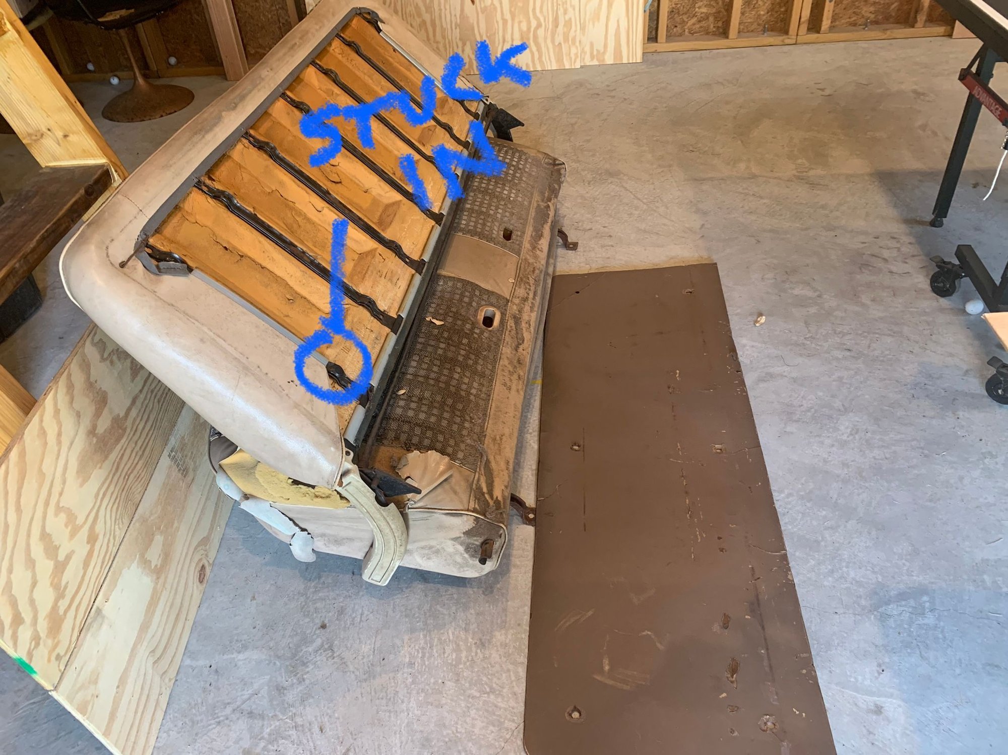

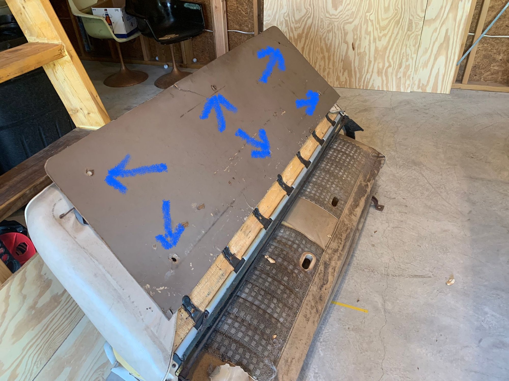

Step 1: Remove the old back panel. Note - my fasteners literally just pulled through the old back panel instead of coming out of the seat.
I had to use wire cutters to cut the old heads off then remove the insert from the foam side.

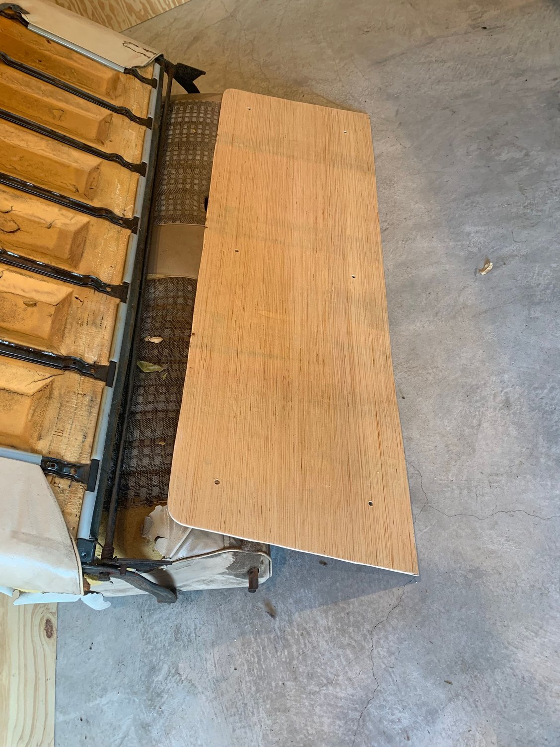

Step 2: trace the back onto a thin piece of plywood and and mark the holes for the fastener locations. The plywood sheet I had laying around was the perfect thickness. Use a jigsaw so you can just cut the curves to match. Drill out the holes, I think I used a 1/2” or 5/8 bit.
Step 3: once cut out I sanded the edges and put a nice little bevel around the sides and top. Sanding the exposed side wouldn’t be a bad idea either if you want it smooth for painting.

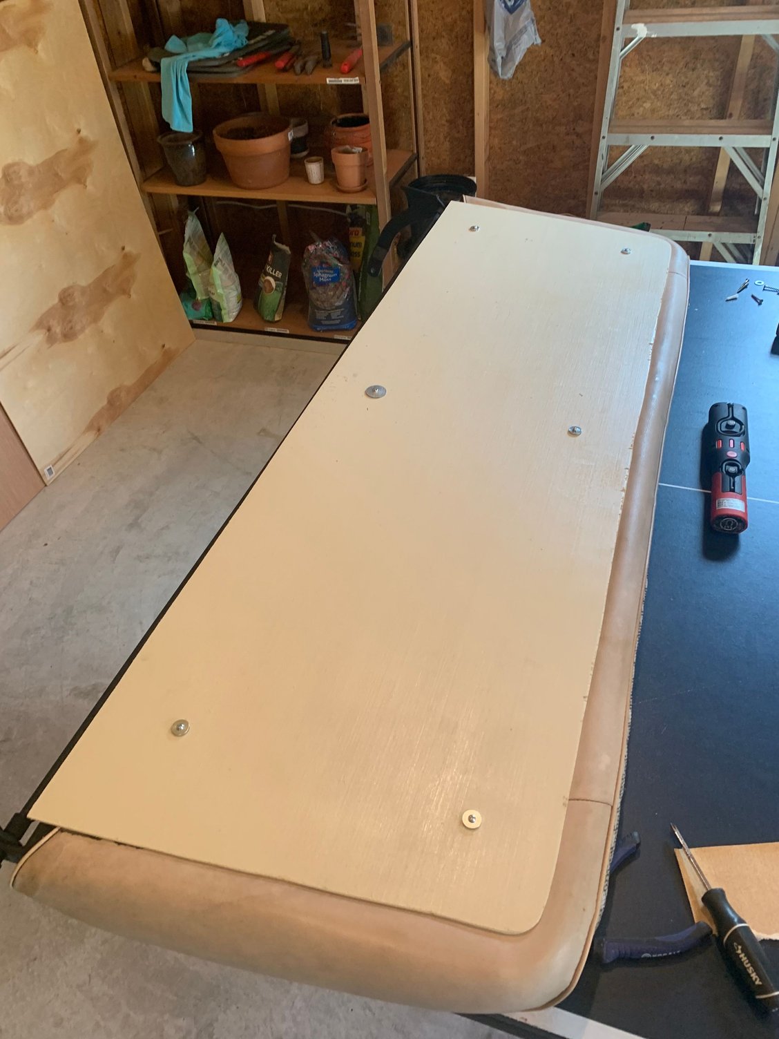

Once the wood is set on then back on the seat, you can use a couple screwdrivers to put down through a couple holes to line it up while starting your fasteners. I started with the “compatible” fasteners I got… but of course they didn’t work at all because they are too stiff and don’t fit in the holes… so I went rouge and came up with a makeshift fastener system that somehow actually works.
Yes… that is a drywall insert 😂… I used a small drywall insert, a washer, and a relatively small screw. I literally put them together just like it is pictured, with the screw just 1/4 turn or so in, just enough to hold the insert on the end. Then I just put it through the hole in the plywood and down through the hole in the seat, and started to screw it down. Now it never actually got tight, but I think the seat padding grabbed the insert enough to snug the new seat back nice and firm to the back of the seat… and it passed a pull test to see if it would pop loose 🤷🏻‍♂️

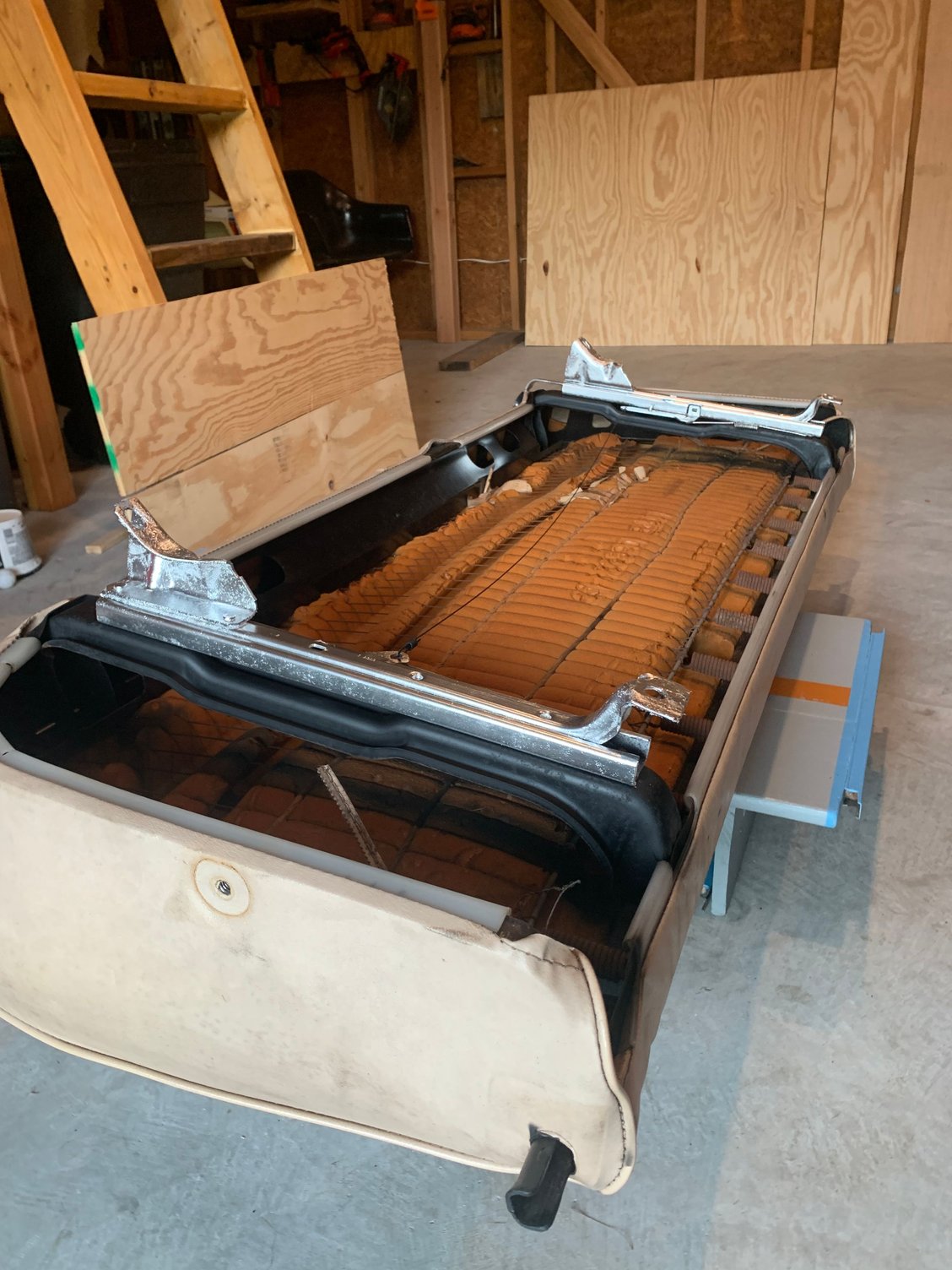

side picture: the base was covered in surface rust, so I took it off, disassemble the seat rails from the floor mount, and painted all exposed metal on the seat and mounts with rust reformer. I had a can of chrome-ish paint sitting around and decided to give the base a style upgrade 😂
