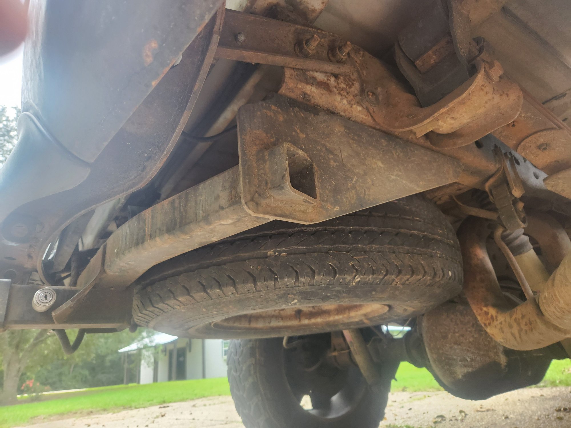

Not really rusty, mostly just dirty. I really need to wash the underside of my truck. As you can all see.....

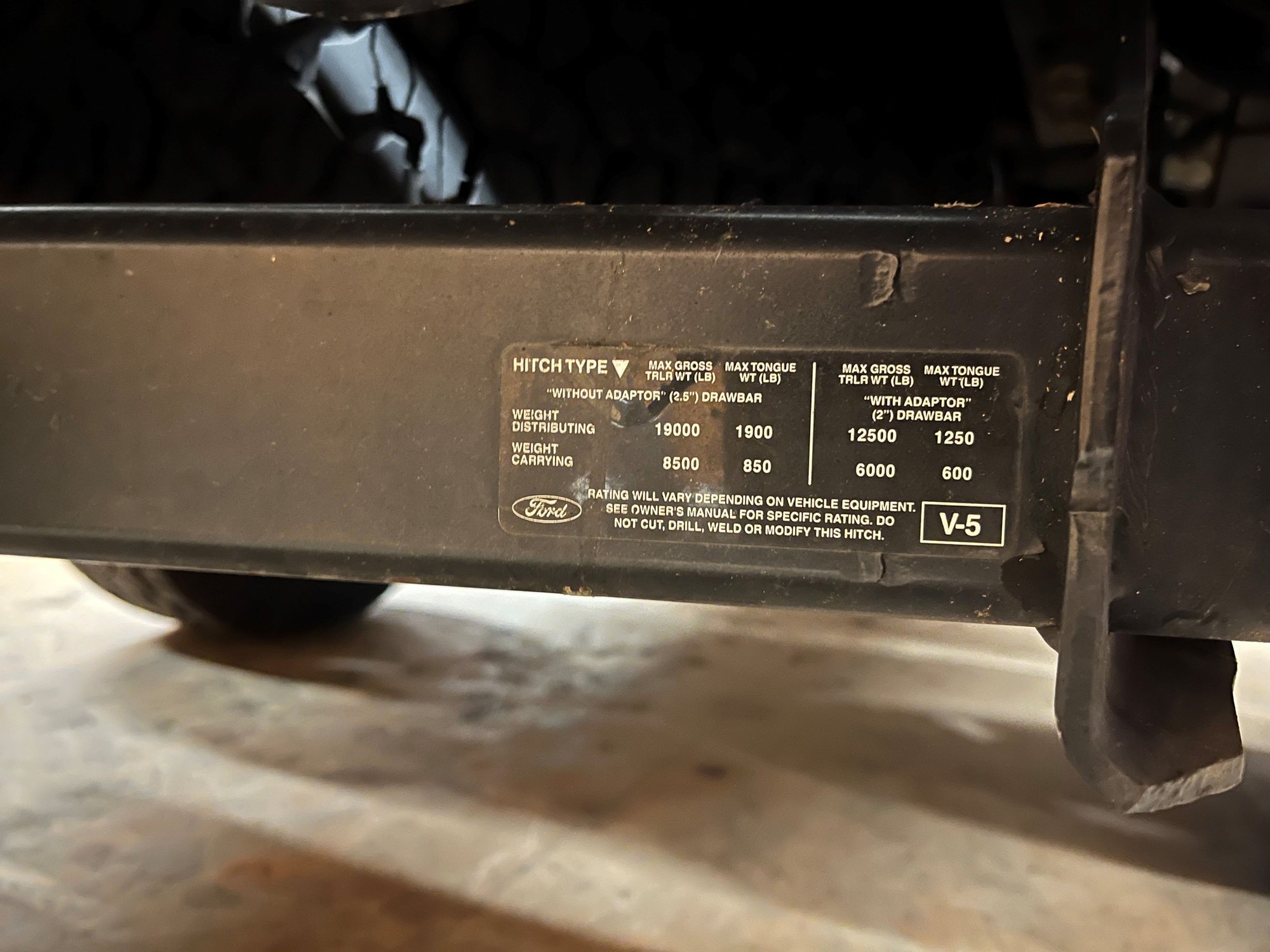

So far from the looks of it basing my hitch off of everybody else's, it seems my truck has a sissy hitch. Everyone else's is rated a good bit higher than mine. Maybe I should just replace the whole receiver. Then throw in some air bags, and I do want to get a dash cam. Just haven't done it yet. Did you use the atoto dash cam or did you get a different one? And I'm sure it's probably relatively simple to set up.
And also of course it gets more complicated with the airbags because you have to pick which one you want. One of them won't allow you to get a gooseneck ball on there, one of them won't let you have a fifth wheel attachment, so on so forth. Which kit did you get? They have some that mount on either side of the springs, on top of the springs and all kinds of what not. EDIT* I see you linked your install. Thanks!
It is possible that somebody replaced the hitch on this truck at some point. There ain't no telling, it's been around for so many years there's just no way of knowing.
All of that being said, if I am to replace my entire receiver, which brand is recommended? Reese makes one, and there are a bunch of other brands that make them for these trucks too. I would like one that maybe has bigger hook points for the chains. As always thanks for your help!

At some point after 2001, the Excursions got a "hitch upgrade" but it was just an increase in the diameter of the bolts that hold it on. I'm not sure if this applies to the trucks.
Nothing you do changes the weight rating of the truck from a legal perspective. Check the door plate to see what it says. Airbags and larger hitches may increase you capability, but they don't change that tag.

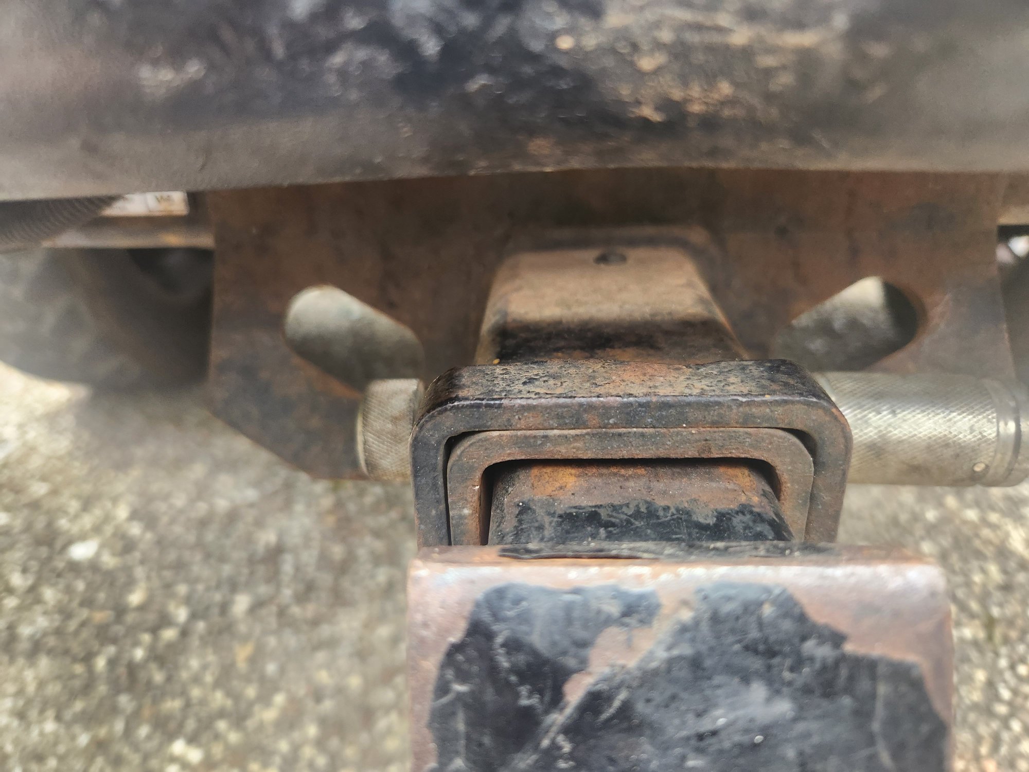

Yes, Get the highest rated hitch that you can.
After 12 years dragging my 11k-13k Toy Hauler around I found this when I arrived at camp 1100 miles from home last March. Luckily I caught it before complete disaster struck.
How did you resolve the Ford frame lower flanges that also got bent down?
What hitch do you replace the Valley hitch with?
