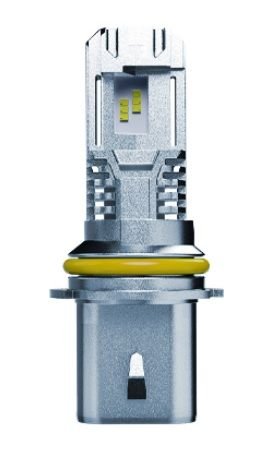

There are direct plug in 9007 LED bulbs available.
Just make sure you get ones with a proper LED array/module to mimic the halogen filament to avoid flare and a bad beam pattern.

^^^ these guys are right on the money. My used truck came with 3-sided LED headlight bulbs that did not mimic a halogen filament by adequately centering the light source - the focus was poor and I got flashed by drivers alot. Out they came.
I have '05 housings, so my bulb size is different, but same idea - try to find an LED bulb with a 2-sided design, that better centers the light source. This is what I'm currently trying out:
https://smile.amazon.com/dp/B087QG49...roduct_details
There are 9007 equivalents from LASFIT as well. The focus is pretty good, with a nice cutoff area on low beams. I did have to adjust the headlight housings a bit downward after installing, but a minor adjustment. Interested to see what you find with your installation.

I have the cheap LED bulb units in both our trucks...one with the older two piece headlight assemblies, and the other with the newer one piece headlight assemblies. I've had them installed for several years now, and it made a huge difference...and I've not had one person flash me thinking they were too bright. It's important to get the bulb units that mimic the halogen wire bulb as aforementioned...

I have the H7 version of these bulbs in another vehicle and they seem to be doing OK.
Nineo LED Nineo LED
Look for ones that have very thin LED's as pictured above. Most manufactures have figured that part out but there is still some garbage out there.
