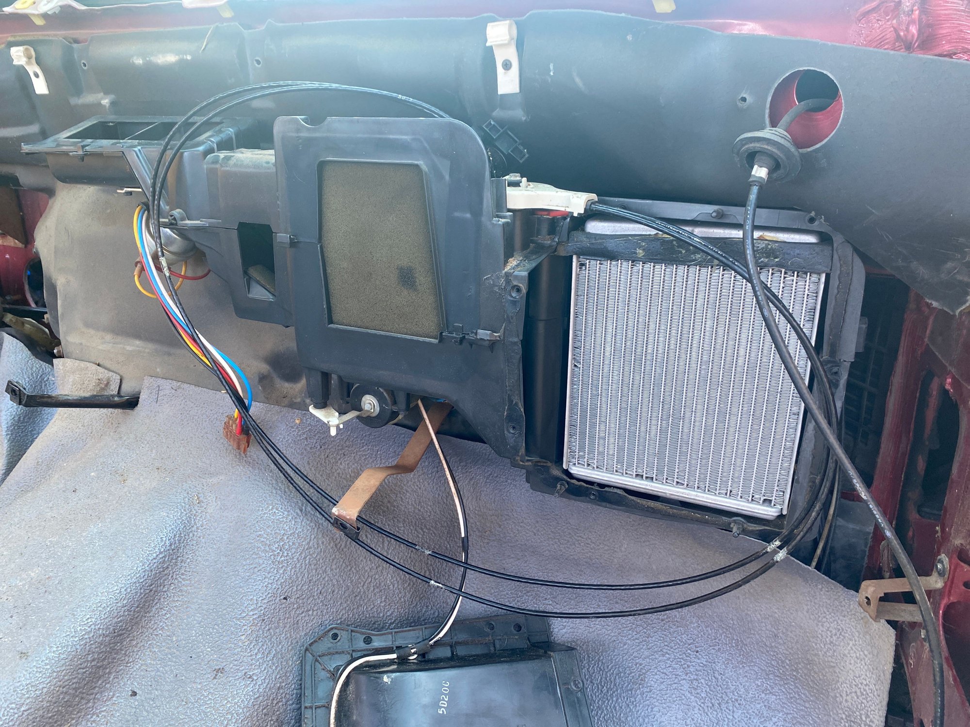

Interior air box removal
I’ve got a 1995 Ford F-250 and I’m mid cab swap. I can’t find any more screws but it’s still not coming out. What all needs to be done to remove the air box.

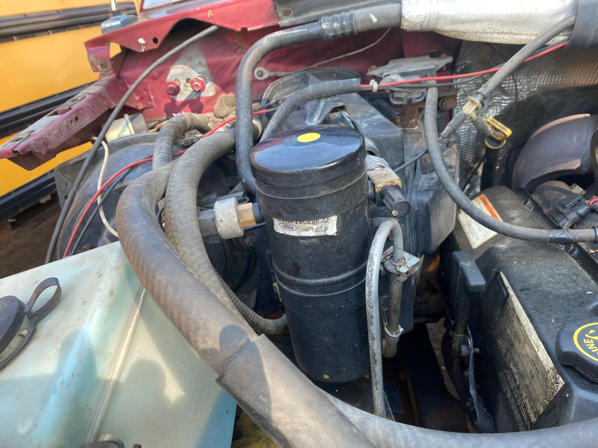

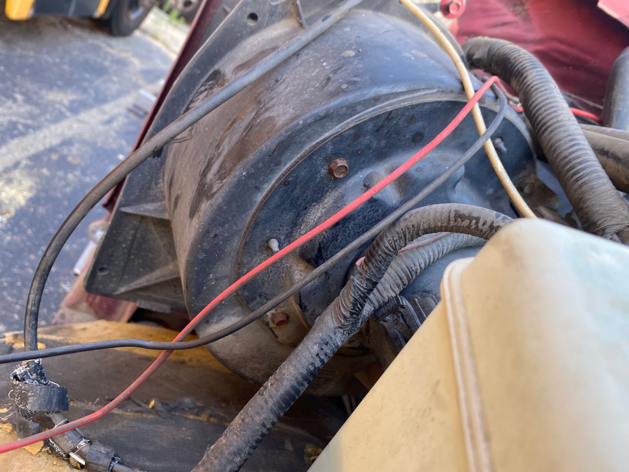

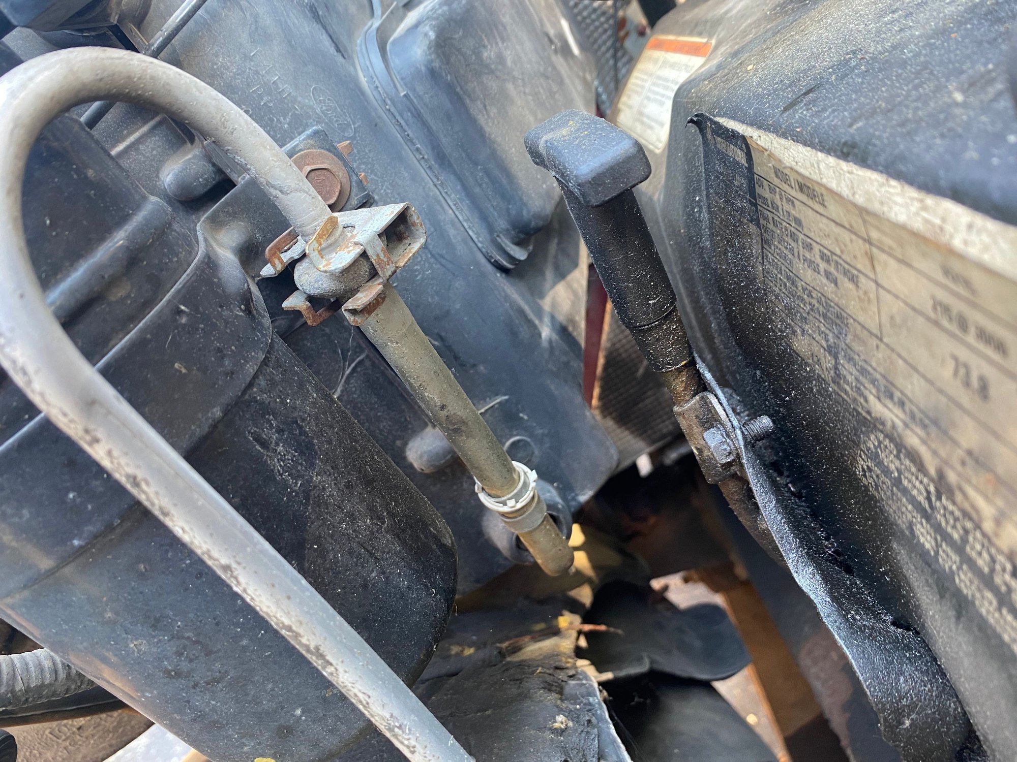

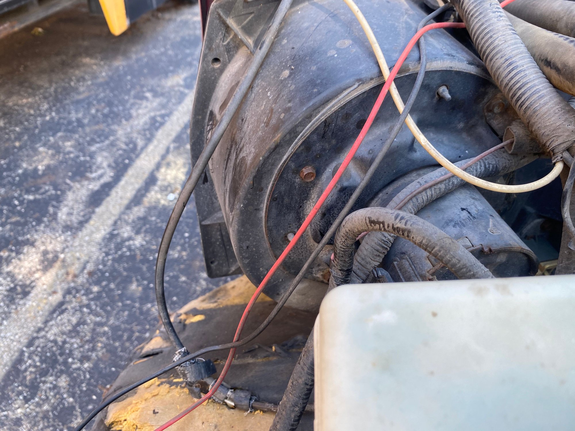

These bolts need to come out. I believe there's 4 of them. The heater core hoses need to be removed. The ac hoses and ac components and remain untouched.

Thanks for the help just pulled it off much easier than what I was thinking needed to be done.
