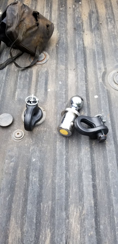

the bed with pucks, simply remove the rubber covers
hitch just drops in the holes.
or use the center and put a goosebox and the ball that goes in the hole
here is the ball and I use these curt items for the goosebox chains. They are big enough to accommodate the bigger clevis's

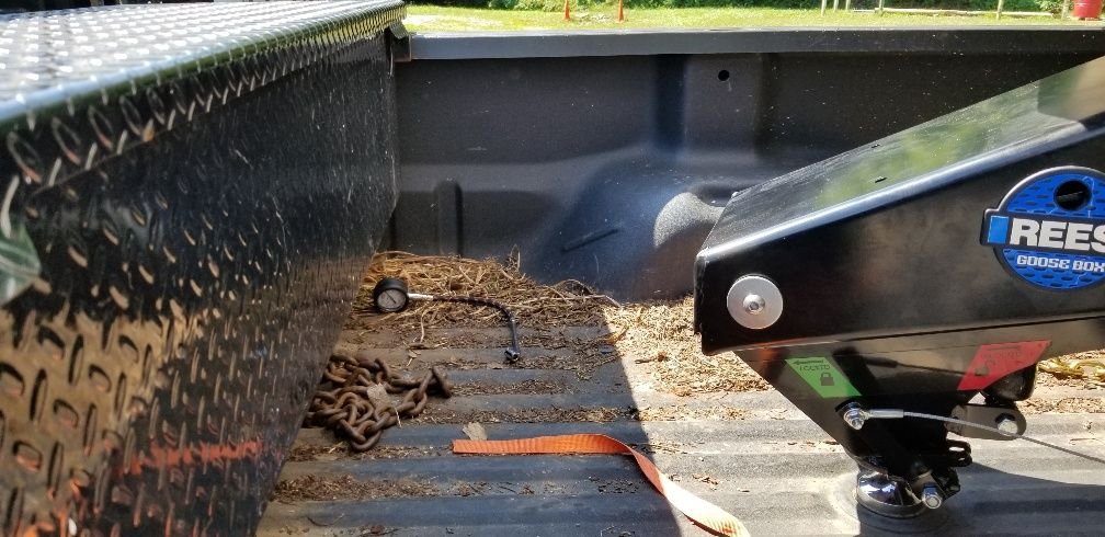

+5 for a Goosebox. Get the 20K version for your trailer. They will be the same dimensions as a pin box, mine was very close.
No issues turning with a CCSB with OE gooseneck set up. They have an air bladder and shocks to dampen any action. Minimal chucking if any.

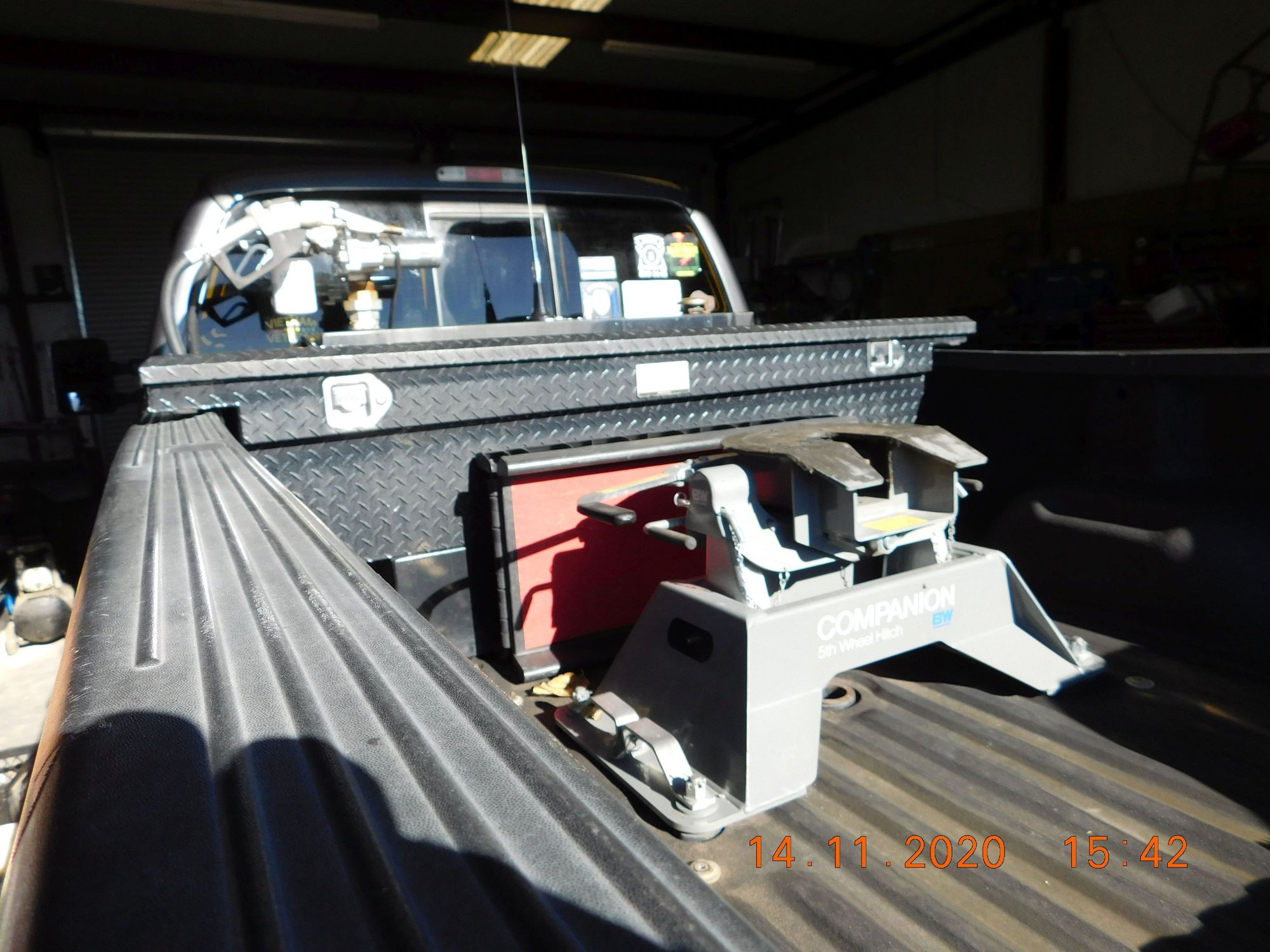

2015 F350 long bed Crew cab with a B&W hitch on the OEM pucks.
