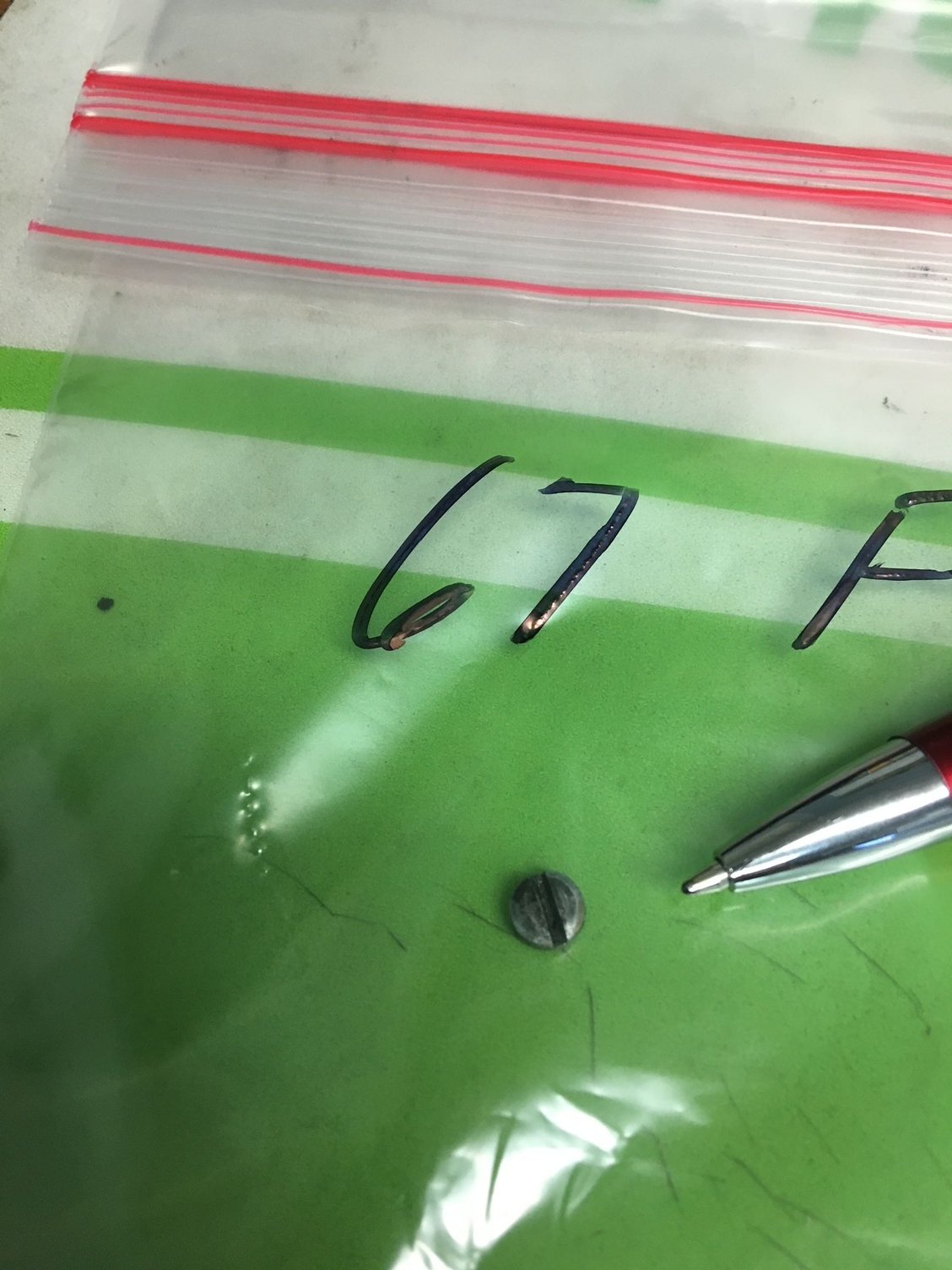

Circling back here. Of all the things, turns out the screws holding the throttle plates were defective / over-torqued and one snapped off and obviously got sucked into the engine. Pictures below. Couldn't believe it. When trying to remove another one of those screws. it snapped in two pretty easily, so clearly going to replace all 4 screws. Thankfully, no damage to engine, other than a little ding on top of the piston head.
Having replactement screws sent, but had a questions for the forum. This is for an Autolite 2100 2bbl refurbished carb (manufactured in 67 based on the tag serial number). Do those screws have a particular torque value? Should Loctite be used and if so what type? Anything else I should be thinking about so this doesn't happen again? Thanks so much!

Once you get the new screw tight, squeeze the threads with vise grips so that end of the threads is oval. Now the screw can't come back out.
