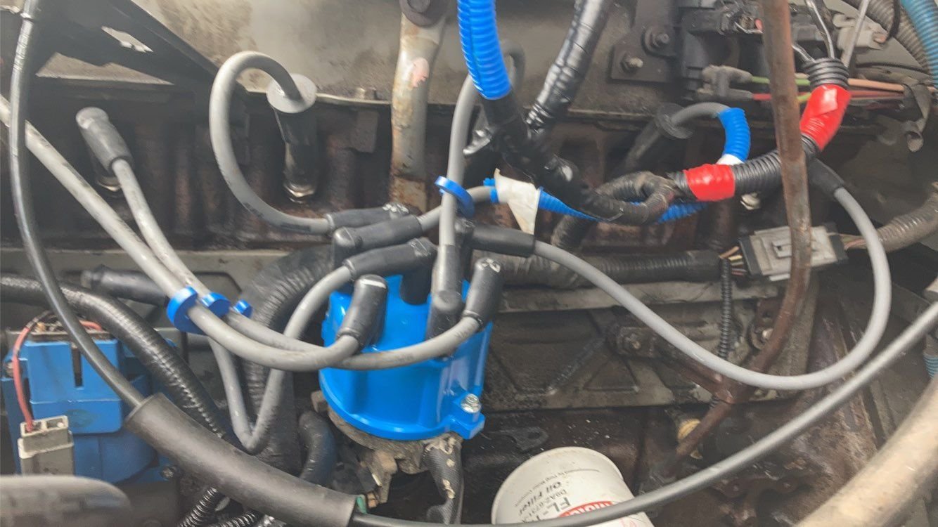

ronnie, ANY PICTURES? Show us underhood. You have been here before yes but let us know what you have done as a refresher

so I reviewed your posts, you have 330,000km+
You have plug wires that run by eachother, possible you could be looking at induction causing starting issues

that's the best pic I can get right now because it's dark and that's just the light from the street light. Probably doesn't help you much

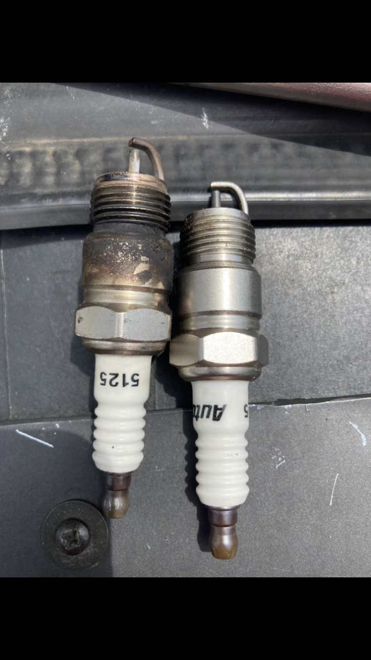

Also when did you last do a tune up? This here is just a pic of 2 autolite plugs for one of these trucks, If you were to pull 1 and check, if you see what the left one looks like, you have another issue but hopefully not

Not sure how old Battery is. I got it at junk yard 3yrs ago when I got the truck. I've never changed the plugs. So take the terminals off and clean the Battery posts with a wire brush or something? I'm sure There's no relay on the fender by the Battery like in that picture. I do have a set of auto lite copper plugs here for it tho. It runs really good so I just never put them in

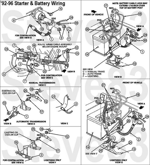

The factory negative is notoriously ****
Also the ground connection to the engine block is done through the connection at the starter bolt, which piggy backs to the frame on the frame rail(visible in diagram and in engine bay)
Then it goes to your battery cable. If the new one doesnt or if you want to ever increase the quality of the grounds, you should consider going to the alternator bracket or the alternator. It would require taking the alternator off to do it right, which you prob dont want to do this minute., but in the morning youll be able to see more
