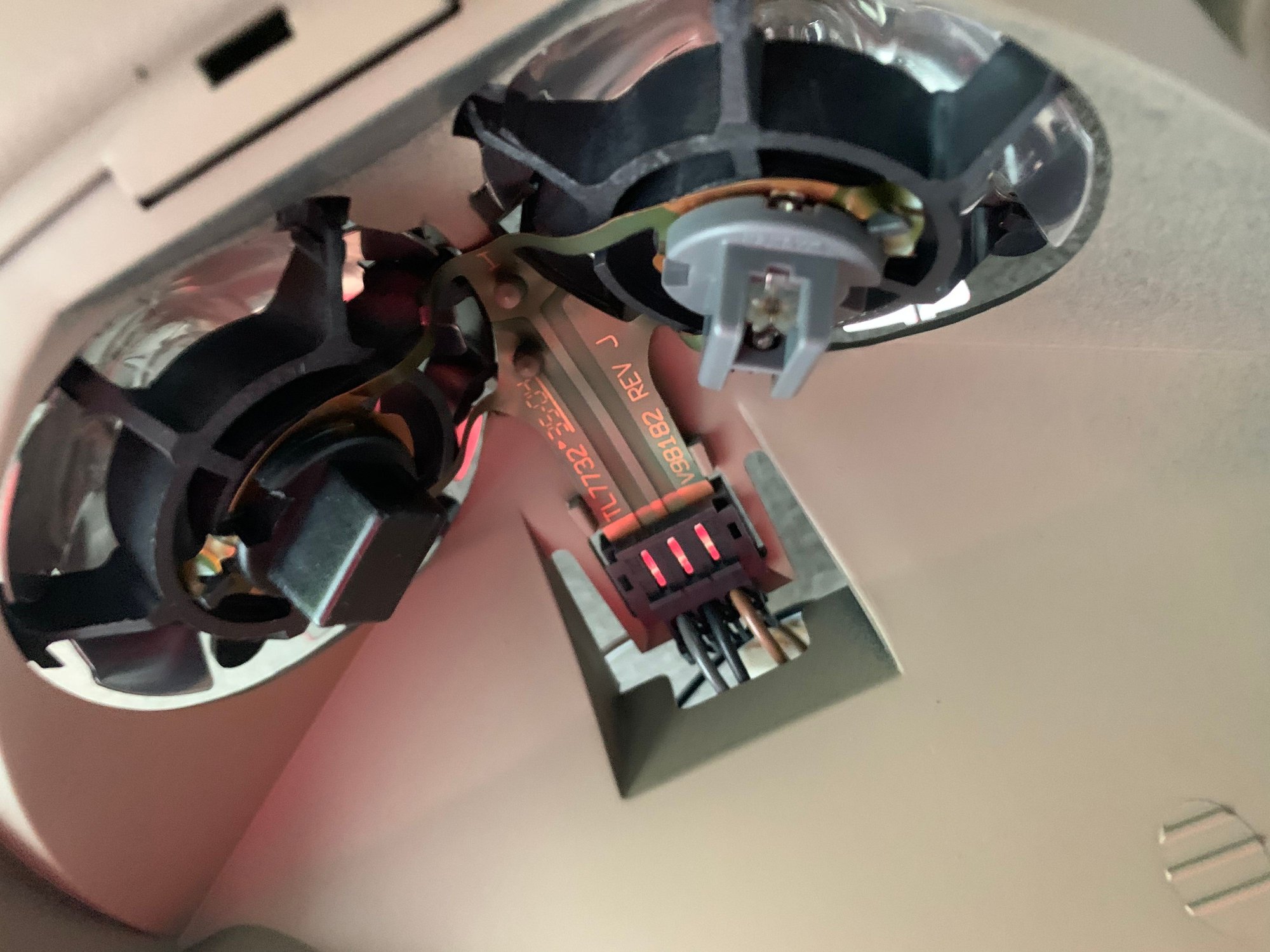

See the pictures.
All I wanted to do was replace 1 stinking bulb a while back and now look what I’ve done.
No lights working, a bunch of little white plastic parts (actuators etc) fell out, and I’m left with what you see here.
I’m looking for an Easy Button here.
Is there a kit or whole assembly that I can just — easily — plop in there and my problem is solved?
Whether Motorcraft or aftermarket— I just want this to work again. My local shop doesn’t want to touch it.
If what I’m describing isn’t possible then what advice might anyone have? (Short of going to the stealership).
Thanks in advance to anyone who can help.
-sgc2c

The map light light push switches are known to fall apart over time, junkyard items there.
