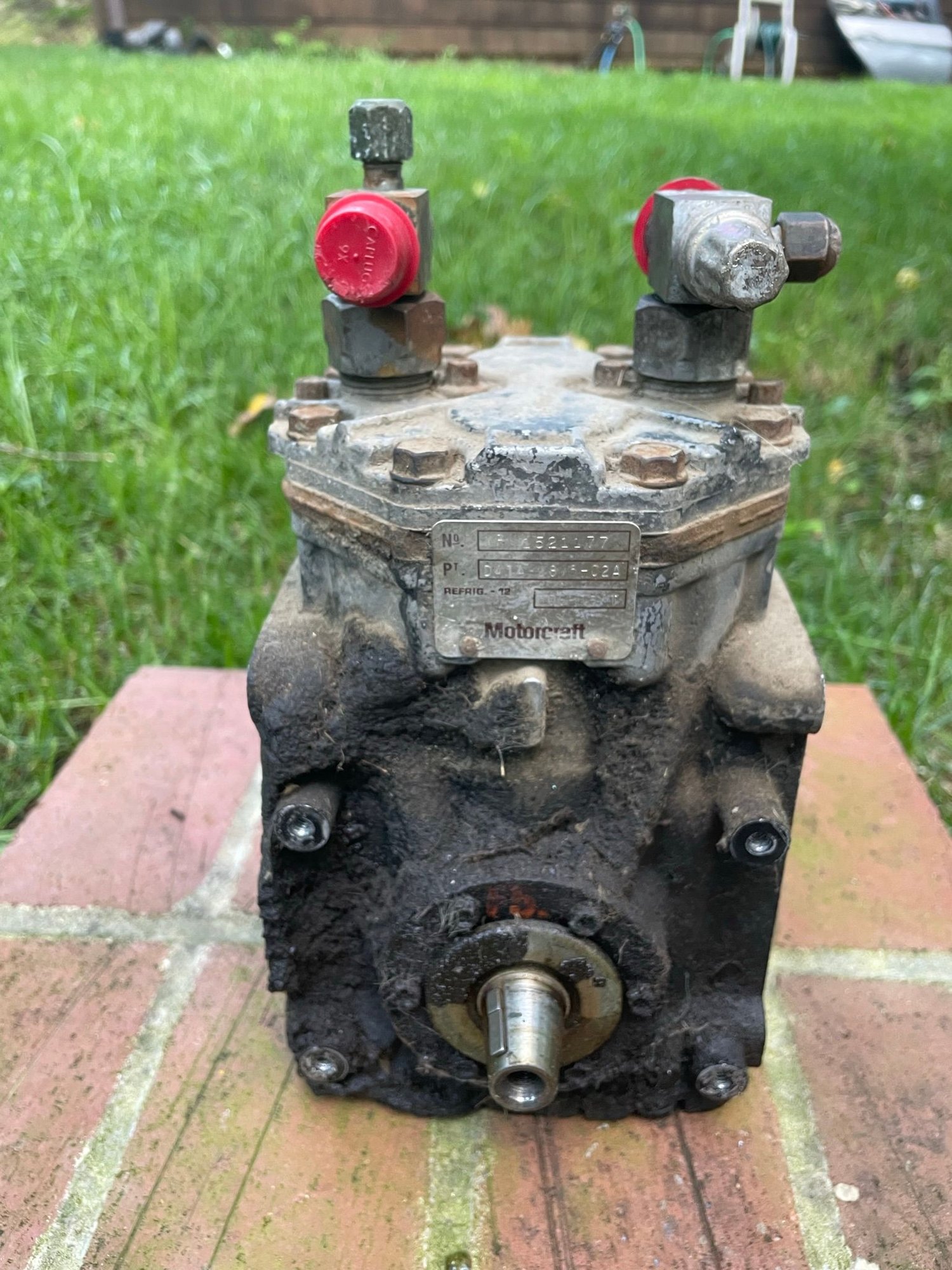

I have this OE one that came off a 1976 F250 that needs a new home.
This one worked well when removed?

Yes, I am told it was fine. I buy parts from a fellow in South Dakota that parts these trucks out.
It’s clean inside, spins freely, and pumps air as I turn the shaft.
I would clean it up and stick a seal kit in it and of course, fresh oil.
$70 shipped anywhere in continental U.S.
I would reseal it to be safe.

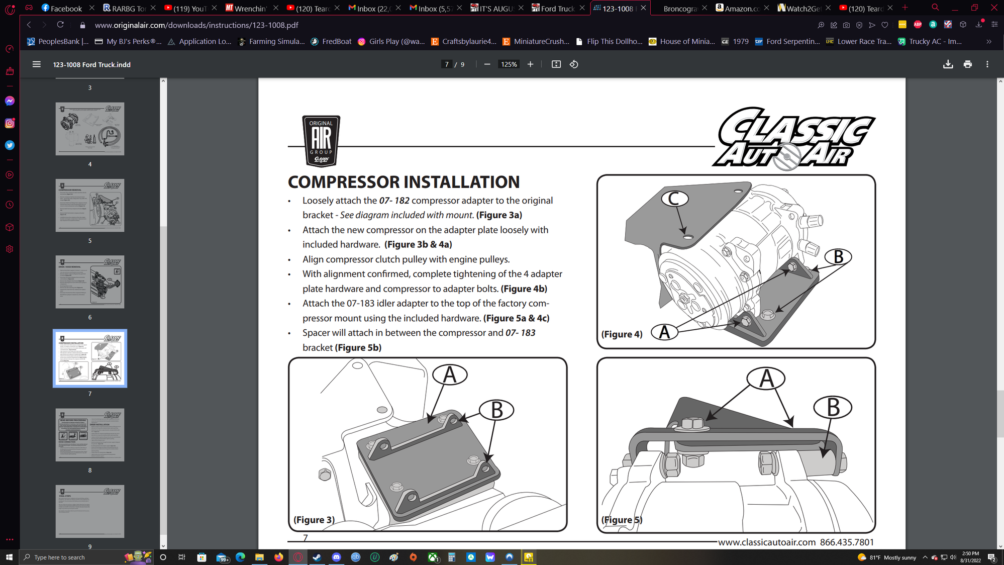

Originally Posted by CatskillCruiser
Yes main mounting bracket is missing
You will need to source one if you use the old air kit as it utilizes that bracket along with it's adapter. Also $750 isn't bad the systems i looked at were $1600+ just so i wouldn't have to deal with original wizardry...lol I may grab this kit myself as mine has AC but someone "borrowed" the bracket, compressor and all the hoses before i got it. I do have a brand new condenser and evaporator core so i can just replace everything at once.
So is this what I need new from Summit, if I can't find someone with an extra OEM:
