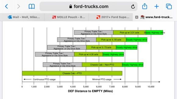

Not sure of the source of this chart.
if my 2019 f-450 with 4:30 axle is using 1 gallon every 2500 miles, then my miles to empty is off the chart.

right but this thread is for us blind folks that have def guages that always show full.
full and it takes a few gallons to top off .
concern is if the guage does not work correctly to indicate full, 3/4ths, half, 1/4, etc….why would it work correctly to warn of 500 count down to wrench or reduced power mode.

You make the statement "those of us blind folks" like it's common for this gauge to not move when the DEF is depleting. That is not normal and something on your truck needs to be fixed under warranty.
If you truly feel you have an issue then I would suggest you fill the tank to full because we know the capacity of the tank. We then know for sure how much DEF is in the tank. Drain all but one gallon from the tank and watch the gauge for a few days. If your gauge does not drop to the expected level or somewhat in the ballpark, (because we know these gauges are not truly accurate), for what you "know" is in the tank then time for a visit to the dealer for diagnosis.
