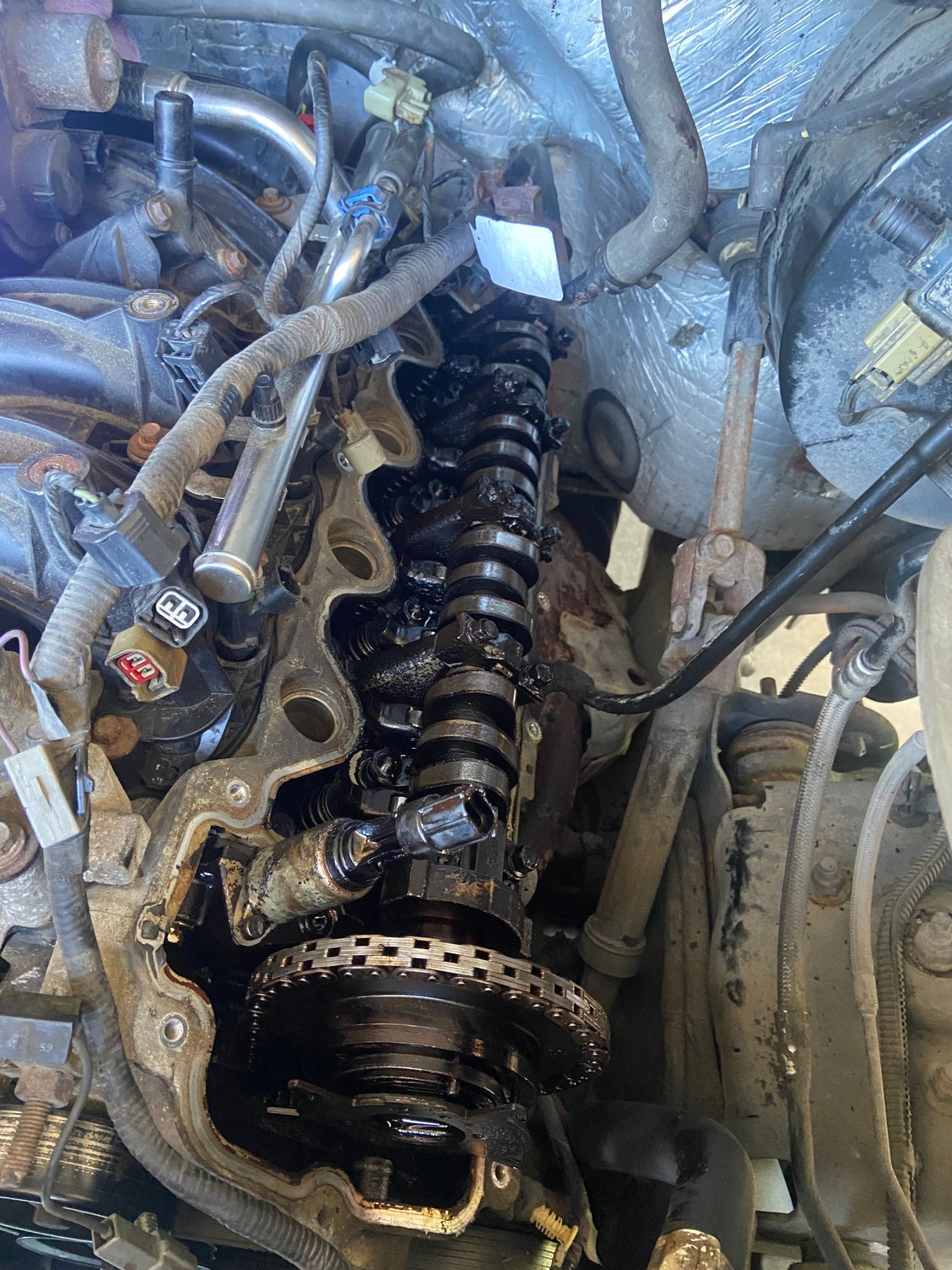

thanks for the reply, sorry for my delayed one. It’s the 5.4l. Just replaced the vvt solenoids and didn’t help. However when I hauled the valve covers off it look very dry and ALOT of crud. I’ll attach pictures.
I can’t recall when I started to hear this tick noise that is definitely coming from the valve components but I’m thinking it may have been noticed after I done an oil change, now it wasn’t synthetic oil and I believe it’s just the basic white oil filter. Can this contribute to the problem? I currently do have sea foam in the oil port to help clean it out before I drain the oil and replace that and the filter.
It’s weird, I start the truck and it’s the tick tick tick noise, press the gas and it idles smooth and quiet. Drive it and you can get the tick louder as you press the gas. Potentially needing the cam phasers done?

Rockers/followers are a huge problems on this engine. The roller gets play, eventually it will fall out or destroy the cam.
. There is even a TSB.
