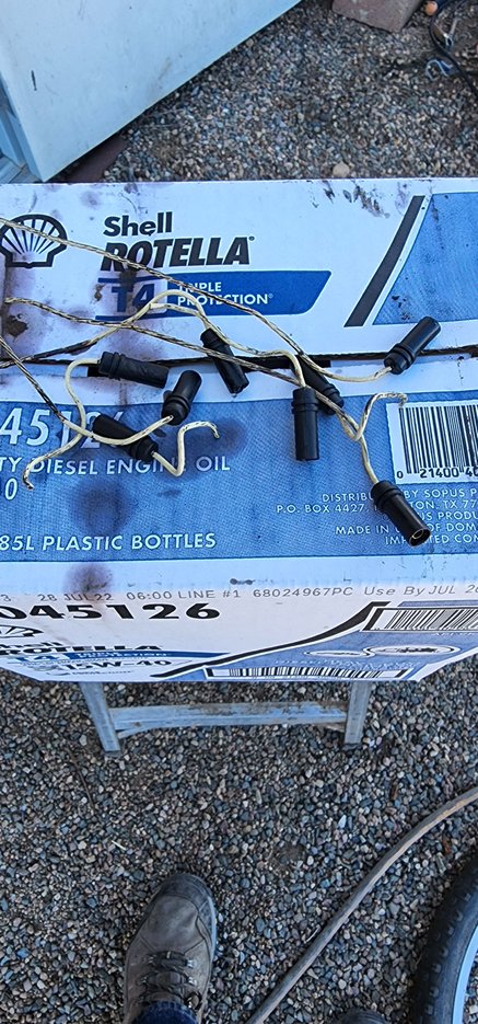

helifixer's Avatar
helifixer
Joined: Dec 2005
Posts: 10,250
Likes: 7,676
From: Chino Valley, Arizona
Originally Posted by sailorman524
While that's a grand idea, I'm still running a 91 old dog!
I see the wired up kits all over the place and I ordered a set of crimp connectors from Diesel Injection Parts, and while testing my ancient crimp toll I buggered a connector, so now I need to get a few more...
here is what I cut off of the powerstroke harnesses and solider on for the idi engines, each valve cover gasket has 2 short ones and 2 long ones.
