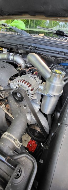

That's exactly the fluid I'm using now. The system itself seems solid its kinda hard to give you somewhat of a review when I still can't steer when stopped. Though while moving I can tell, its more responsive and seems a lot easier. Not to sure how old that tensioner is though I just removed the belt and it spins perfectly fine. As for the PN on the belt I can't tell seems like the numbering has completely faded away. Here's a pic of the setup I have,

No I retrofit a F53 pump on mine and made a reservoir out of one of those little 2.5# fire extinguishers. As for sealing at the cap, the primer bulb works pretty well but really anything that you can hold over the filler and run a hose through that seals will work. It doesn't have to hold for long, a minute at most. I suggest clear tubing also on case any liquids make it to the hose you can stop them before they get to the vacuum pump.
