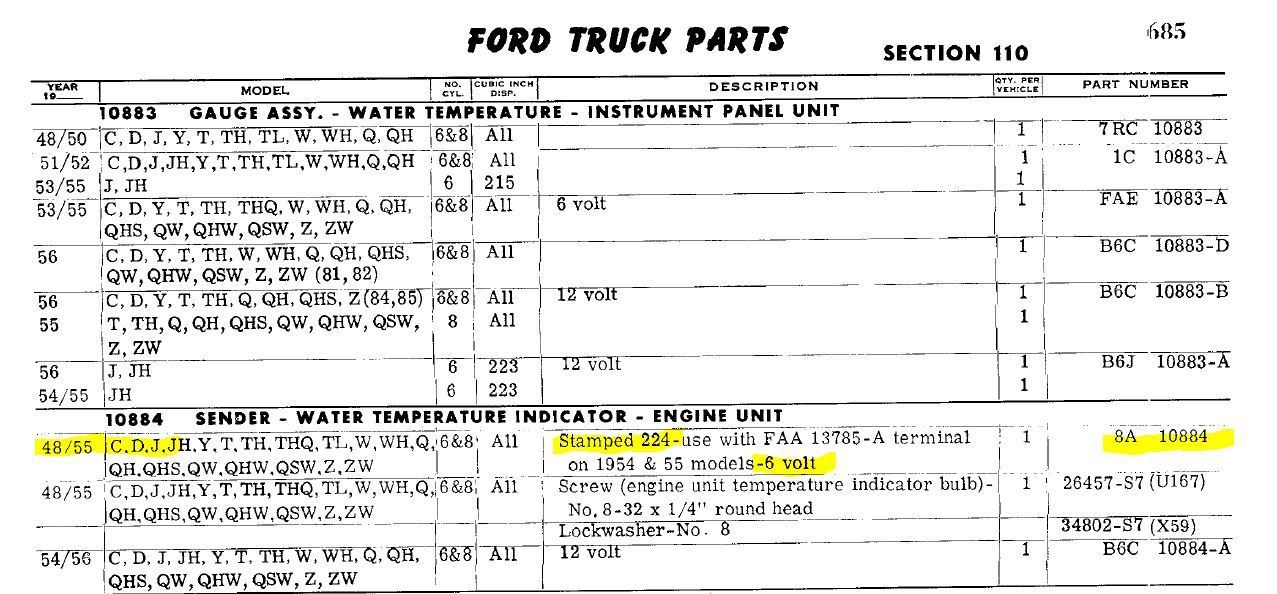

Your run of the mill parts chain will not have the 8A-10884 temp sender you need in stock or in their supply chain. You will need to get it from a specialized shop such as Dennis Carpenter, Mac's/Ecklers, Shoebox Central, C&G Ford etc etc....

They seem to be available from multiple sources for the same money.
https://cgfordparts.com/usa-made-tem...-8a-10884.html

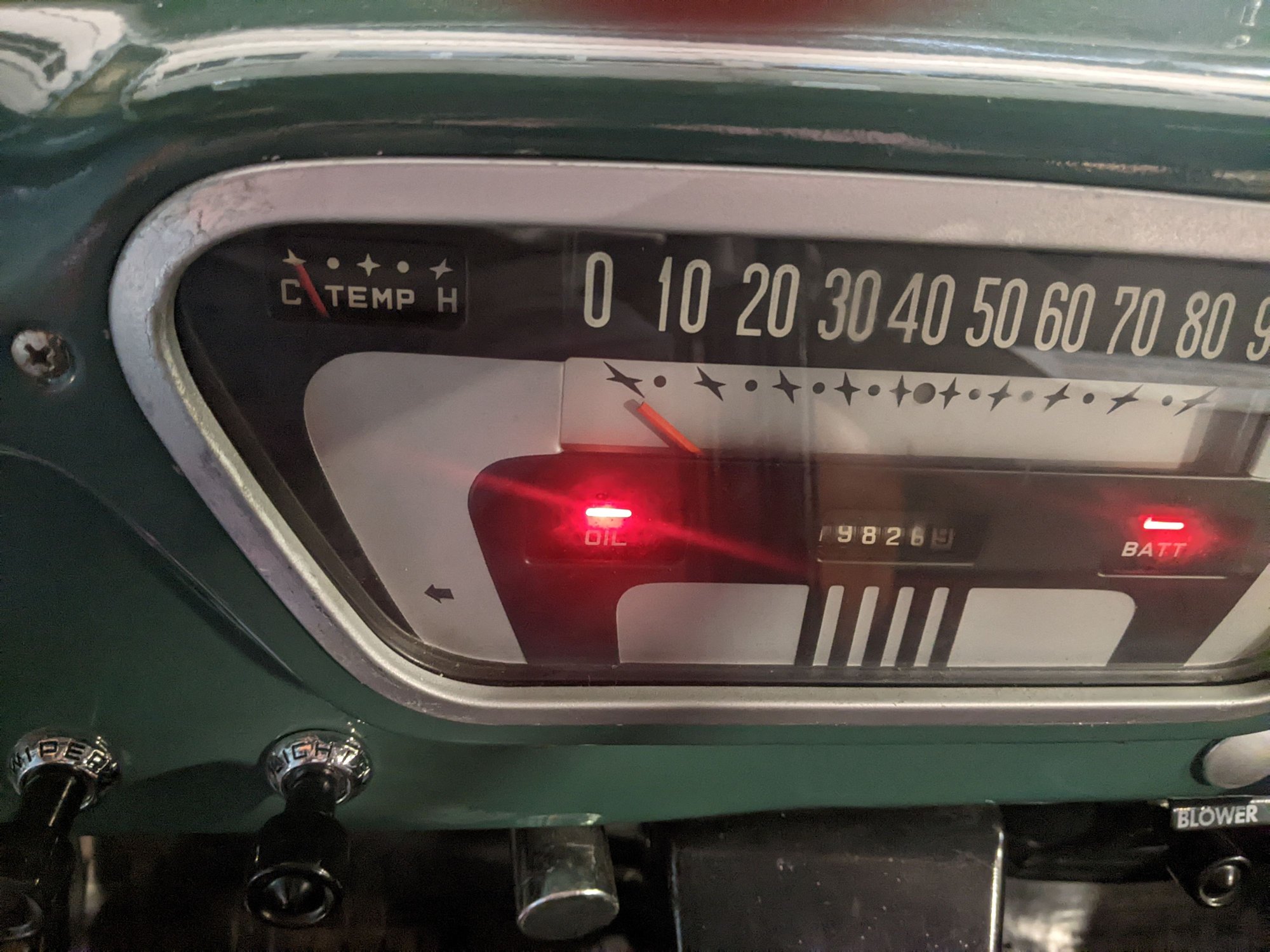

​​​​​​I ordered a temp sending unit from Mac's/Ecklers. It was supposed to have the double prong on it. It came with just a screw.
I had my son do the quick switcheroo because his fingers are more nimble and agile than my arthritic and numb fingers. He did it with very little loss of coolant.
I drilled out the double pronged contact from the old sender, drilled out the hole larger to accept the screw and put it on the new sender.
​​​​​​I turned on the key and the temperature gauge went the whole way to cold. Before it went between ¾ hot and full hot.

Originally Posted by 52 Merc
More importantly, does it read normal when the engine is up to temperature?
I took it for a short drive today. I didn't have much time so I didn't drive it hard or long. The needle barely went above the 1 quarter mark.
