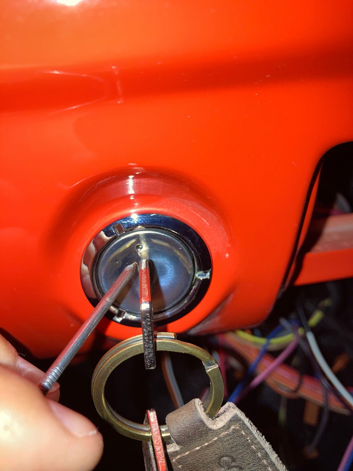

DON’T DRILL!!!
This is easy peasy. With a nail or pin, press and hold the little button above the key slot, turn all the way left past the ACC ON position. The tumbler will pop out.

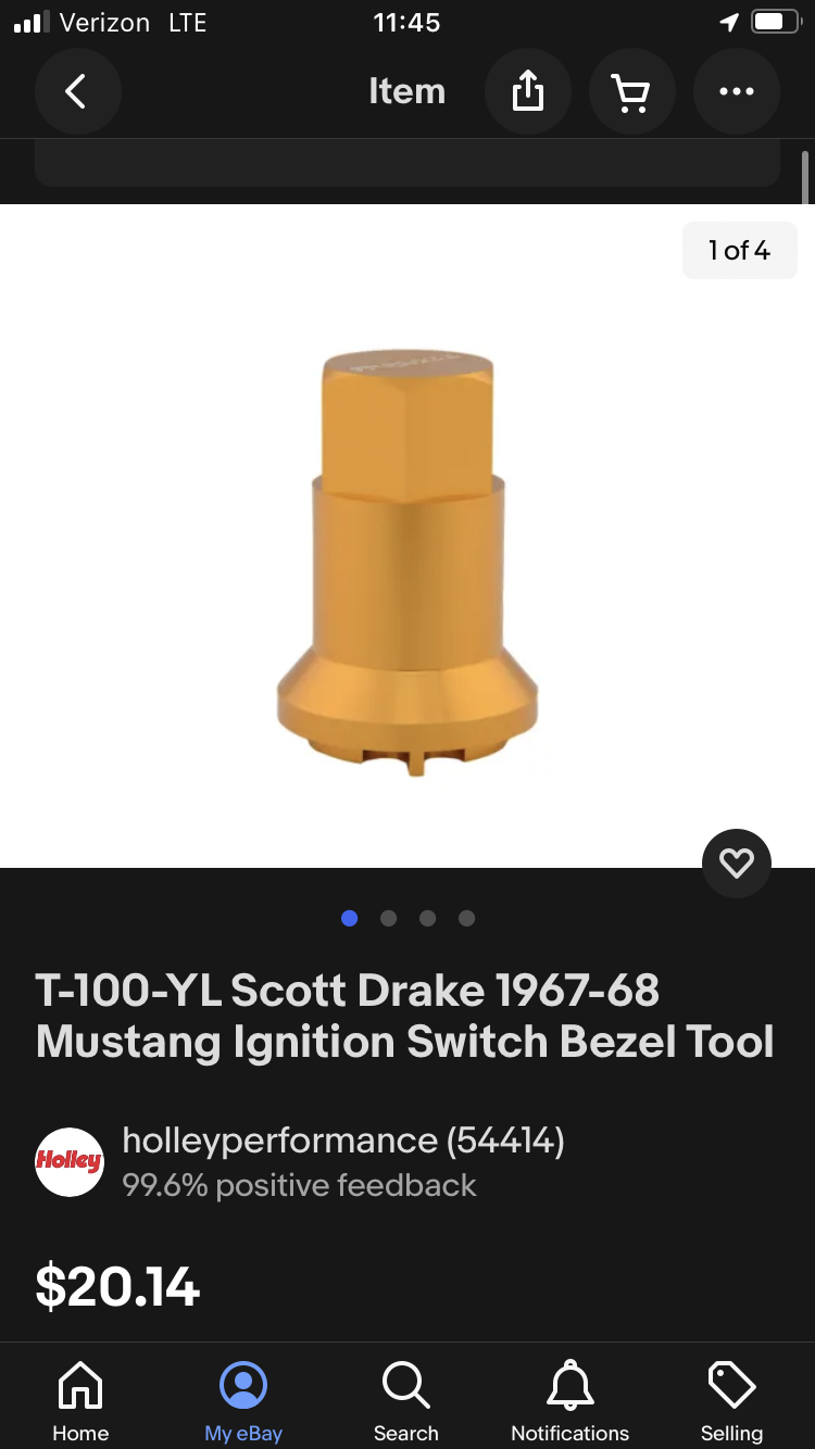

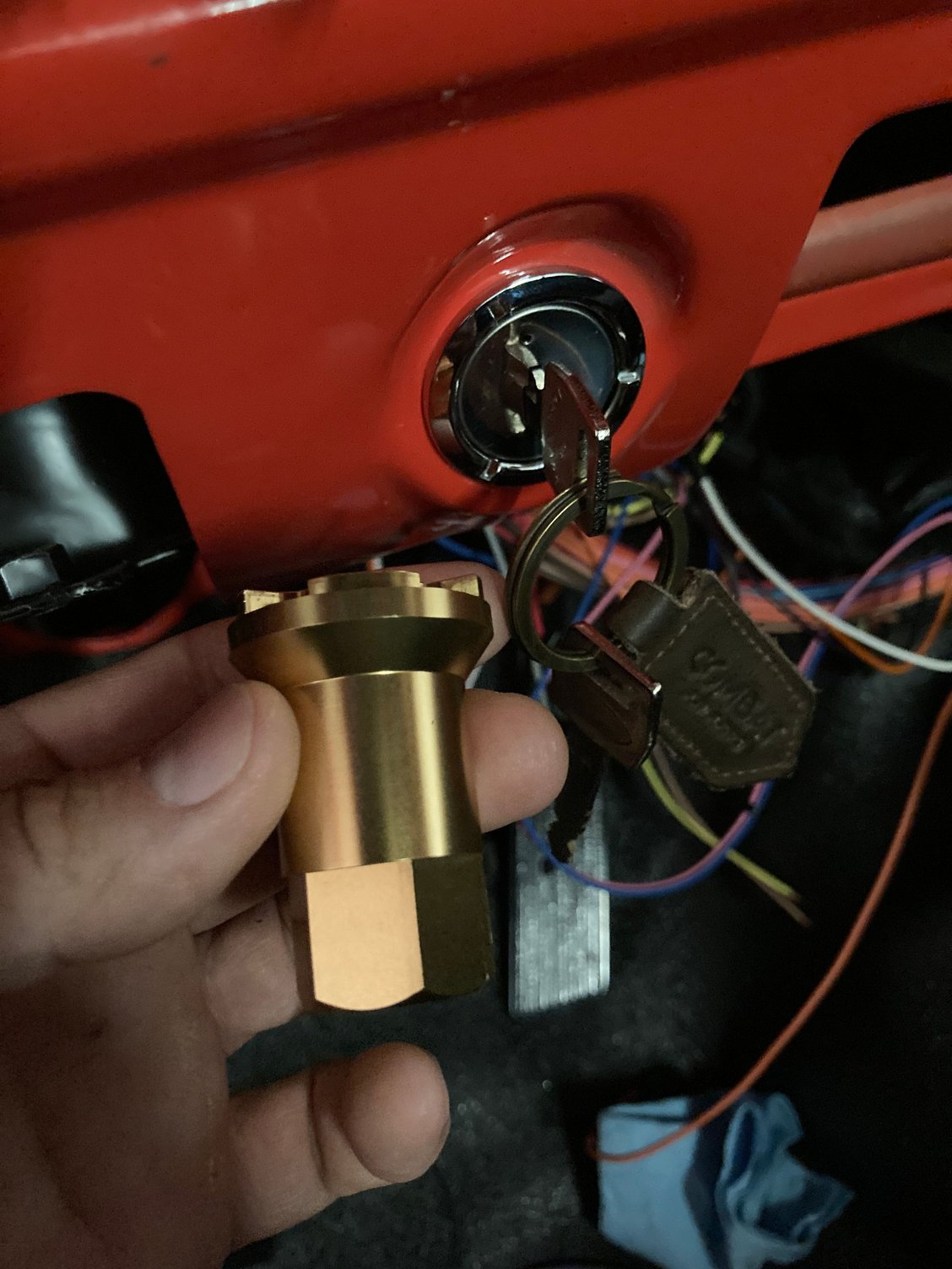

Here are a few fun ignition switch facts:
The switch and tumbler are available to be purchased. Dennis Carpenter is one good source. LMC another.
The bezel is also available if yours is chewed up. It’s the same part used on earlier mustangs.
the bezel can easily be removed with the right tool rather than jacking it up with a screw driver/hammer.

Nice tool, thanks for the link. Must get the 3 pin 67-68 Mustang one. https://www.cjponyparts.com/scott-dr...1968/p/HW1661/
NOT the 4 pin one for the 69.
that’s the one. Might save a buck or two on shipping via eBay. Definitely beats messing up your truck by beating on it.

Never had to "beat" on it to get the bezel loose, just a light tap tap. But still the proper tool is better.
