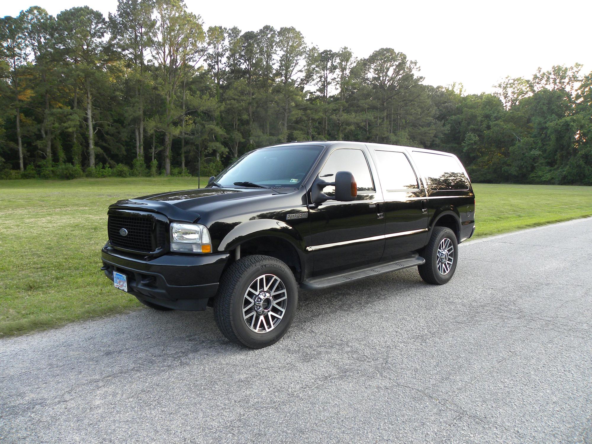

I sold my 2001 Black with 2019 Tires and rims, 7.3 Diesel, 4WD, 85,000 miles, No rust, southern CA Truck, XLT for $37,000 on bringatrailer.com. It had Ziebart sprayed against rust underneath and had Bullet Liner Material put on the top for protection after removing the rack.
