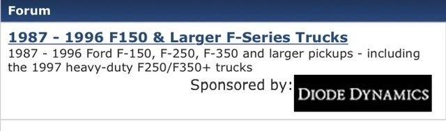

Oops! Not sure how I double posted but since I did, it’s right there in the forum title.
