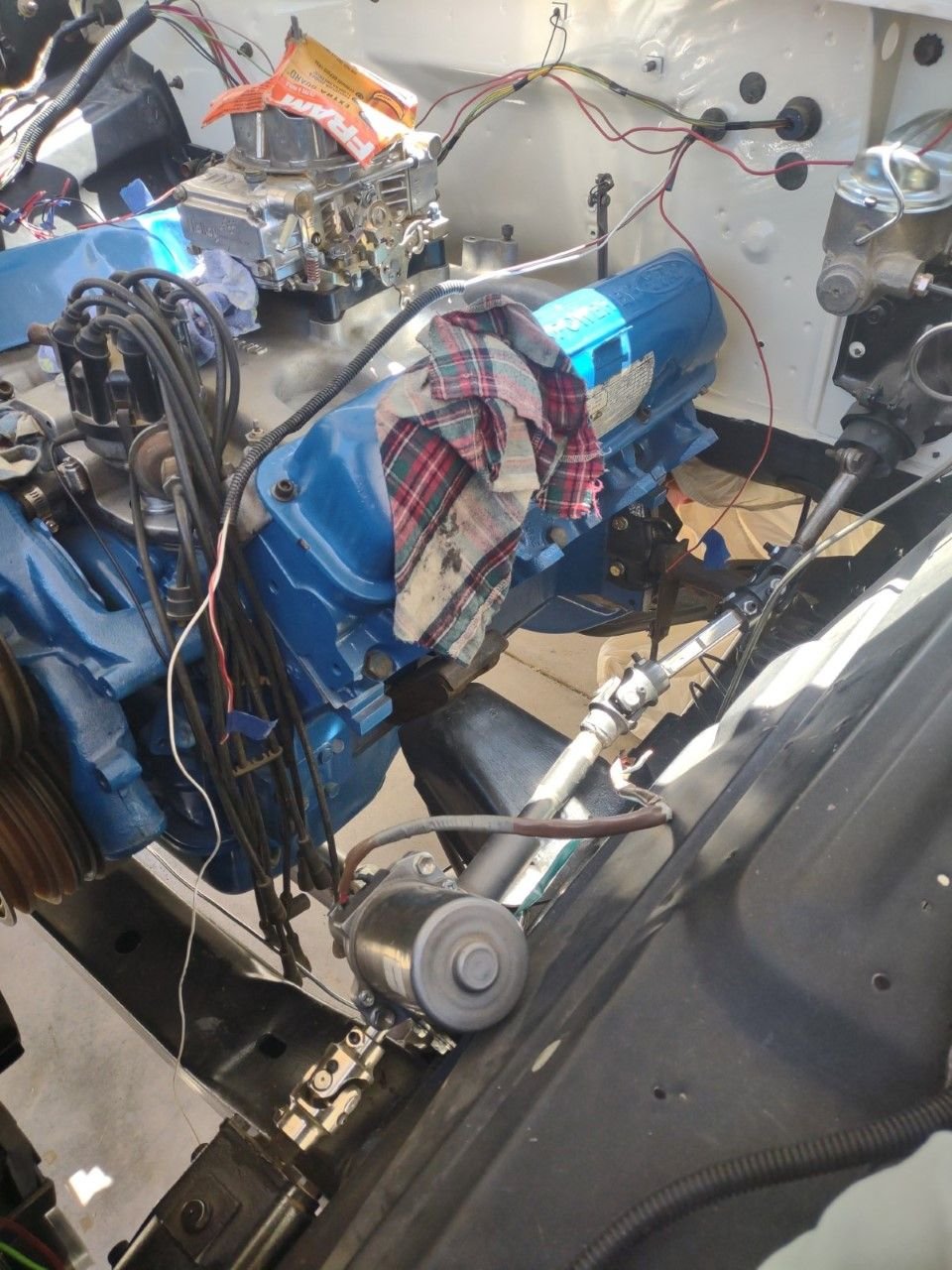

I ended up putting an EPAS in my 72 f250 4x4. I cant say how great it is yet because I have to run the power to it still. Everything else is wired up. Just need to finish it and test it. Instead of going with steerman cycle or another kit, I found mine in the JY. I do like not having the pump/reservoir, hoses and belt in the engine compartment. Here is an unfinished pic.
You would definitely need to upgrade you charging system though if you havent already.

Can you elaborate (or point to a thread) on how you did this? What was the donor vehicle? How did you adapt the steering shaft? This seems like a cool option and potentially cheaper than the Benchworks kit.

1Browski, I've been following your build, watching and waiting to see how your esteering works. It sure does look good.

Not to hijack the thread, I will say that there is no build thread that I have ever found. There is another member that has done this swap and I cant think of the name off hand. I ended up looking at pics of kits installed and made it myself. I will PM some info and I will do a build on how I set it up soon.
