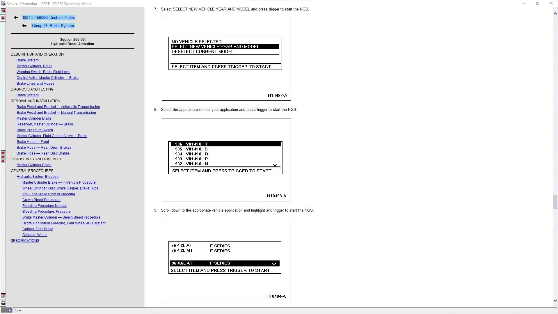

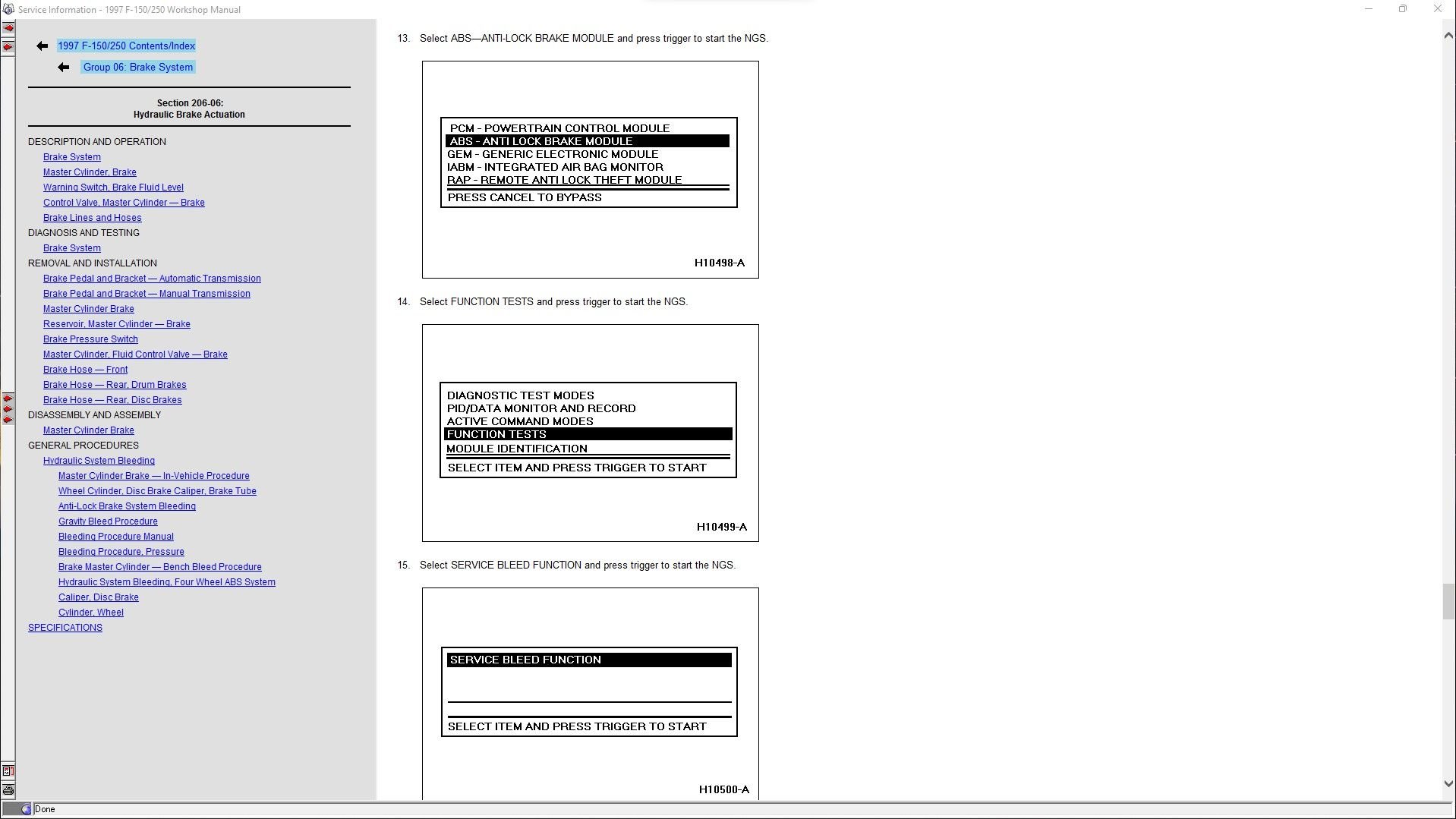

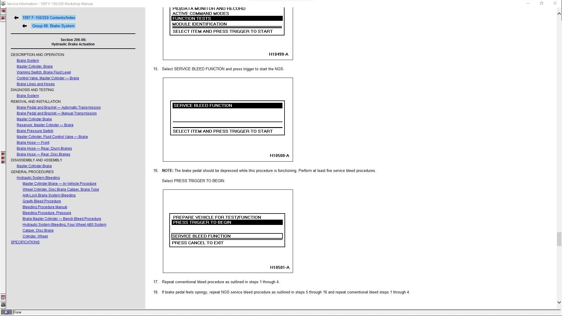

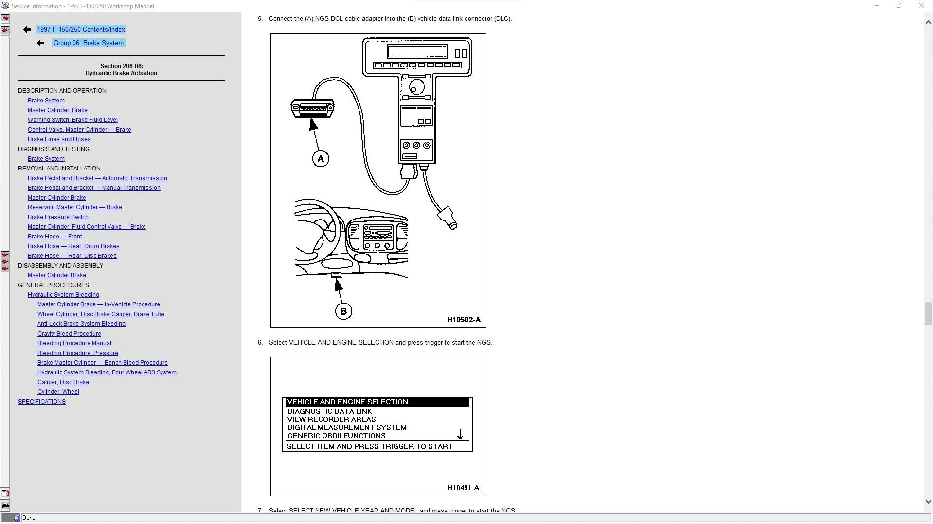

You'll notice top left corner of pics what manual I'm getting this info from. It's a dealer supplied Ford service dvd. I was a dealer line tech 93-2004 and have performed said procedure many many times on trucks back then with 4wabs using a Ford scan tool you may not be familiar with, it's called NGS. It is post super star II tester, pre WDS. IDS handles all these functions now. I have my own NGS and IDS.
I skipped posting steps 1-4 as it's just a description of a normal system bleed.
This is what the NGS looks like, well it's what mine looks like anyway. The one I used at the dealer was much cleaner and didn't have the rubber boot around it.

Every piece of hwdr you see in that pic came straight from Rotunda, don't know where you get aftermarket from. Those were some of the dealer supplied special tools Ford required dealers to use.
Perhaps your dealer, if you actually worked at one, didn't maintain training like mine did or perhaps it's before your time, don't know don't care.
The NGS was used back when that's all Ford had to give us, mine is updated to 2010, that's where Ford drops support for it as we had been using it's replacement WDS since 1999 IIRC, which is why I also own IDS as it is the successor of WDS.
This is what mine looks like...

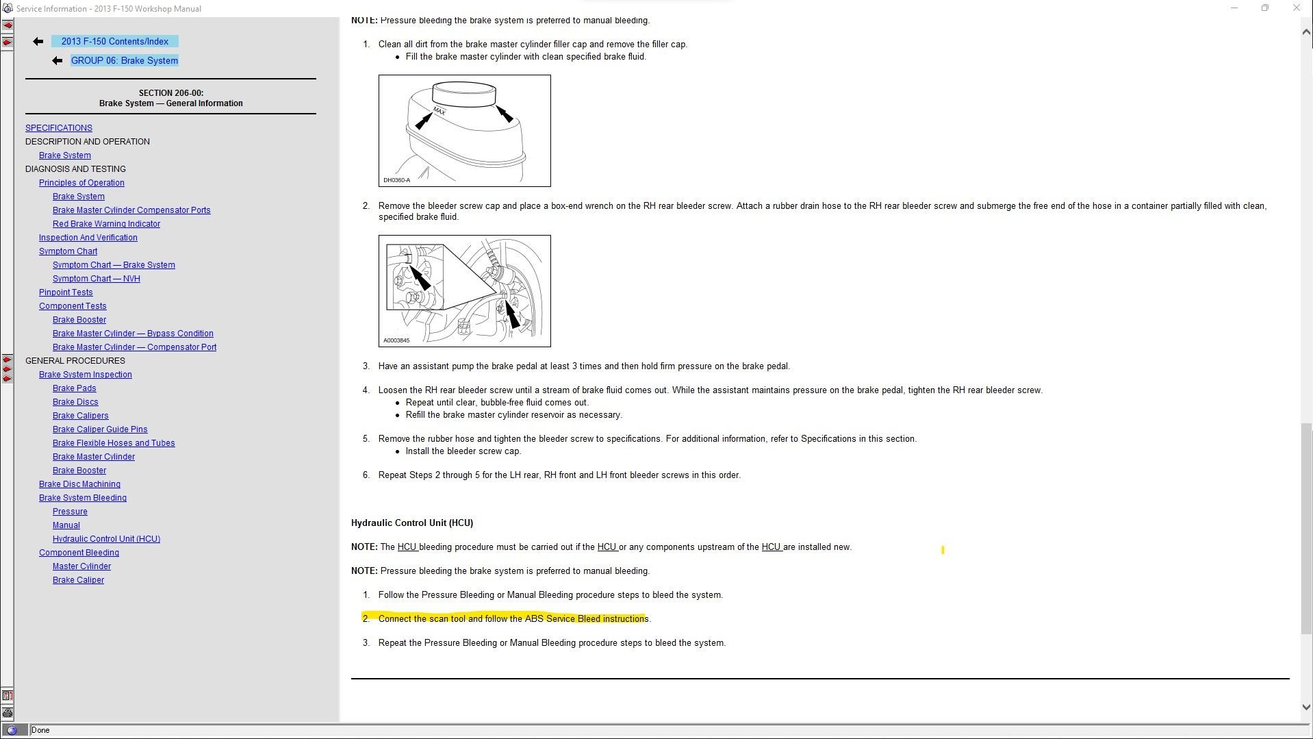

Since NGS won't interface with anything newer than 2010 I can't access my 2013 truck with it to show you where the service bleed function is but the ABS service bleed function is included in IDS as well. Since IDS has all instructions on screen the only mention of the service bleed in the 2013 shop manual simply states,... well here see for yourself. Highlighted for ease of discovery.
Above pic is the ABS service bleed function for my 2013 and likely still in use to this day, matter of fact even FORscan has the service bleed function.
If I ask questions in this or any other forum it's because I don't know everything or have the answers to everything, are you saying you do? That's some arrogant thinking right there.
The pics were to show you exactly where the procedure is located in FORD literature that you obviously had no clue about. It was an effort to show what I stated was 100% accurate. I get it, your feelings are hurt because I proved you wrong, that was not my intention however you challenged my knowledge so proof had to be posted, get over it and become a more productive member of this online community or go back to school and stay awake for ALL of the classes, then come back and claim your master tech status.
