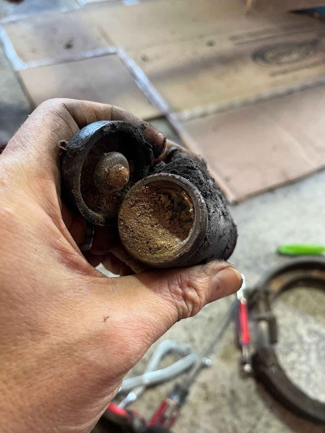

Rear brakes update
Hello all,
Started tearing into the rear brakes this afternoon (after staining my deck - had to finish a "honey-do" item before I could get to the truck, lol).
Might be a Midwest phenomenon, but both sides had huge mud wasp nests in them that were super stuck to the side of shoes. Also, both wheel cylinders were toast, the back passenger had a busted rubber seal. Here's some pics on where I got:
After clean up
Before clean up
Packed wheel cylinder

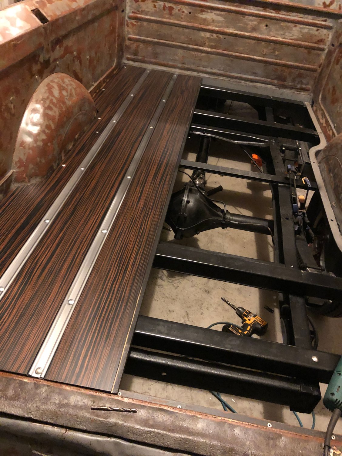

Thanks Anthony, and yes, agree. I got them out of my van after picking them up (they were covered with typical oil from being cut) and I put them in the bed in the approximate location they would go.
While I have you, I am planning on bolting them to the frame versus weld - you don't see any issues with that do you?
Thanks,
Wes
i welded some steel beams with notches on the ends identical to the oem wood beams

Solid Cherry Bed Boards Started
Update from today - Made progress at brother-in-laws woodworking shop making the bed boards. Next week we will be finished making them, then will stain and varnish. Pics are below, here's the stats and rundown on how it went:
Picked out 10 boards, ranging from 8.5" to 10" wide and between 9' and 11' long. All boards were 6/4 (roughly 1.5" thick). This wood is from my timber area when we had the derecho in Iowa a couple of years ago.
One of the boards fell out even before we started planing because it was cracked to far into the middle and would have been too short.
Once we planed all the boards, the 9th one fell out for a similar issue - crack that we thought was surface, turned out to go too deep into the wood.
Got all the boards planed down to 1 1/8" today and cut to 7" width. Plan next week is to get them all cut to length and final width and planed to about 7/8" thick. Then we will use a router to route the long edges to allow for the strips to sit correctly. After that, I'll stain a traditional cherry color and varnish entire board (front, back, sides, ends) with marine grade varnish.
Final boards, ready for more planing.
Boards down to 1 1/8" thickness and 7" wide
