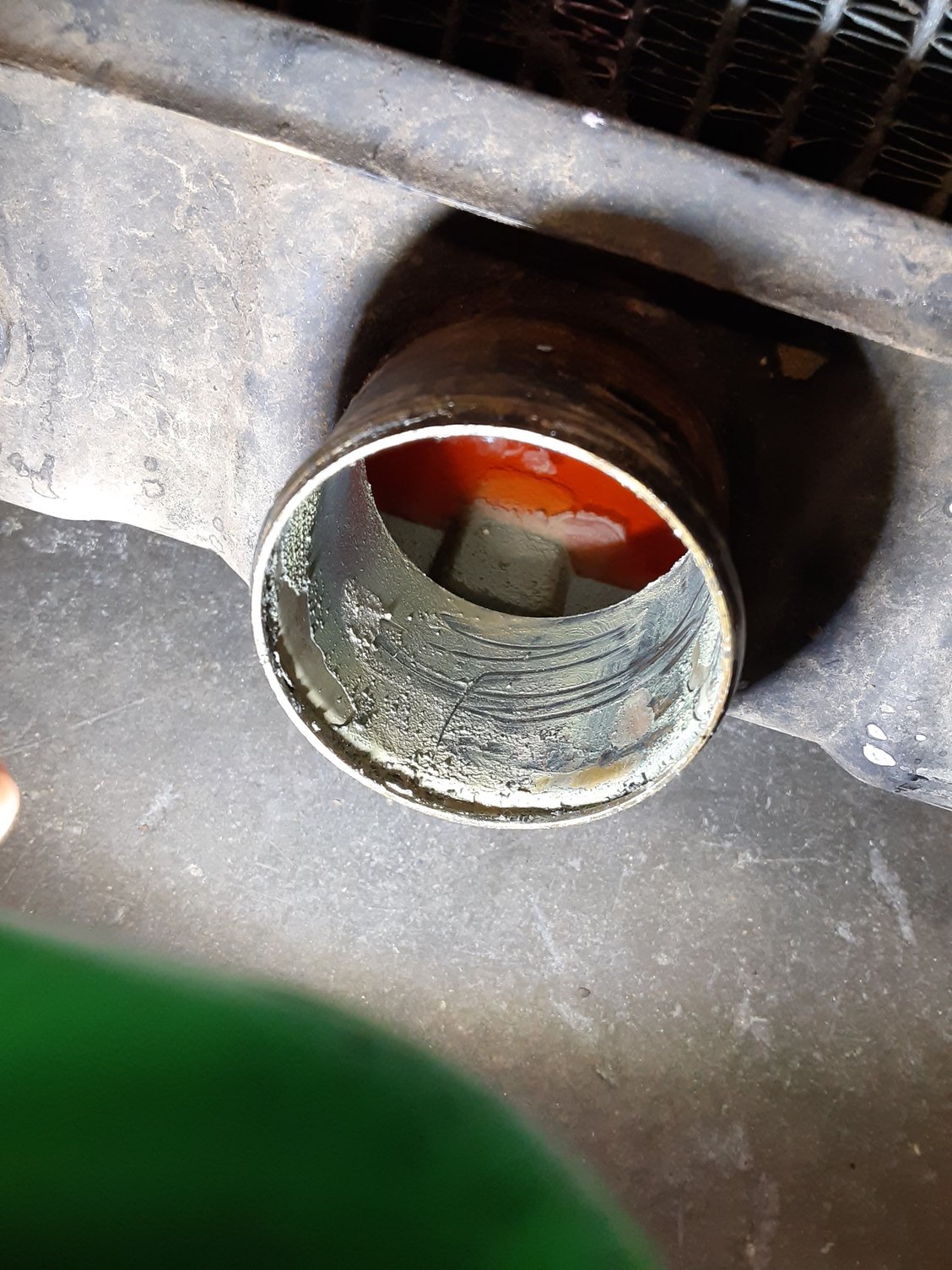

Here is a pic of the stuff I'm talking about
Lower radiator hose port

almost looks like someone filled it up with leak stopper.

That's kinda what I'm thinking too, ive never used a leak stopper so I have no clue what it looks like in the system, I guess I'll just put a coolant filter on it and see how it goes

That appears to be silicate fallout from traditional green coolant that is way too old. Almost completely inert chemically, but it can clog up the overflow hose if there's enough of it. A good flush or 3 will get it out. On another note, is your old radiator by any chance the "w/o A/C" version? If so please send me a PM about selling it.

I originally thought that's what it was but everyone I talk too kept telling me it was a stop leak sealer, I took the radiator in to have it inspected and cleaned out and they also confirmed that it is a mixture of silicate dropout and corrosion, it is an A/C radiator and I was going to keep it, sorry, thank you for the reply.
