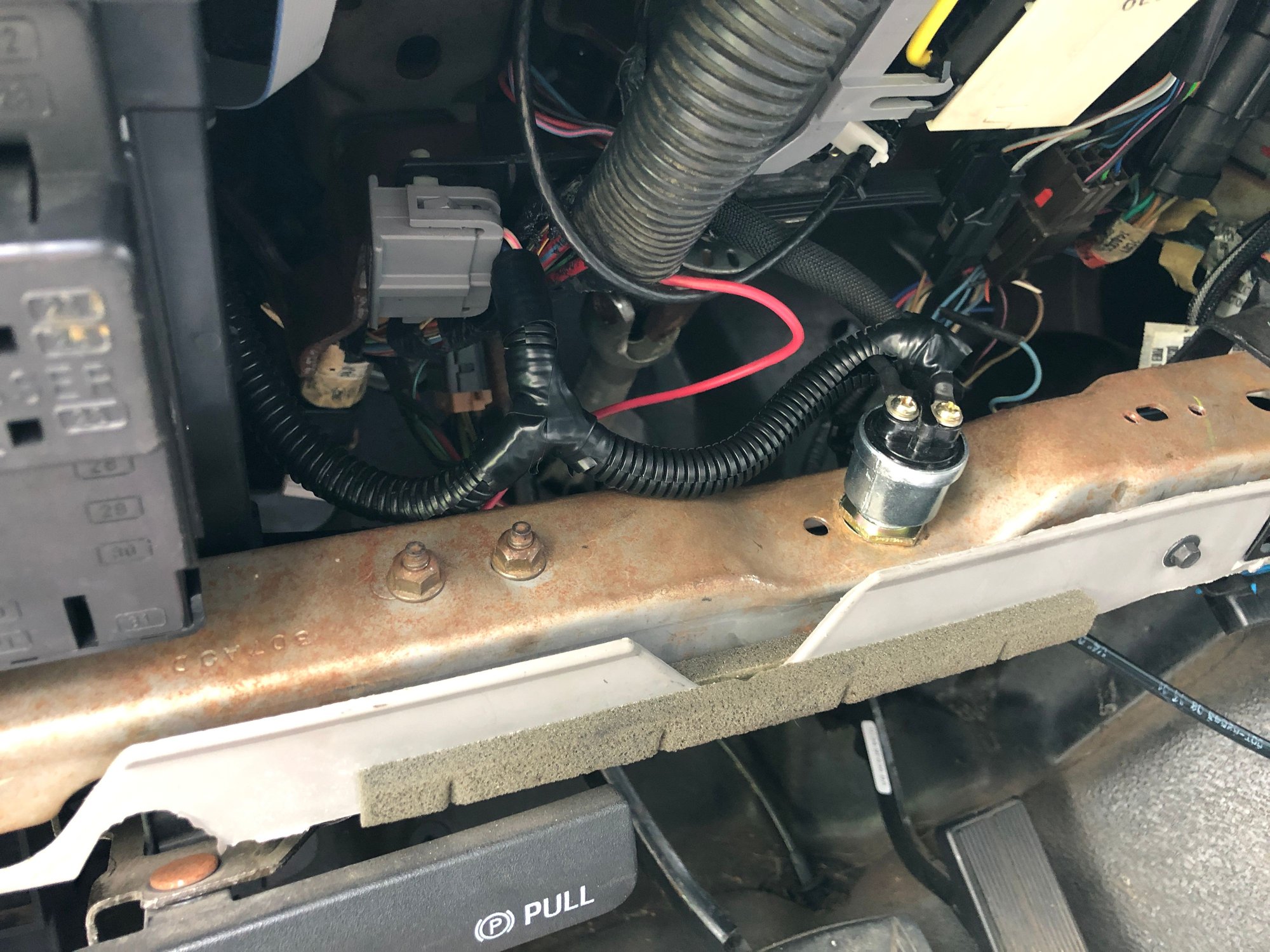

Check on the driver side wheel well, there's a small black box where power goes to the cab, sometimes they get corroded and don't allow power.
I have power in the cab everything works in accessory mode, I’ll still check, what exactly in that picture am I looking for? This is a 2002 I believe, it doesn’t have a starter solenoid on the fender well like the older 7.3DI’s
