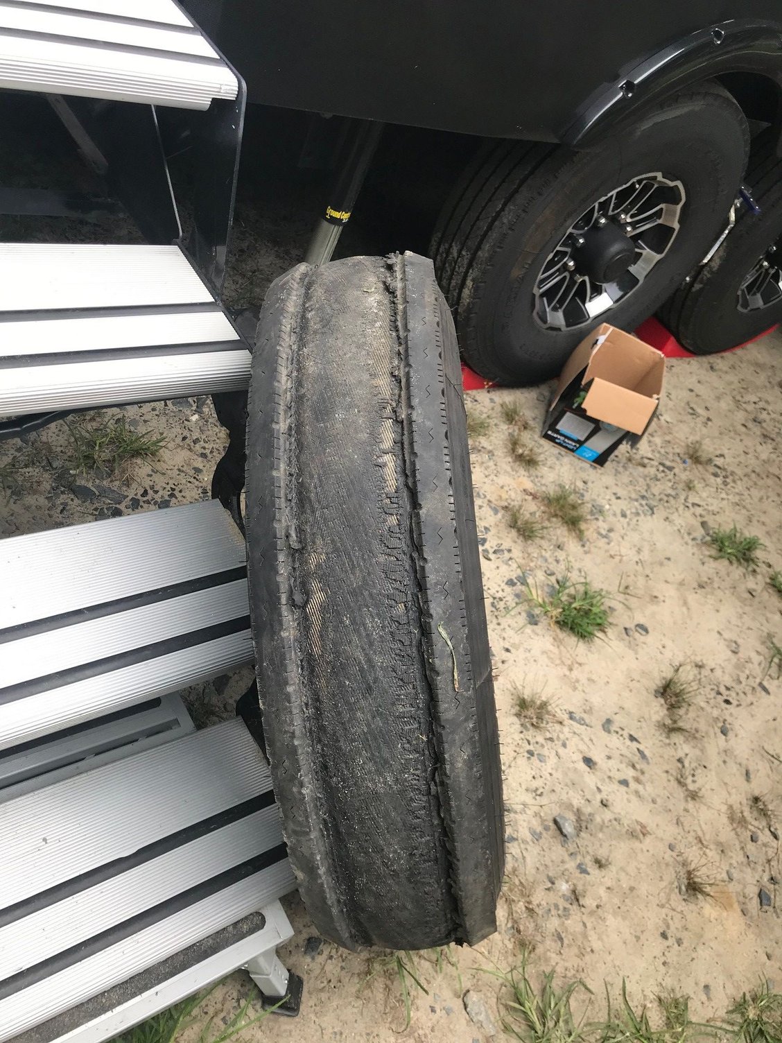

Left for a weeks vacation to Lewes De from Pa. Its about a 2 1/2 hour drive. We had less then 50 mi to go but the drivers side fwd tire decided it no longer needed its tread to complete the journey. The tire never went flat or lost air pressure (still rocking 110 psi). This was the 2nd trip with the new Sailun. Getting good at tire changes

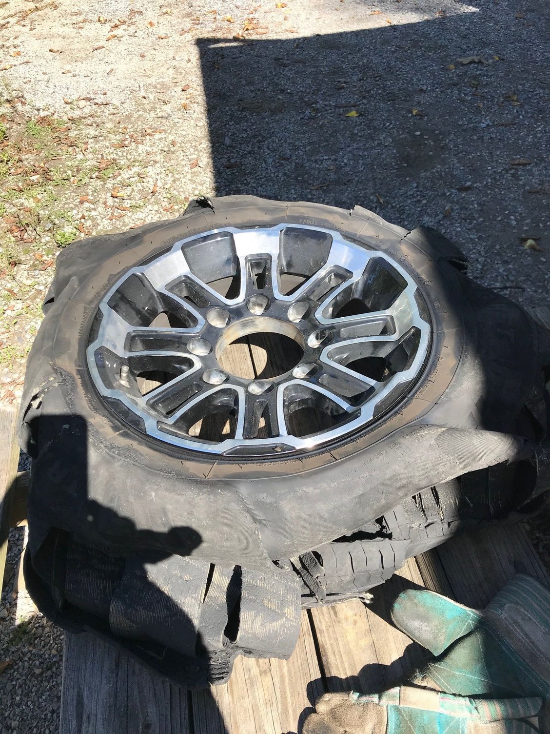

At the end of of last year I replaced all four with new Sailun's ($$$) because I had an original tire come apart traveling back from Tenn on I-81N. The Sailun that lost the tread was a new replacement tire I had got a month ago because I ran over a nail and it could not be repaired because it was to close to the sidewall. The replacement tire had about 200 mi before the tread came apart. Have a new Sailun tire installed with a May 2022 date code. Taking bets on how long that one will last Smile
This is the tire that blew on I-81

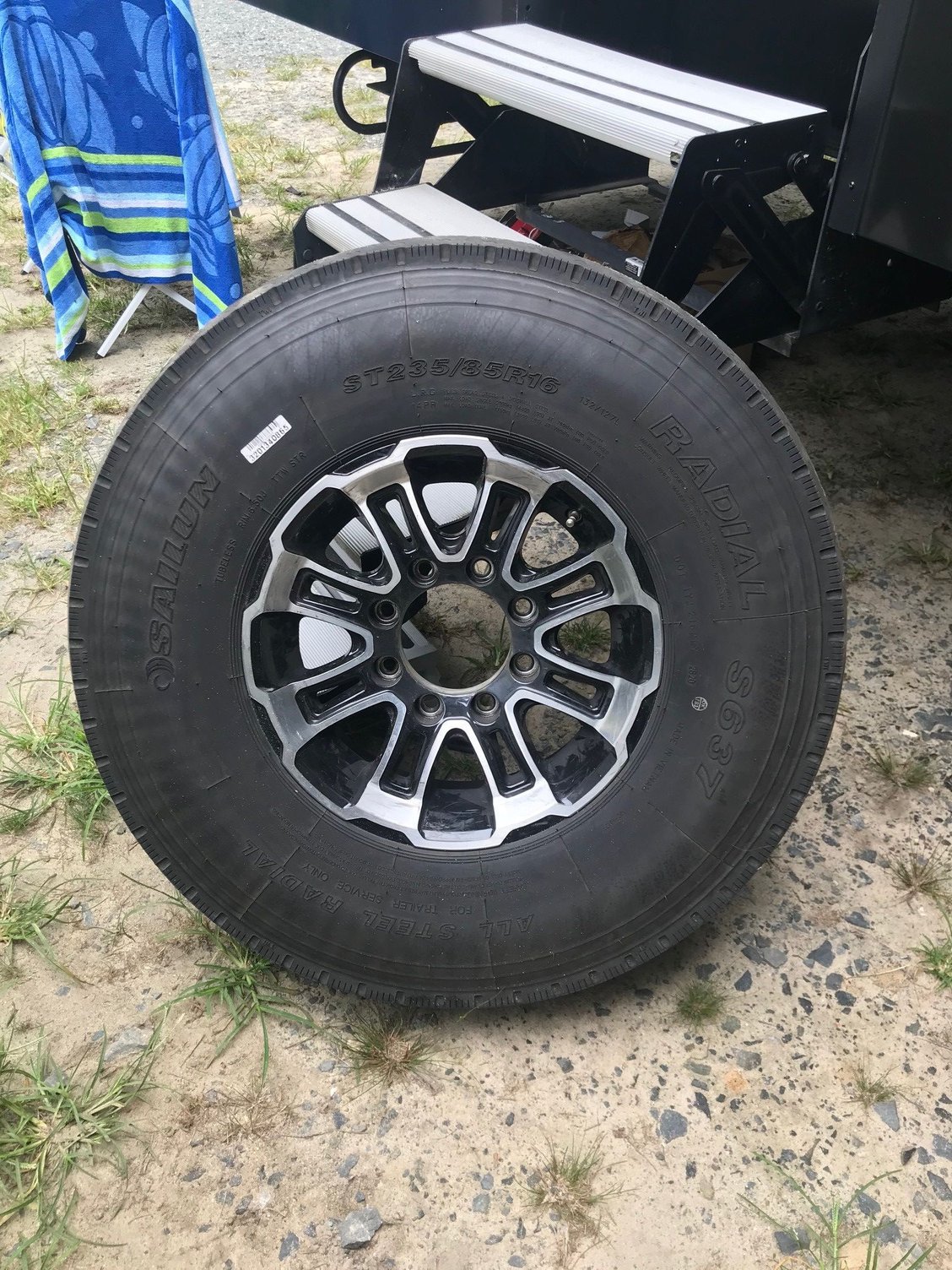

they are a 14 ply tire whereas my 17.5s are 16 ply G rated. 135 load index. Same G rating but they can handle 400lbs more. I'm at almost 20k miles on my coopers on a 17k lb 5th wheel and they still have the same air pressure from when I bought em.
I could zoom in on his OP's pic and see his ARE a part of the recall. DOT 1YJ and Date 2820
