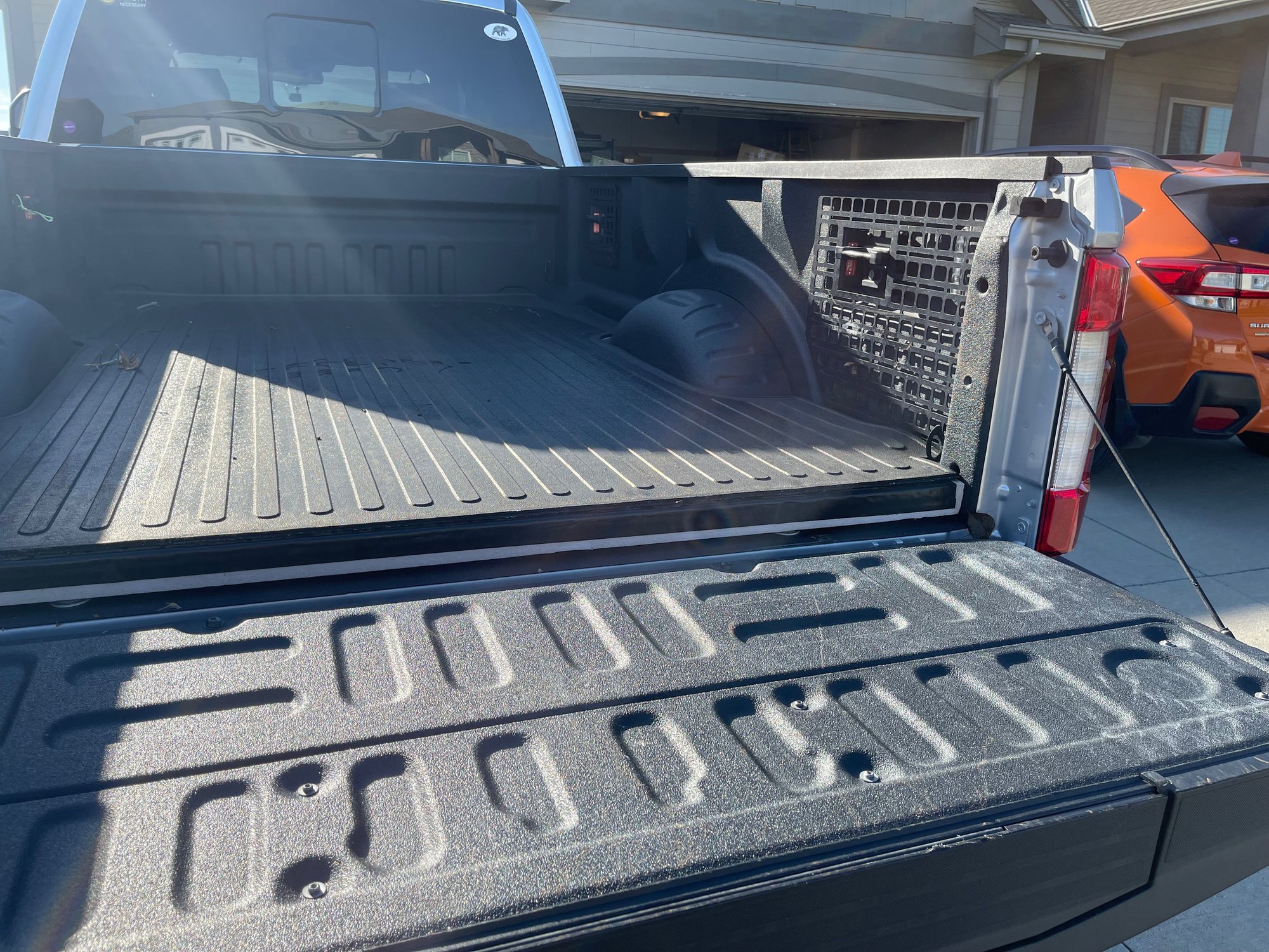

Rubber Bed Mat
What brand bed mat will fit a '22 SD CCSB with full width rubber to the wheel wells?? Any suggestions or experiences?
My camper is 48" and the distance between wheel wells is 49" ish. Am using a used one I had that just isn't wide enough.

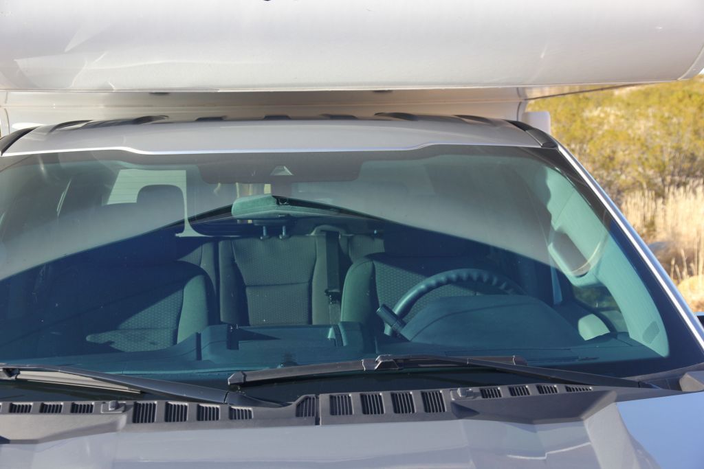

Thanks for the replies, I ordered a new DeeZee mat from Amazon and hope it fits well.
I built a riser with 2x2s in the grooves in the truck bed to the weight is on top of the box frame cross pieces on top of the truck frame and plywood on top of that, probably overkill but... I have 2 1/2" for a riser with the mat and fits well.
The used/cheapo yard sale bed mat I had was the same 48" wheel well width as the camper so the camper had to be centered perfectly, not sure what it fits.

That clearance looks good - my 2019 has the "Shark Fin" antenna for the cell and sat radio so I have to go slightly higher with the bed 'lift' (foamular) in addition to the Northern Lite sitting lower, etc.

That clearance looks good.

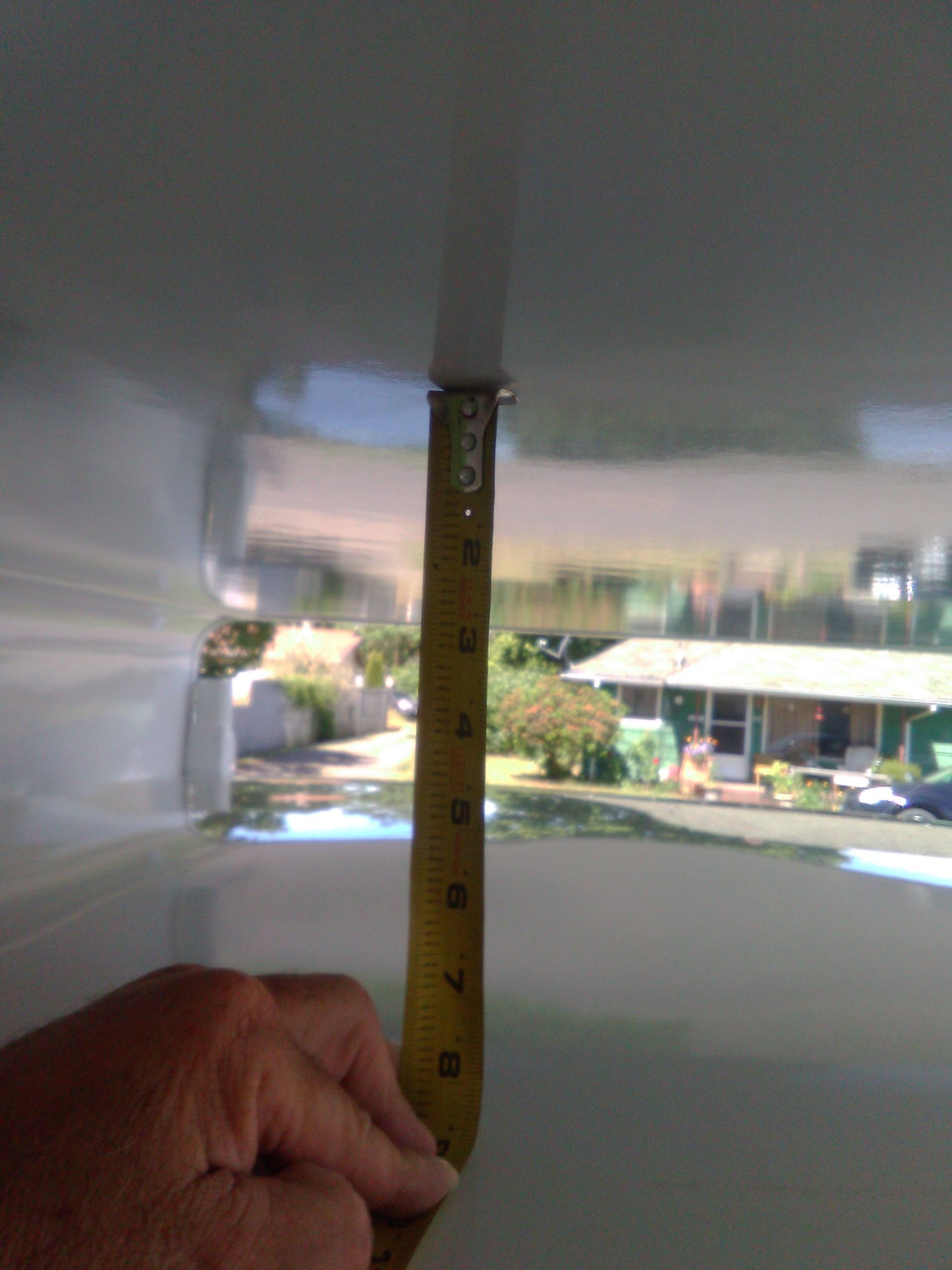

With my 2020 Lance, on the 11 F350 I have nearly 6" of clearance, 5 over the clearance lights, which I think is too much. The only thing in the bed for the camper to sit on is the 2/8ths DeeZee mat.
As far as Lance Campers go, It is my understanding that Lance increased basement size with the 2017 or 2018 year models for several reasons including clearances over the cab of the new (2017 plus) Ford Pickups.
On my 96, the clearance over Cab is over 8", but I do have to have the 3/4 inch piece of plywood with the goose neck carve out to keep the bottom of the camper from getting a whole punched in it. This pickup does not normally get used for this camper.
