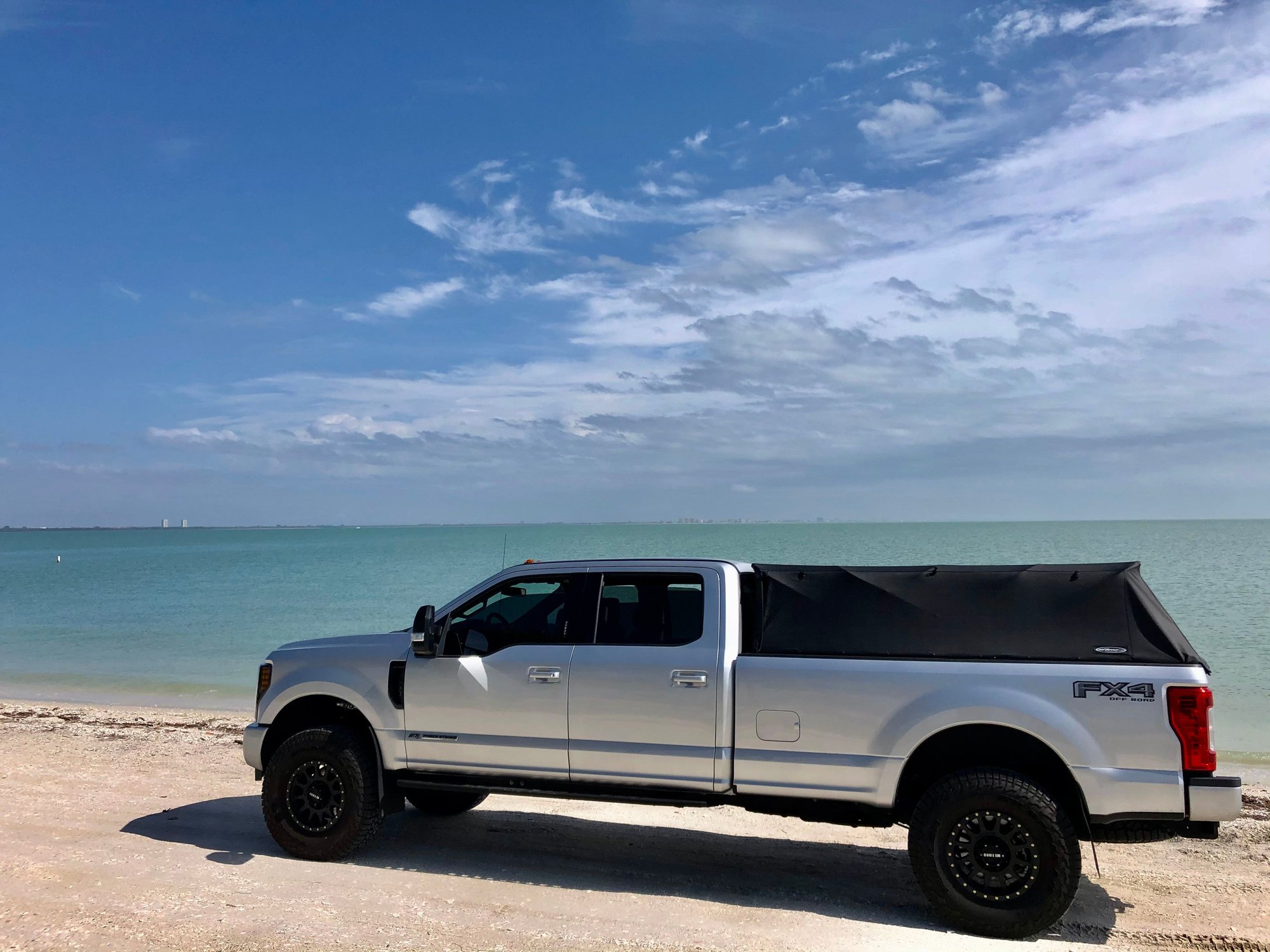

Not 35's but I've got 37's on my long bed. Looks awesome (in my opinion).
I agree on the awesome. Any lift or other accommodations needed?
No lift needed. There is some slight rubbing at full lock (past 38* of turning, these trucks max out at 40* each way), but the rubbing is on the sway bar and radius arms, so you're not going to damage anything with a little rubbing here and there. And at 38* you're not going to be driving faster than a few mph.
Agreed. How much offset on the rims?
Offset is +18. I wanted as little "poking out" as possible but as little rubbing as possible too, and around +18 seems to be the sweet spot.
that does look good! Did you have to level the truck?
No level and I do not have the plow or heavy duty springs package either.

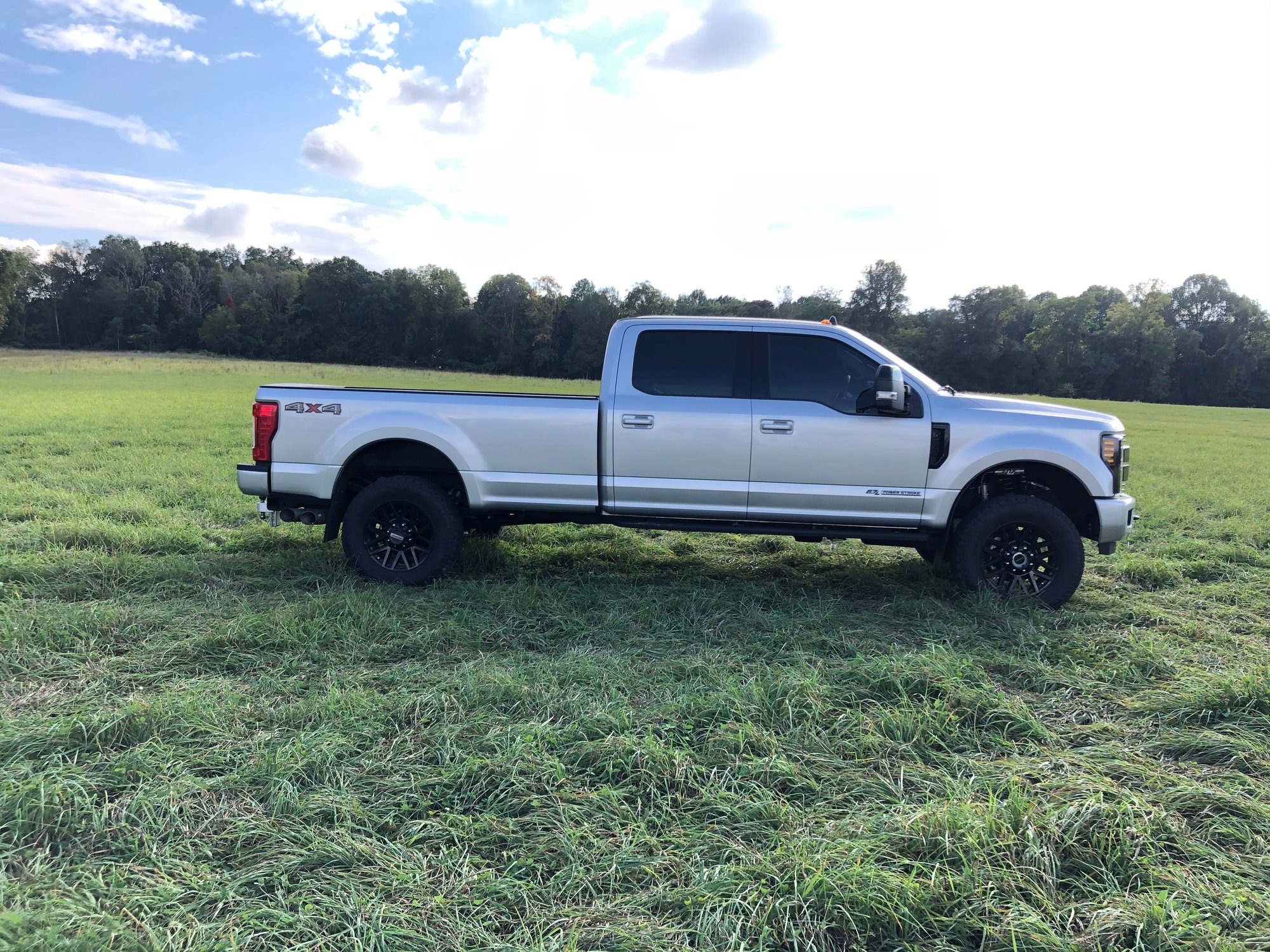

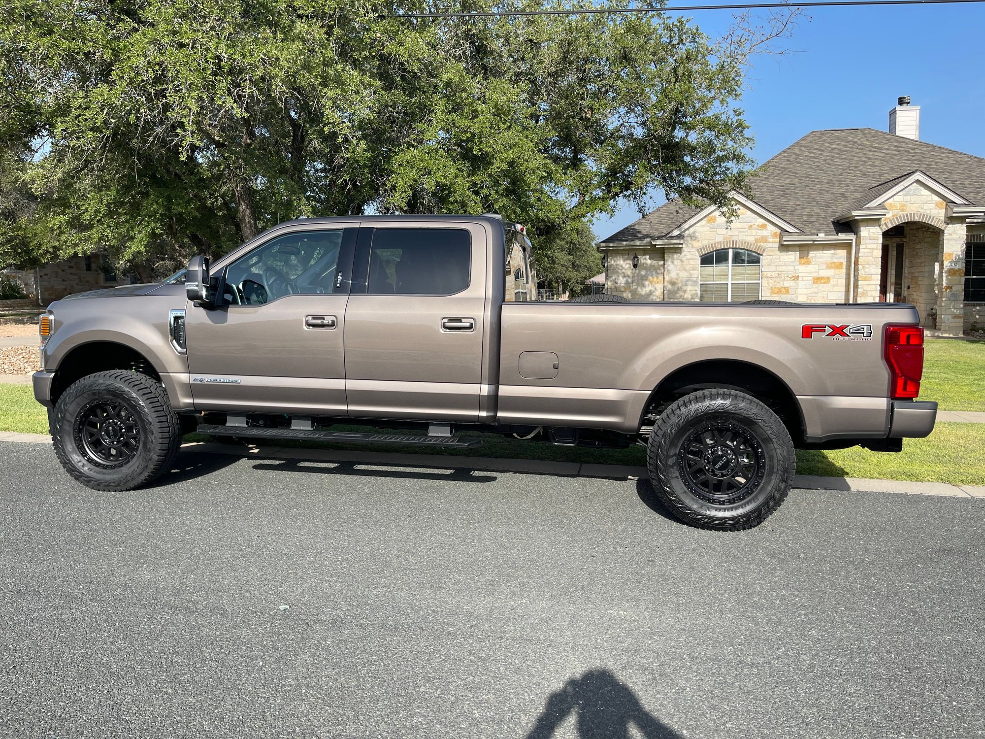

I just bought a 2022 f-350 long bed. I’m wanting to put at least 35s on it. Will I have to level / lift it for 35s to fit? Also, anyone have pictures of your long bed with 35s?
Not sure what cab configuration you have but in my opinion a crew cab long bed needs 37's to look proportional to the size of the truck.
295's on stock 20's in this picture
37's in this pic
