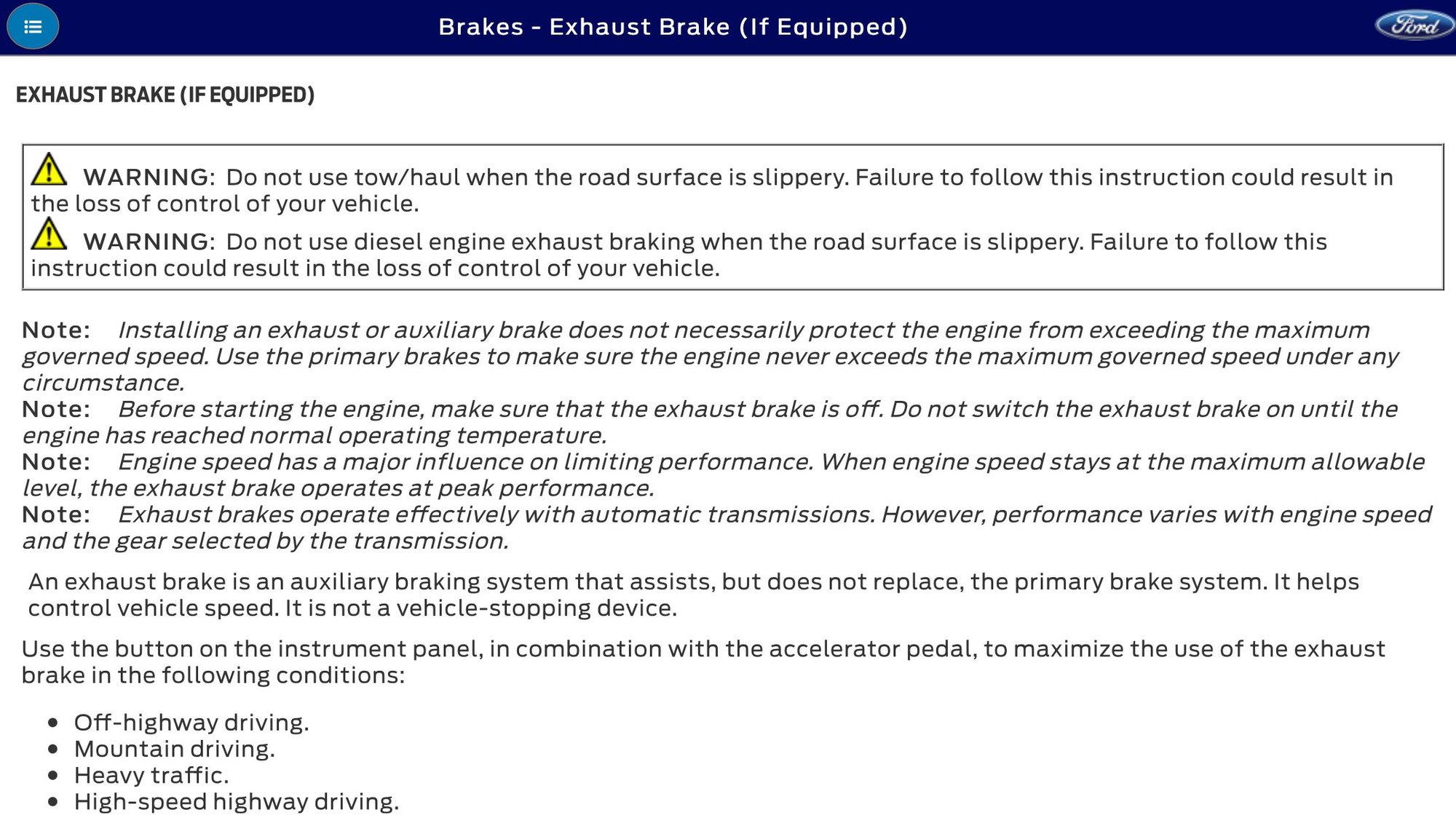

Heading out west and will be going over several tall mountain passes. Even though I've had my truck for almost 5 years, I've never really towed anywhere that I needed the exhaust brake, so not sure how to really use it. I've read the OM (I searched this forum, which was pretty much useless) and see that there are two modes, manual and automatic. I think I understand how to set either mode, but my question is which mode do you normally use and why? Are factors such as what you are hauling or how long or severity of the downhill grade make a difference in which mode you use? Trying to educate myself before I'm at the top of the mountail looking down.

Auto mode makes it come on when you press the brake pedal, or when in cruise if the speed going downhill goes too much above your set speed.
Auto mode will also maintain a downhill speed, out of cruise, by pressing the brake pedal until you slow to the desired speed and release the brake pedal, then auto mode will maintain that speed.
Full on mode works each time you take your foot off the throttle, although there is some lag before it kicks in.
Each mode will only work down to about 1300 rpm, below that it turns off.
I tow a lot, and always use full on, and use it even when not towing.
Cummins exhaust brake works waaaaaaaaayyyyyyy better than on the PowerStroke, one of the biggest things I miss from my RAM.
