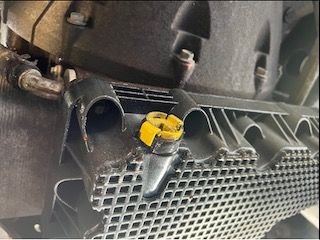

Ok, I found a coolant leak, but not sure where its coming from. I dragged myself under the truck while it was running and managed to get these photos if anyone has any ideas? It appears to be coming along a path from where a hose connects right above the oil pan drain plug.

The quick connects that provide oil and coolant to the turbo are notorious for leaking and the coolant will run down the side of the block. Look down into the valley of the engine and if it's wet, then coolant is leaking from your turbo quick connect.

The valley doesn't look wet, however, the turbo coolant hose quick connect back near the firewall looks like it is wet around it.

Not sure what quick connect your referring to, but it sounds like you found your potential leak source. If you identified external coolant on the engine per your pictures you don't have a internal engine problem. Please share your findings.

I have had coolant leaks from the upper radiator hose, turbo coolant line and failed primary water pump on my 2011. The failed water pump is easier to identify because it's forward of where you are looking so primary water pump isn't likely your issue and upper radiator hose will have coolant in the valley so if your leak is external, turbo coolant line is looking like the correct area to investigate. Apparently I didn't take pictures but I recall the oil pan being wet along with everything else further down the frame. It took a week or two to get into the dealer at the time and I remember going through 2 gal of concentrate plus distilled water, it was a sizable leak.
