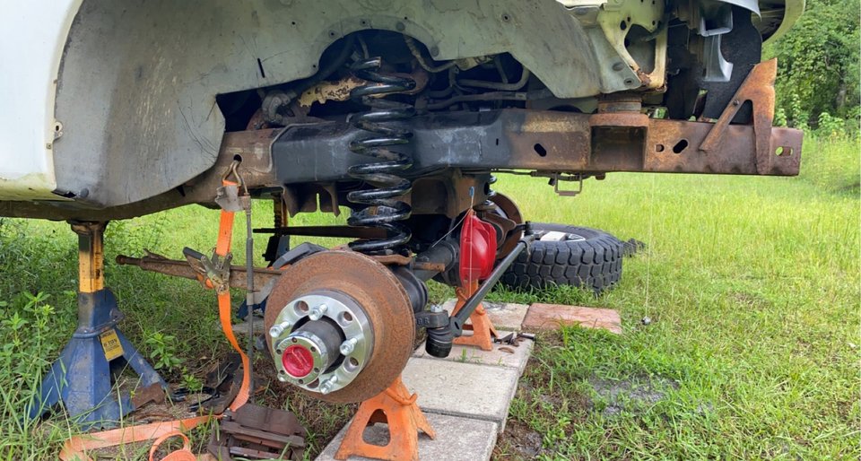

SAS 2000 f150
Main questions: HOW DO I SQAURE MY STRAIGHT AXEL WITH STOCK RADIUS ARMS??
NEED ANY INFO/IDEAS ON HOW THE NEW COIL SPRING BUCKETS SHOULD BE BUILT & SQUARED TO THE AXEL.
Truck details: I have a 2000 2wd that Im solid axel swapping. I have a dana 44 out of a 79’ bronco, its the radius arm style not leaf spring. The truck came with a fabtech 6” lift which ive already removed. The only pieces im using from that kit are the coil springs.

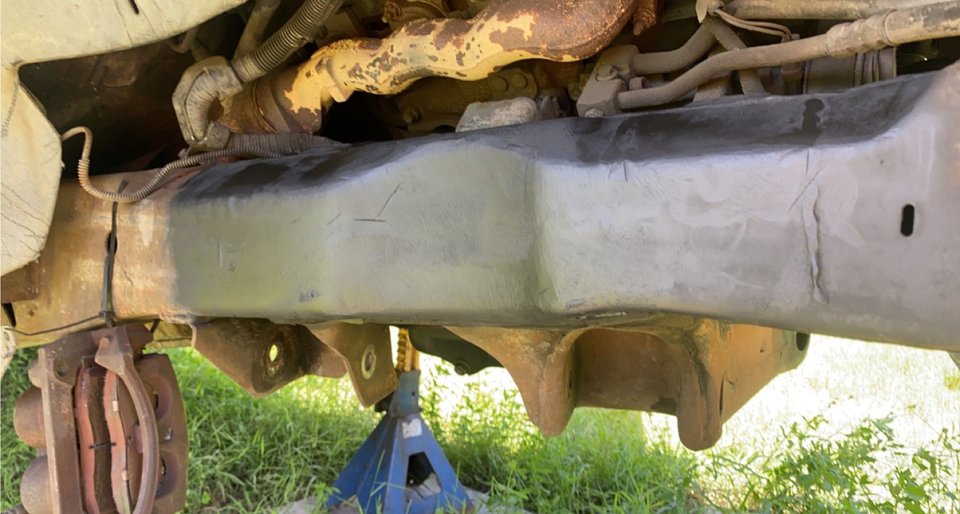

Ive already removed the stock coil bucket/shock towers from the truck frame & that ill need to fabricate new coil buckets. The why the frame rails are formed, I know ill have to fabricate the radius arms, which i already have a plan in mind for and want the ends of the arms to end into a heim joint, not the stock style into a rubber grommet. Also have in mind how i want the radius arm brackets to look like as well.

Im thinking at this point i should cut out the material where the stock coil over upper bucket sat, plate it so its flat surface to work against.
I have the axel squared using plumb bobs and pulling measurements from the front coil spring bucket bolt to the shock bolt on the rear axel.

id definitely plate the frame. spreads the load out, and gives you a nice flat surface.

Once it's back together have a thrust angle alignment done. That will show exactly how square it all is and adjustments can be made if it's not too far off. Any alignment tech worth a damn will know exactly what to look for and recommend a corrective action.
