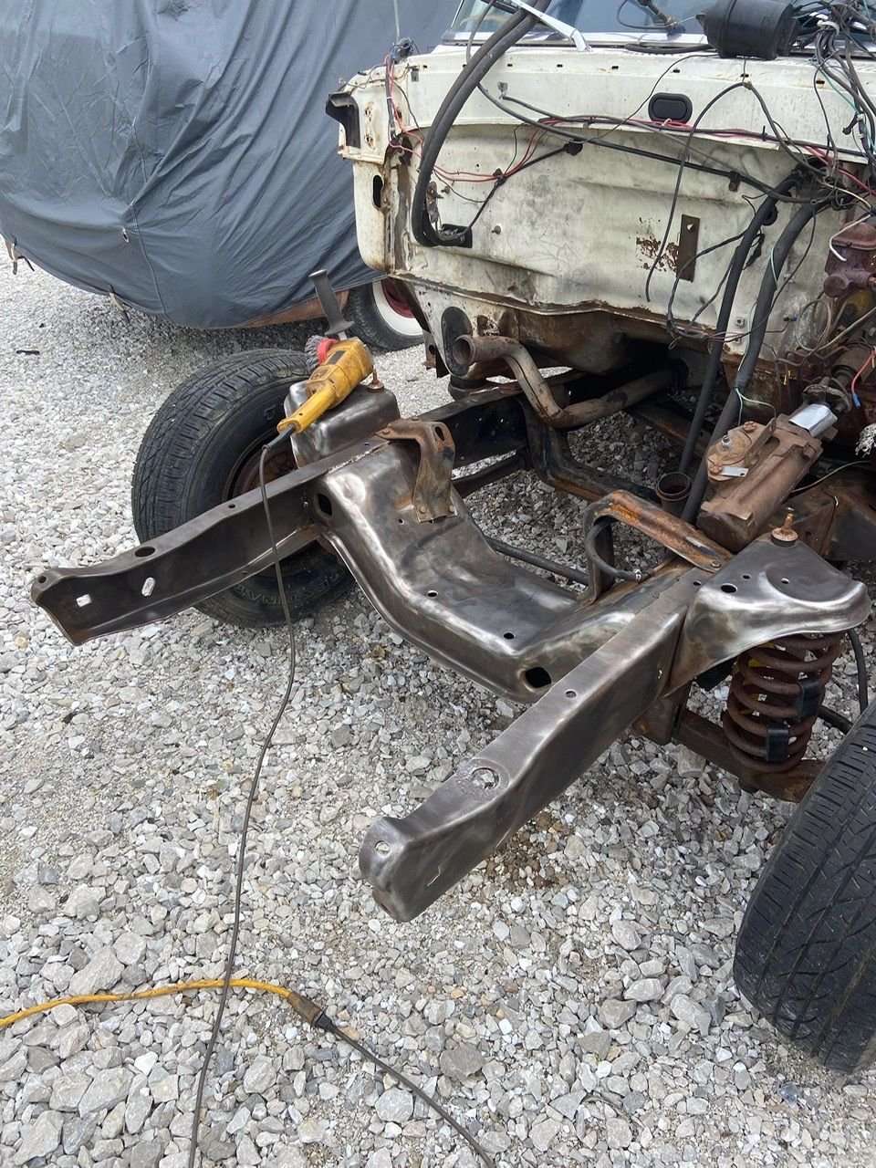

SIL's truck is a 67 with a 352 & automatic transmission. We're adding a 75 frontend for the disk brakes. He'd like to add power brakes while we're at it. Now the questions:
What power master should we use and what modifications will be needed? i.e. push rod adjustment, proportioning vale needed from drum/drum to disk/drum, This is new territory for me and I don't wanna screw up something as important as BRAKES![img]images/smilies2/smhair.gif[/img]
With the change over from 67 to 75 frontend parts and the 67 having a retrofit power steering gear what pitman arm should we use. The steering gear on the 75 was manual and the steering linkages are different than the 67's.
Frontend with retrofit Power steering gear
Inquiring minds wanna know.

Here you go for PS:
How to Install Power Steering in a 2WD F100/250/350 - FORDification.com
What steering box is that? It doesn't look like a 68-79 Ford Saginaw.
PB:
Installing Disc Brakes on Your 2WD Pickup - Pt. 1 - FORDification.com
