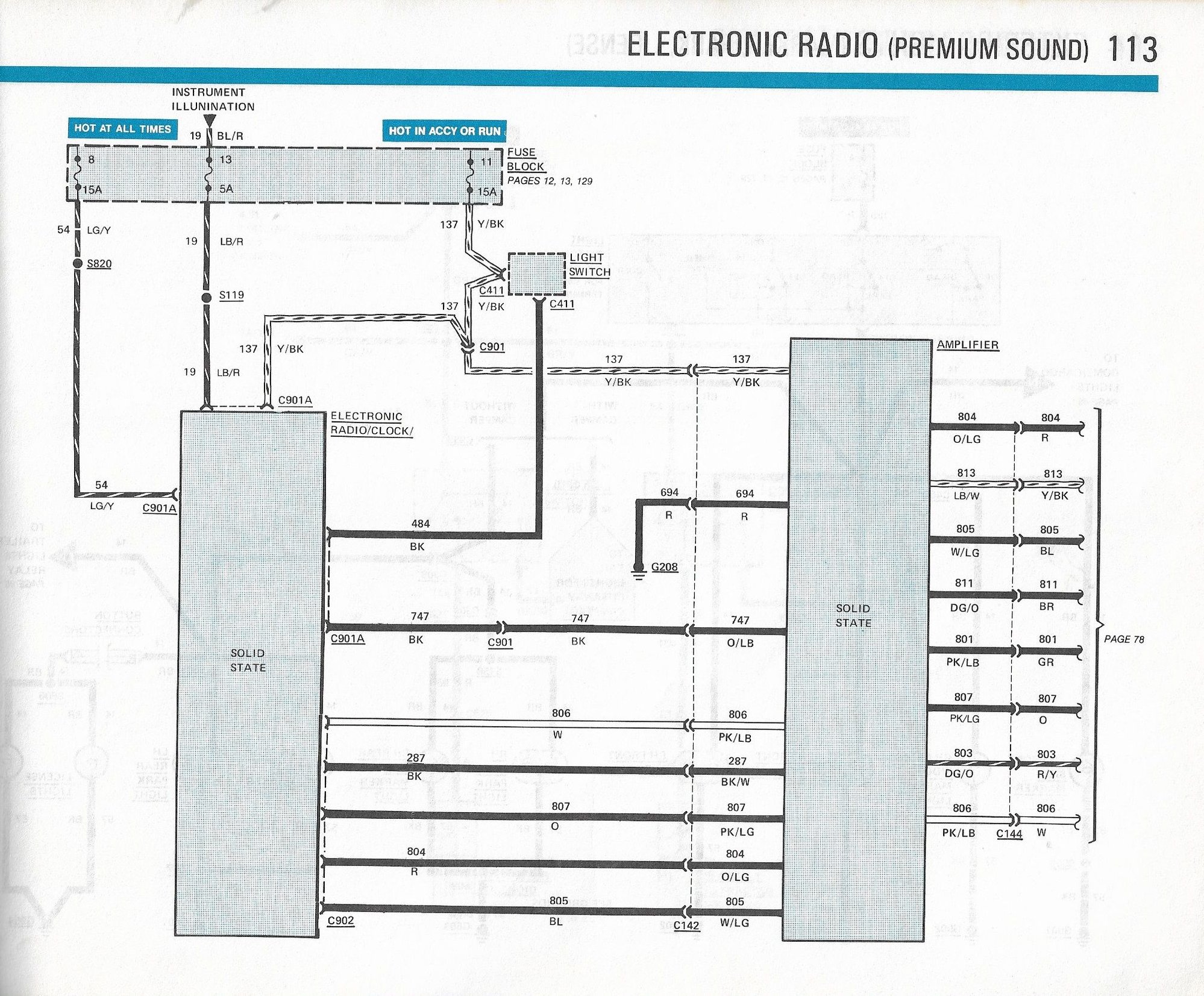

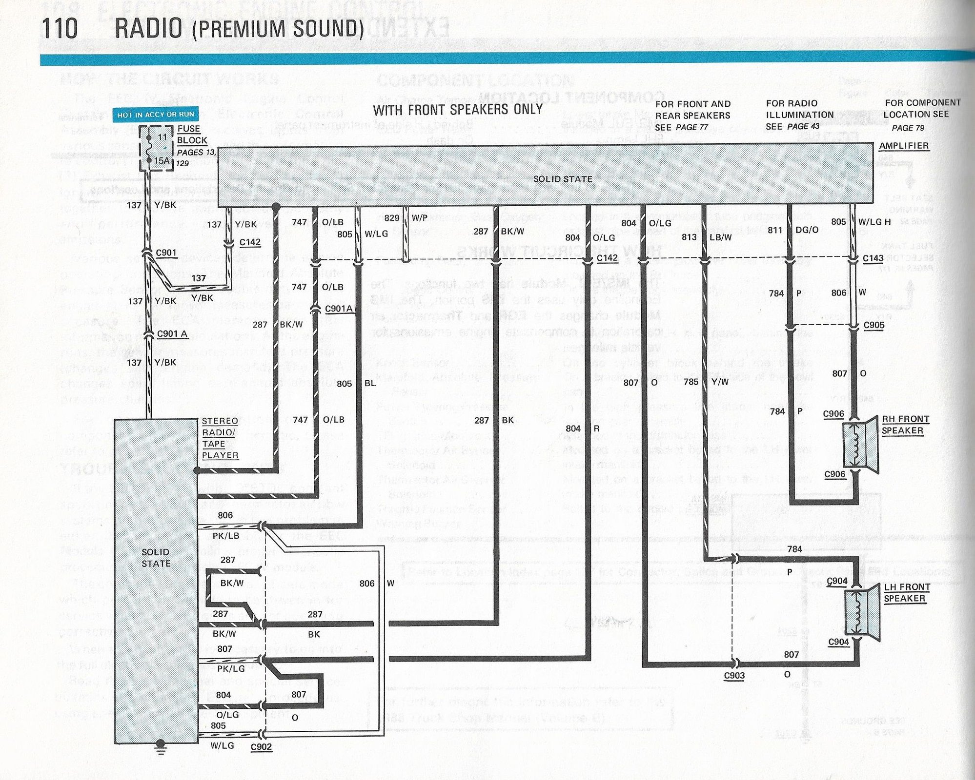

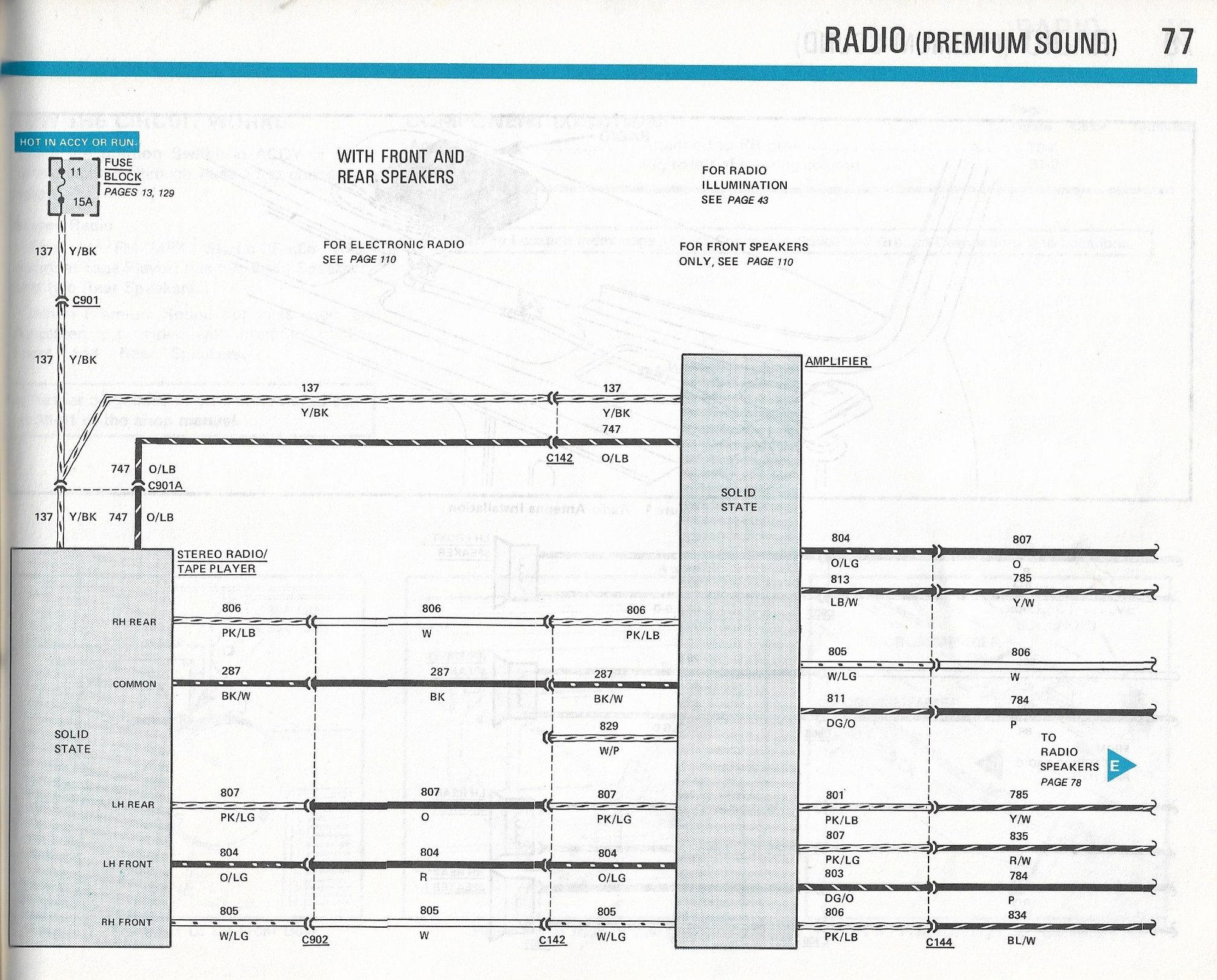

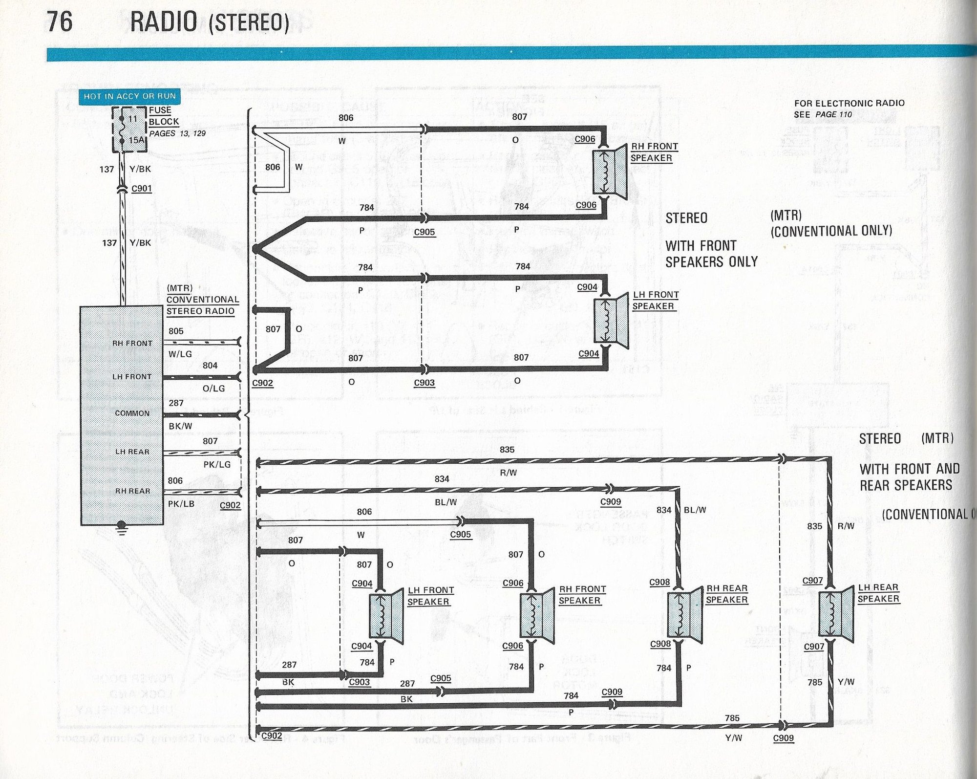

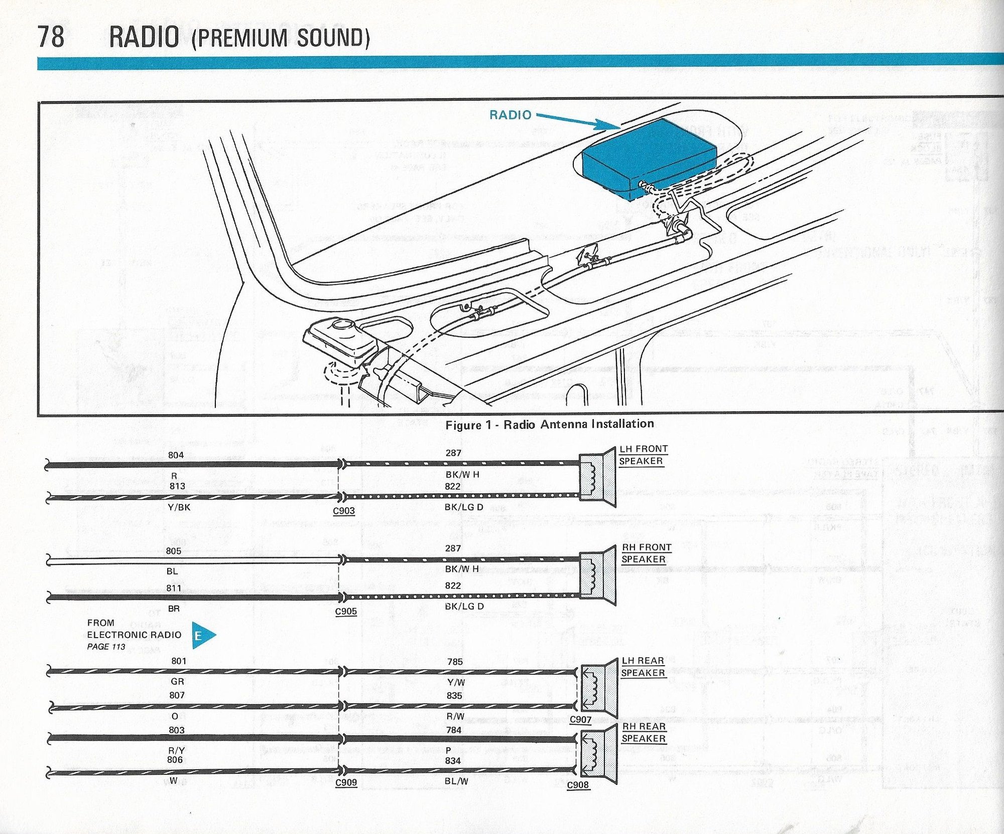

Hopefully these diagrams might help you out. There are several and I included the ones without an amp also.
Here is a link to a 1990 EVTM which would help you out greatly with future issues. Right now though it seems like the 1990 EVTMs must be either in short supply or high demand as the last few I have seen are way high priced.
https://www.ebay.com/itm/15279584342...waAotlEALw_wcB
Here is the diagrams from my 88. There are a couple of pages more but they weren't related to your issue.

Annaleigh, this is fantastic, thank you so much for posting this. It's going to save me so much time.
