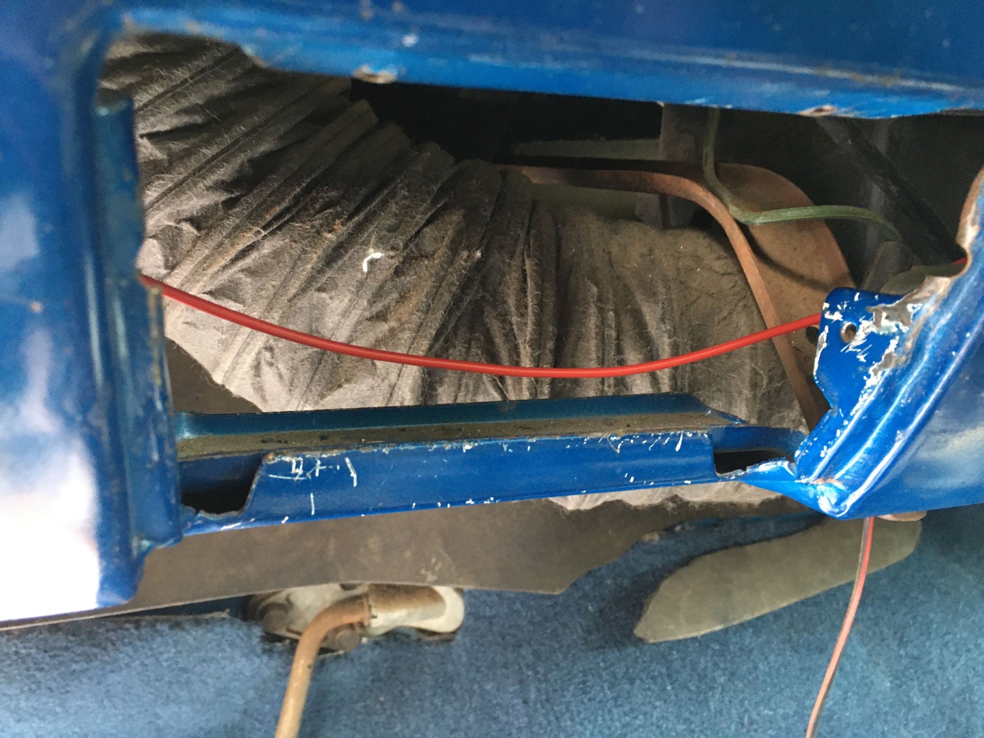

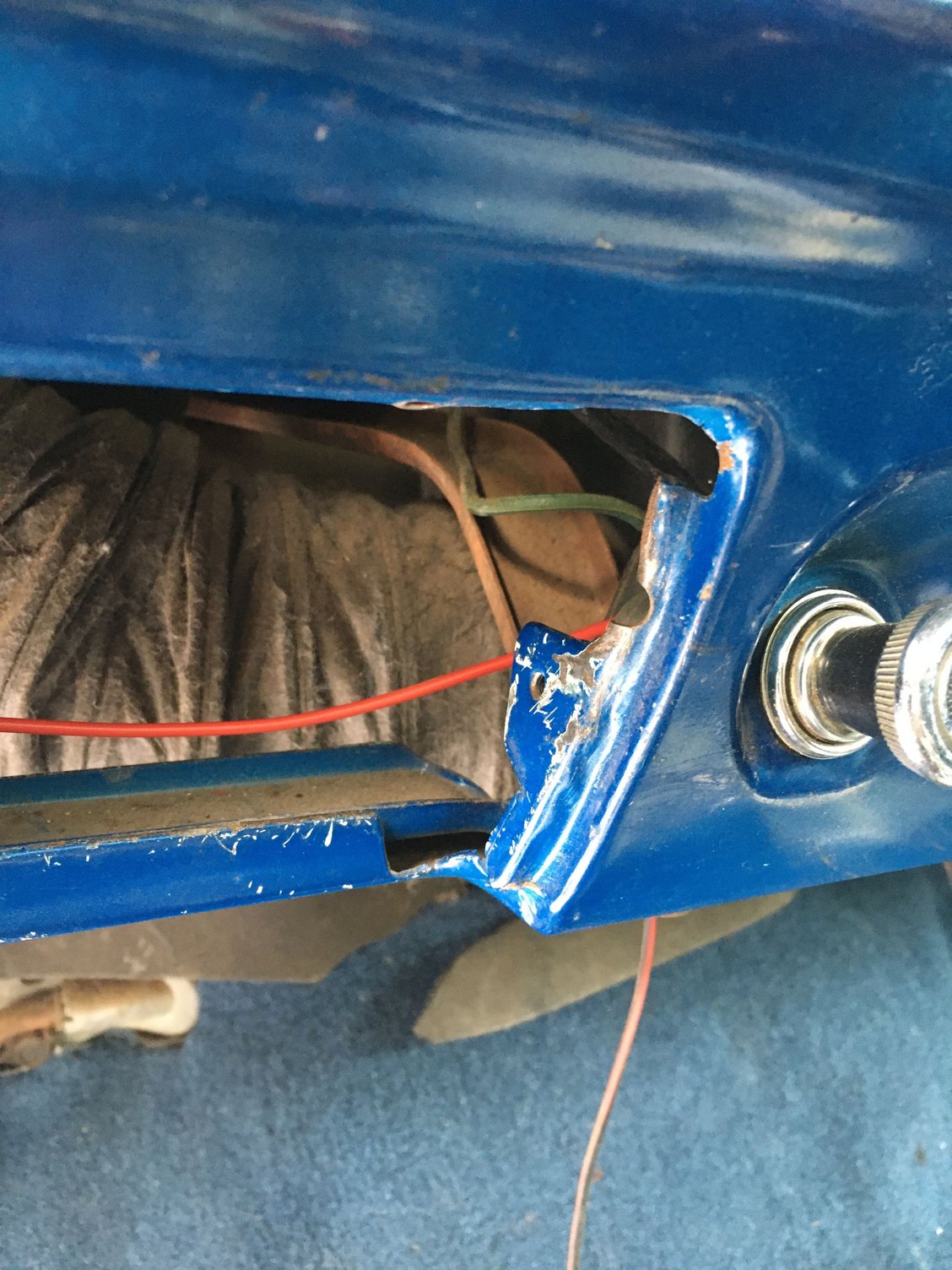

PO had replaced the ash tray with a CB radio. I just found a new ashtray (correct color even) but found they removed whatever it was the ash tray slid into when they stuck the radio in. Does anybody have pics or drawings of what I am missing? I didn't take note of what was there at the JY when I got the ash tray. Are the parts that hold the ash tray part or the dash or bolt in? Does it look like anything was cut out?
Here are picks of my ash tray hole.

Never mind, looks like I am missing the box that screws into the dash

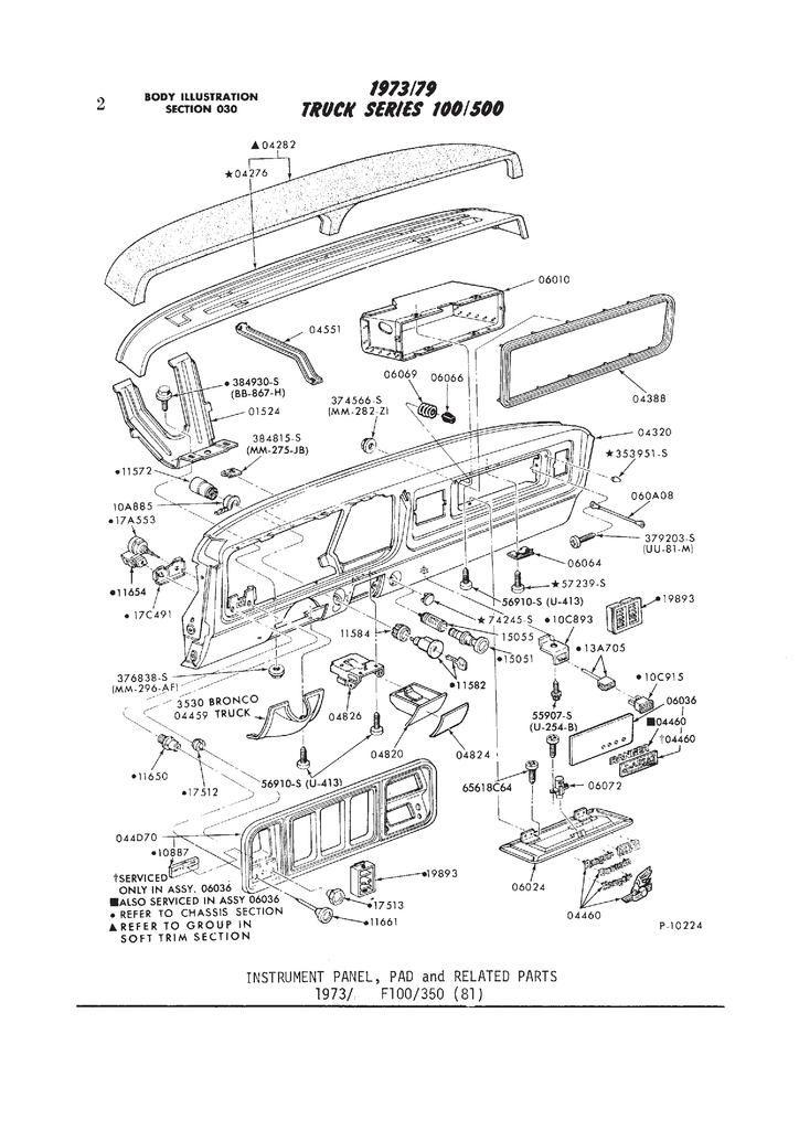

Denty did you get the part figured out? It's #04826 that you need.
