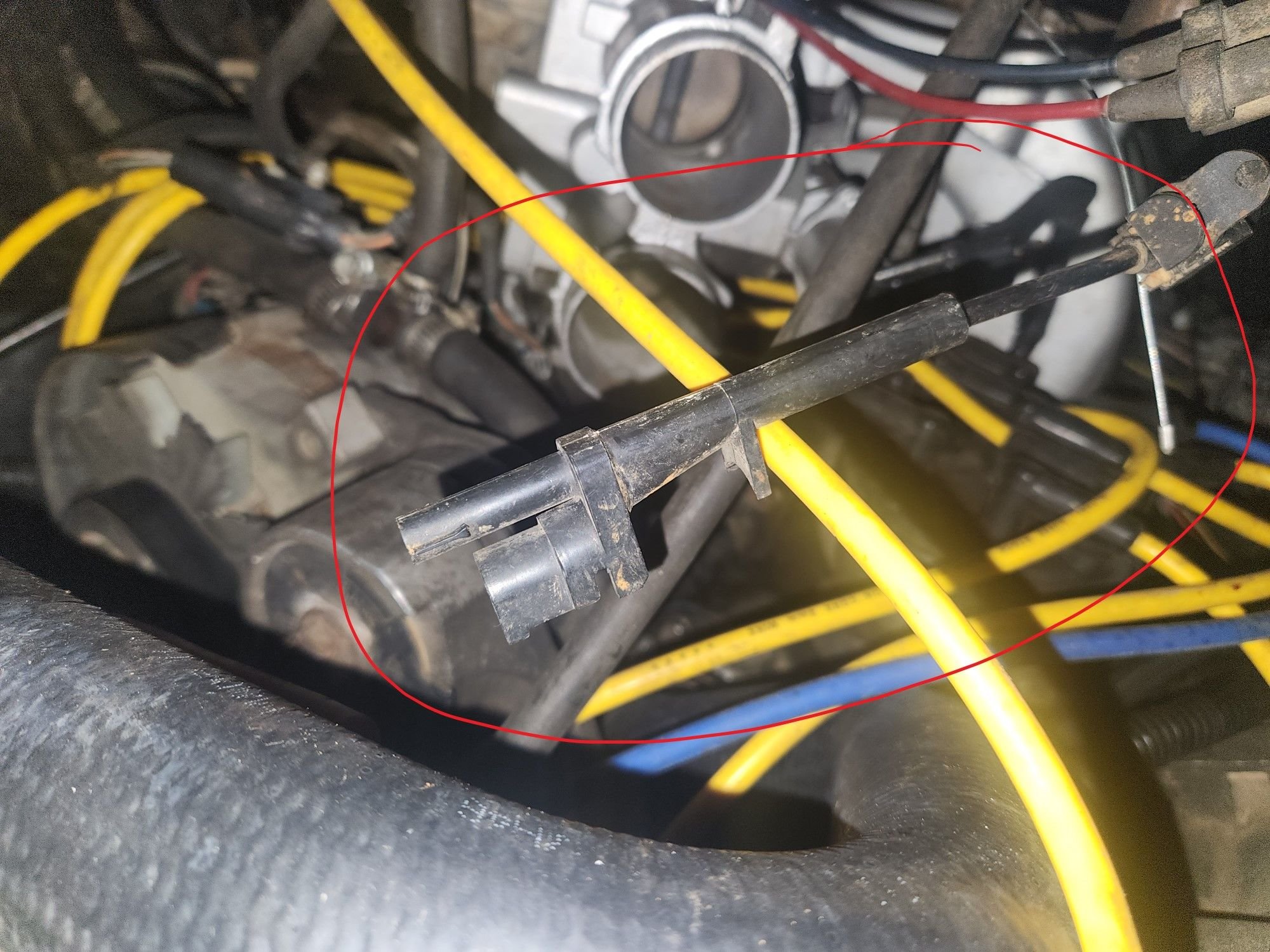

Hey there,
I have the haynes manual and search a number of diagrams but no luck so far. it's right in front of the driver on the side well. This wasn't hooked up anywhere when i bought the truck.
The first image is where it starts (i think is a vacuum canister??)
and the second image is a mechanical cable
it starts here, coming out of the left side of the bulge
and ends here

That is the cruise control actuator and the cable attaches to the throttle body linkage.

Looks like the vacuum servo for the speed control system used on 1992 and earlier trucks.

would this possibly also be called cruise control servo? I just found a few threads but none show where it connects too?

Cruise Control is a GM term. The cable assembly connects to the throttle body. It's a mechanical connection to open/close the throttle body blades. Same place where the throttle cable from the accelerator pedal attaches.

ok think i found a video for it connects to on the throttle body. It is demoing the throttle cable but it also shows what i think is the cruise cable. Will try to reconnect this afternoon and report back. Thank you gentlemen!
