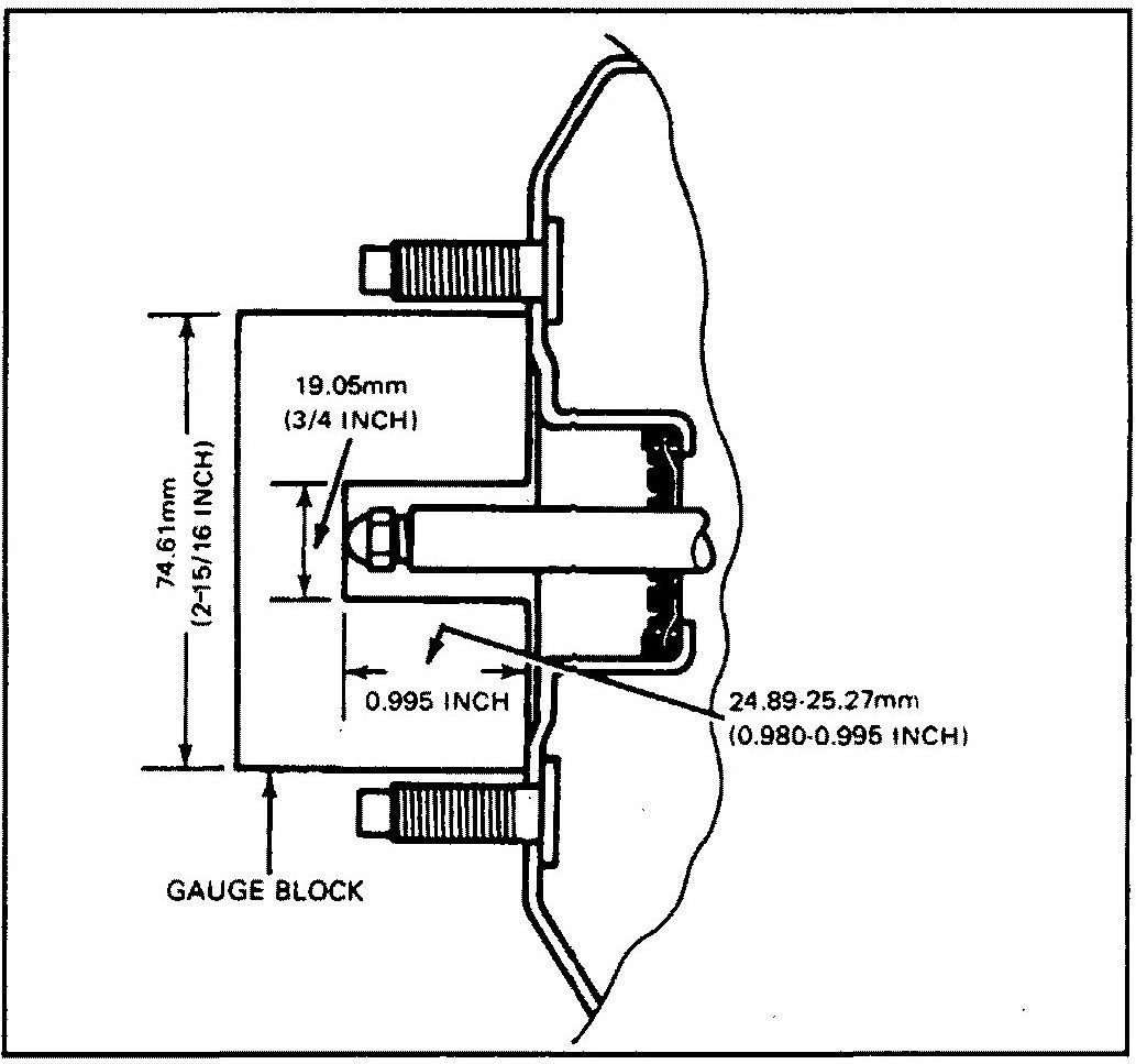

You are aware that when changing the brake booster or master cylinder, that you have to check and perhaps set the brake booster push rod length?
There is a tool just for adjusting the length or you can measure the length or make your own tool. Youtube is full of videos on the specific tool and a few on how to measure the length.
I didn't see where you posted what van you have of engine size but your profile says 1991. 1988-199 use the same booster and master cylinder depending on the GVW. This diagram is from my 1988 Ford service manual showing the measurements and should be the same for your 1991 if its a E150 or E250
My brake booster has been hissing inside when you shut the engine off and press on the brake peddle for about a year now. The diaphragm probably has a very small hole in it. As it gets worse, you will eventually loose the power brake assist.. But it can also cause rough idle and maybe stalling when you come to a stop because you can loose a lot of vacuum through the booster. I bought a rebuilt one from the parts store but haven't installed it yet because its just too hot outside and mine hasn't gotten any worse. I had to buy a rebuilt one because my van was built at the end of 1987 and uses a different booster then if it had been manufactured in 88 and none were available new.
Do not throw your old one away or return for a core. There are a couple of companies that can rebuild it for you. i think all of the parts stores use rebuilt Cardone units for our older vans, at least on my 88 anyway. I am not sure about how many your booster was used.
One of those companies will actually buy some old boosters because they are no longer manufactured. Below is a good video with a lot of good info. Even though they are talking about older boosters its still good info. Also shows measuring tool for a Ford.
https://www.youtube.com/watch?v=PGO0aWJkrmo
Yes that's right, a 91 E350. I was not aware of the need to measure or set the rod, the videos I've watched just show a simple swap. Thank you!
I've received a rebuilt unit from Cardone. I'll hold on to the old one and see if I can find a buyer.

OK, a E350! The diagram I posted above was from a section in my manual that says "Applies to E and F 150-250. So I am not sure if those measurements apply to a E350. I will have to check later this afternoon and see if there is a different section that applies to your E350.. Maybe you will have to use a different method to set the gap. Most people say 1/16"
Old Jul 30, 2022 | 09:36 AM
12characterz's Avatar
12characterz
Joined: Dec 2021
Posts: 34
I just found the same image in my manual. So it applies to E350 as well.
