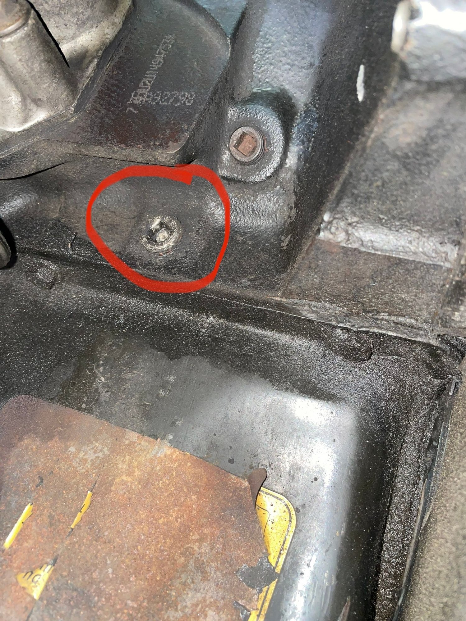

Please see attached picture and hep me identify the block drain that allows me to drain the coolant so I can complete my oil cooler gasket R&R. Notice there are two plugs.
I also noticed that the lower plug seems stripped, making me wonder if I’m better off just leaving it in place and accepting that I’ll get wet when I remove the rear oil cooler.
My 1/4” ratchet extension definitely is too small for both the upper and lower plugs.

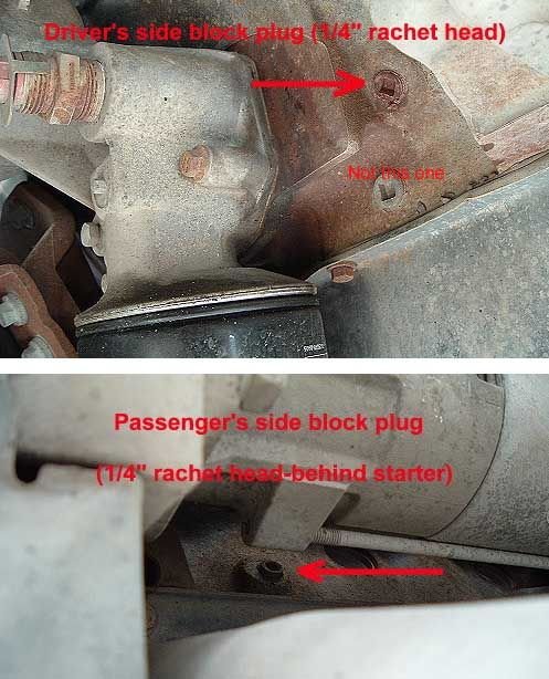

The upper plug is your coolant drain plug.

Agreed.
I had this picture to make sure I never forgot:

Thank you.
out of curiosity what is the red circled plug?

So to be clear - the one circled in red is NOT the coolant plug.
out of curiosity what is the other plug?
correct. The one you have circled returns to the oil pan. I have my oil bypass filter plumped into that fitting.

That little plug circled in red is for engine oil.

And this one at the back is for oil pressure

And another plug for oil pressure, in the same general area, on the same side of the block...
(small square head plug on the lower left in oil cooler / oil filter casting assembly)
