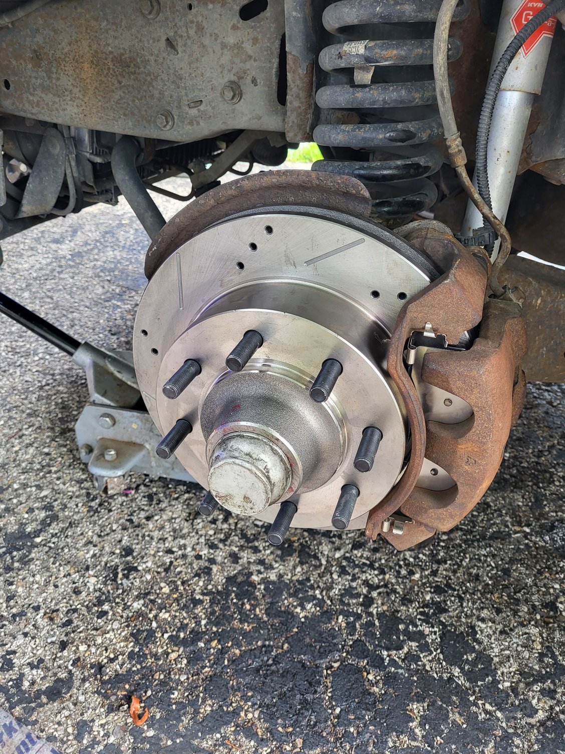

Please help!! I am putting on slotted and crossdrilled rotors that i ordered from Rock Auto and the lugs dont fit the new wheels. The new hubs are on, but the lugs wont go on the wheels. Whay do i do? Rock auto doesnt have a custom service number. Has anyone done this job? What size thread pattern are the new studs? If you know a solution.

Do your old wheels fit over the wheel studs?

I took off one hub for a second and put back on. The hub studs are marked 5379-2 H. But what size is that? I cant find it on the internet.

Yes they do, perfectly. but the new studs are larger in diameter that the original slighly.

I have Powerstop rotors AR8181XR, and AR8181XL for front left and right. Found out the lugs are 9/16-18. I bought some from Orielly Auto Parts, but the flange washer is WAY to big to let my center caps fit properly so they are only temporary, plus for 16 they were just shy of $200. What a rip off!

It doesn't sound right that they would be 9/16-18, everything Ford is metric. But the 8181 rotors are for 2003 to 2005 Excursions, so those lugs would be appropriate, M14-1.50 I believe. Earlier lugs were M14-2.00 from memory. 8573 are for the '99-02.

It might not sound right, but thats what they are! Im calling Powerstop in the morning to get to the bottom of this. I have lugs on the wheels on it now, but need the proper ones with the 1.18" flange washer on them, not the monster i got now. Original on left, new lug on right.

9/16" Bolt = .05625 = 14.3mm
16tpi = 0.056" advance per revolution
1.5mm advance per revolution = 0.059"
A 9/16-16 nut will fit on a 14-1.50 bolt.
I would get a 2005 Excursion lug nut and see if it fits.

But there is nothing that Ford has engineered since the mid 70's that's not metric. If Powerstop put in imperial studs, they have a manufacturing issue.

I called Powerstop this morning and talked to their tech support. The guy said they would replace my new rotor/hubs free of charge. I had to send them an email with my order from Rockauto. Didnt seem to hard to do, and they didnt bulk at it. Lets see if they actually come through now? The verified on the phone they are supposed to be M14 1.5. The guy didnt doubt me what I have are 9/16 18. I can't be the only person to get these like this, so id say it is/was an internal issue. Hopefully they come through, or thats my last set of anything from Powerstop. Im probably done buying from Rock Auto now.
