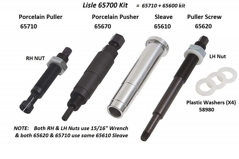

I changed mine to the newest SP546 plugs in '19 for the cost of 8 plugs and Lisle 65700 set and a little of my time.

It takes a little time and some effort but if you have the $890 to throw away -go for it. The first plug change requires the lisle tool and learning how to get to the hard ones. I do use a little antisieze on barrel and threads but only nickel stuff rated for 2400 f . make sure you replace boots now and then and use a small amount of dielectric grease on each end . 60k on plugs is enough don't push it . Have changed them four times now at 250k . So maybe I have saved over $3500 on plugs alone . Maybe I can get this engine to 350kmiles.
