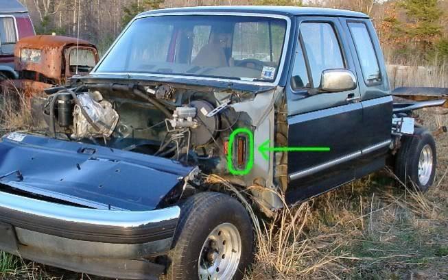

Disconnect the battery and then pull the PCM out for inspection.

There is a 10MM bolt in the middle of the PCM that you loosen. The bolt will not come out only loosen. Disconnect the PCM harness. You will need to use a broom or similar to push down on the wheel well to be able to slide the PCM out all the way. Then open it up and look mainly at the capacitors which there are two or three and standing upright. If they are bulging or leaking or components are burned, you will need a PCM and they are available at Parts stores. All are reconditioned but come with a warranty. Let Conanski know if you need one and he will make sure you get the right one.

Good day gentlemen I hope you are staying cool in this heat. I will definitely look at the emission sticker for the year model if it's still there, didn't think to look when I was tinkering on the truck a bit ago. I removed the PCM and there is definitely a problem. I can only assume it's a capacitor, from the description above, it is standing up, and it is toast, even I can see that LOL. So now I suppose I need a new PCM. Here is what's on the sticker on the PCM I pulled out:
EEC-IV EFI-SD40A
F3TF-12A650-NC G POP2
63ESA40A59 13288-205 4J14
I have checked Rockauto and they sell them for about $105.00 or I can probably get one locally for a little more money. So where do I go from here gentlemen, obviously purchase a new PCM, but how do I make sure I am getting the correct PCM? Again I thank you all for your input and advice, it is greatly appreciated.
