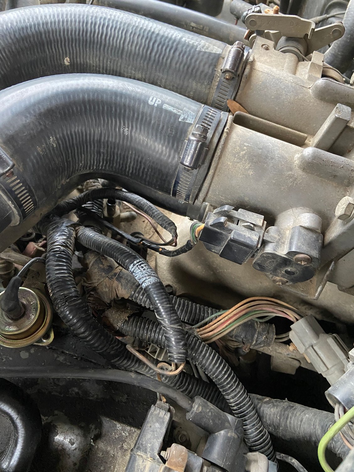

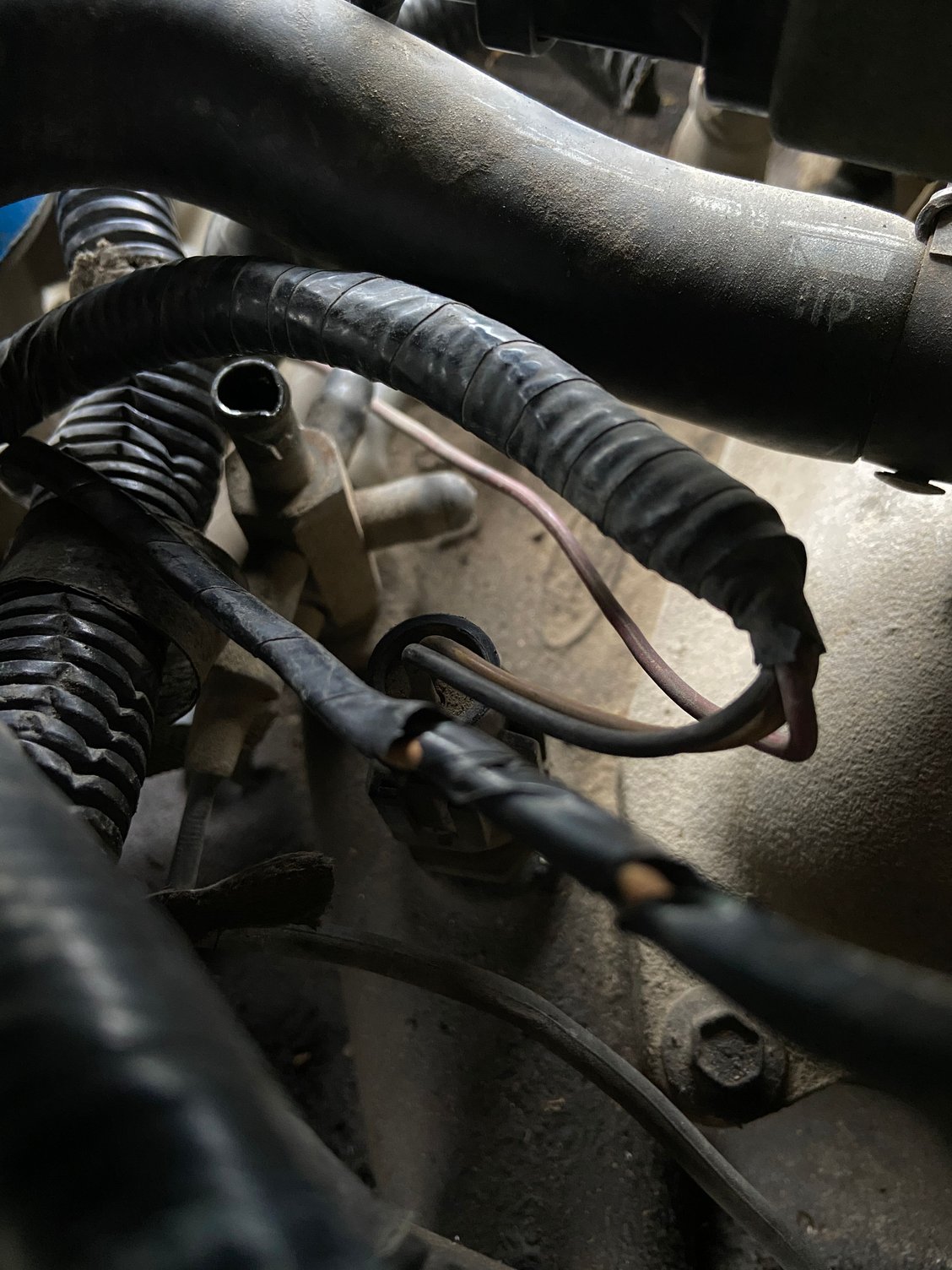

Old Jul 2, 2022 | 07:42 PM
Mwjahnke's Avatar
Mwjahnke
4th Gear
Joined: Jul 2022
Posts: 4
I’m looking for the line that connects here
This is the same port. It is under the inner intake boot.
Old Jul 2, 2022 | 08:14 PM
SFaulken's Avatar
SFaulken
Joined: Nov 2009
Posts: 2,190
Likes: 620
That is typically the line to the Power Brake Booster, or the PCV Valve.
