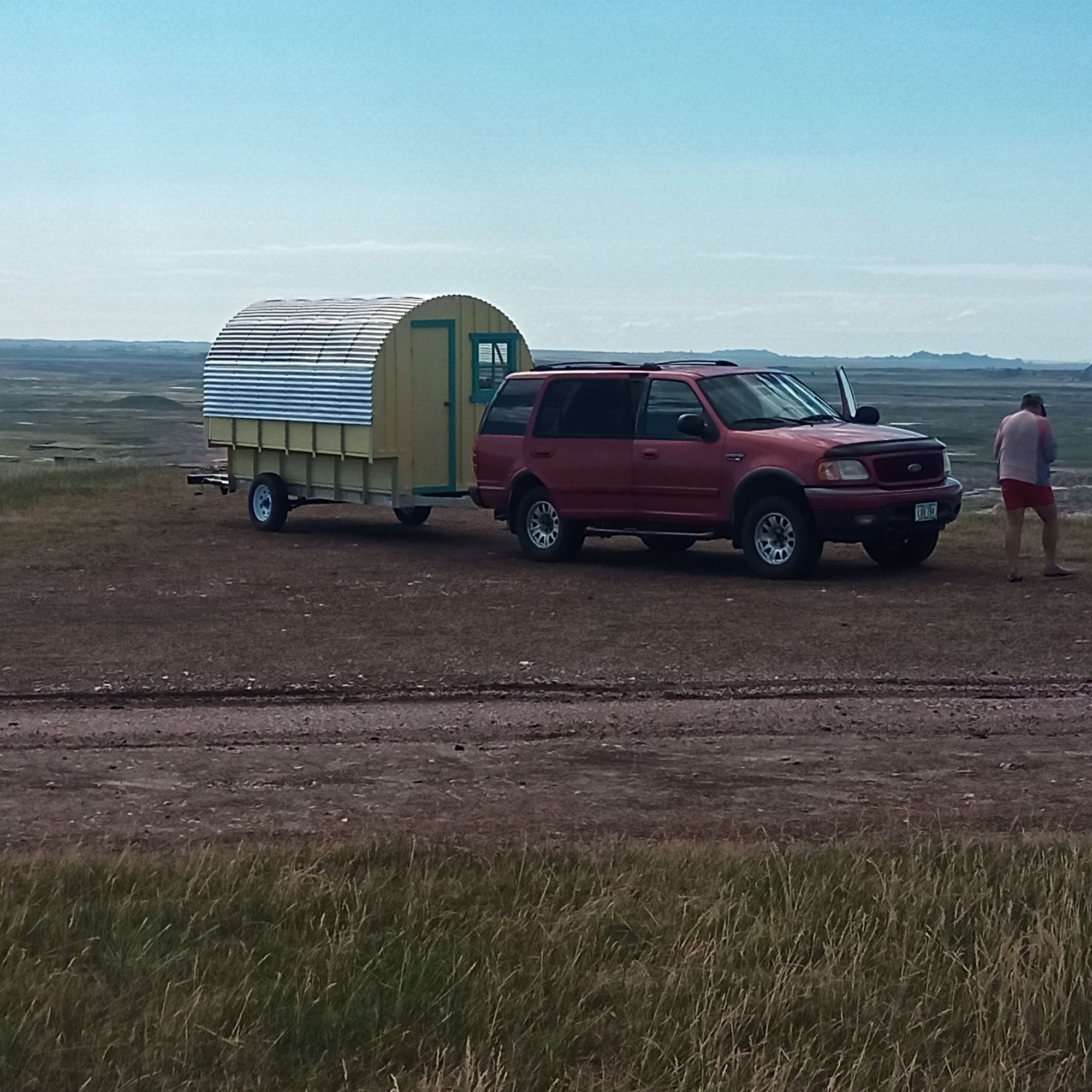

Update: i pulled the fuse, changed the t-case fluid, got all tires the same pressure and left for vacation pulling a 2600lb travel trailer and much gear in the way back. I had also installed air lift bags inside the rear springs and I'm glad I did. The problem persisted, but was more noticable with the trailer and it would make the sound more turning left, but with moderate power it would even do it while on an on ramp. The whole trip was a little over 2200 miles. I put the fuse back in after the first day because we were in the Badlands and it rained (and hailed!) and we didn't want to get stuck in that mud. The awd works good and later in the deep loose sand by a lake it made all the difference. We had problems with running into the wind at even a modest 65mph, and at one point the top rad hose came off while turning 3800 up a long grade in second. Turns out the fan clutch was bad. Glad we had a ton of water with us.
if I only use part throttle, the sound and feel is negligible so I'll just have to live with it.
