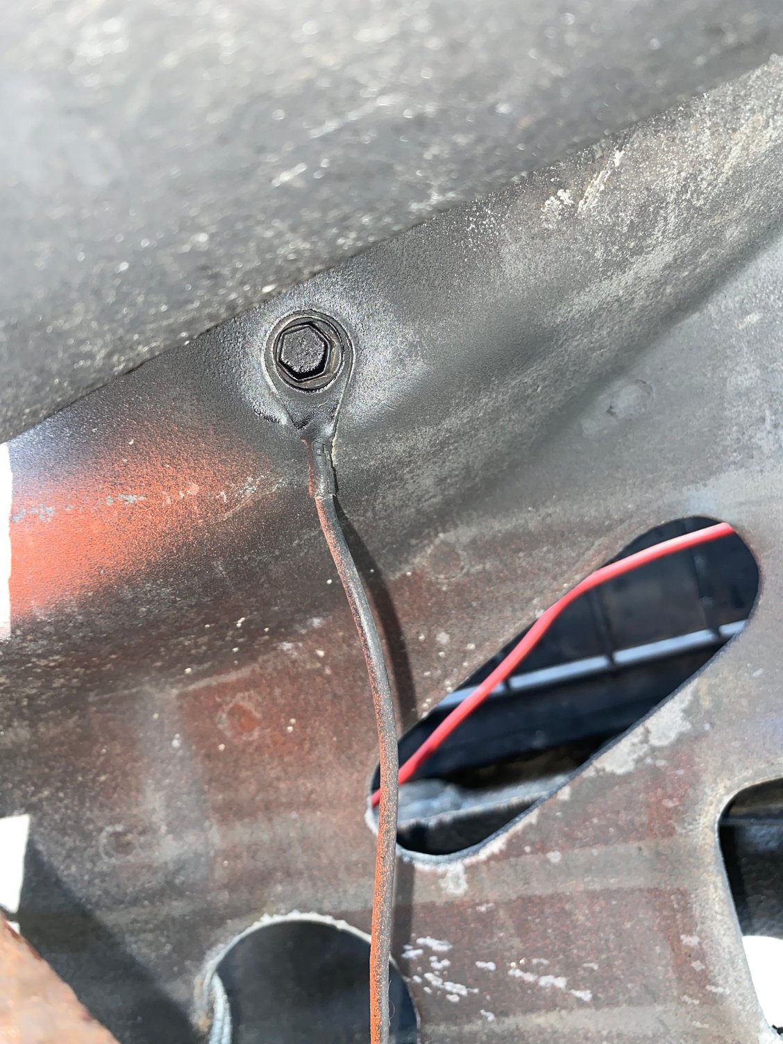

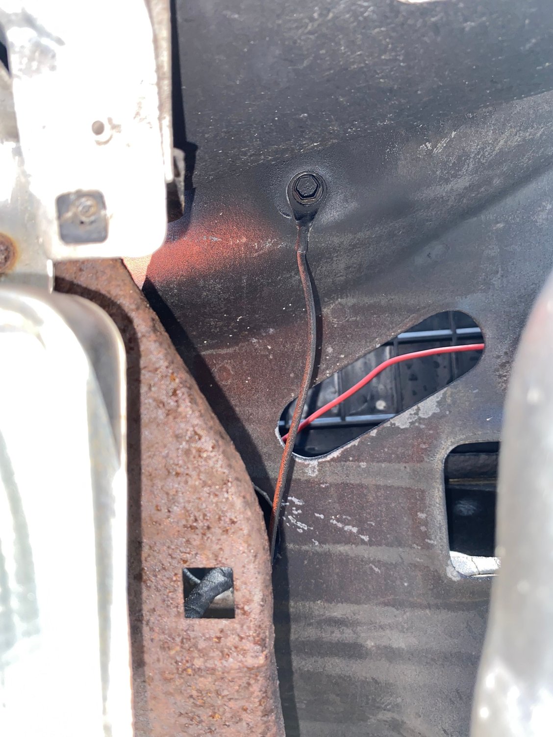

I’m trying to track down the ground wire for that socket. Before it grounds to anything it bundles with the headlight wires. The picture below shows a wire come from that bundle and where it grounds. Is this the ground for the headlight AND the turn signal or just the headlight? Also, I took the pictures after I removed the screw, cleaned everything up and covered in fresh paint.

Live update: fixing that ground did not fix the blinker problem. I did notice that it now is on goes slightly dim and then goes back to bright in sync with the driver side blinker. Would that still be a ground issue? If so where would the ground be for the passenger side blinker? Also, why would The ground be good when the headlights are off but bad when the headlights are on?
