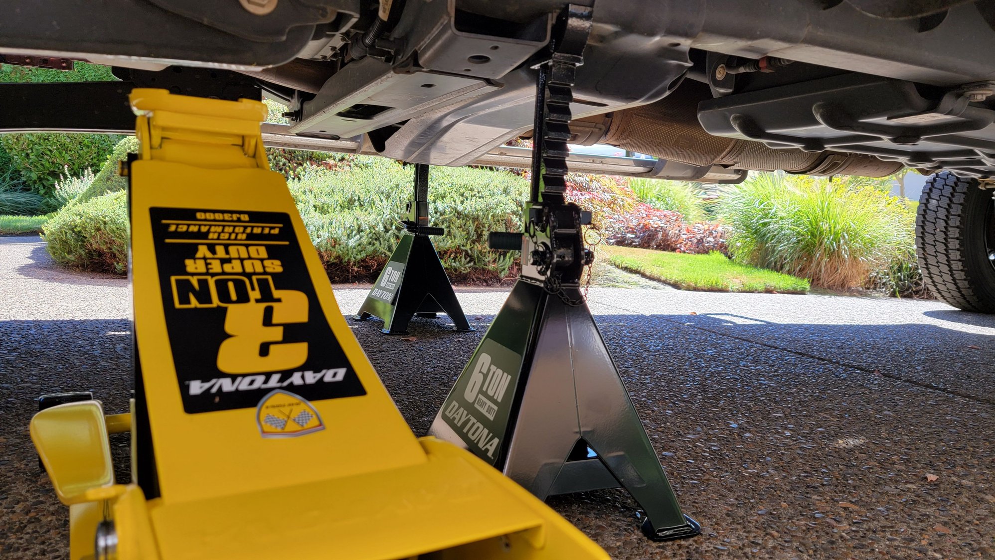

Finally got around to this today. I had it built up in my mind as being harder than it was. Hi lift floor jack didn't need any wood under it to get the tires off the ground. I only ended up removing them for convenience when unhooking the shocks (and all needed to be retorqued anyway because I anticipated removal).
I went very slow (which I always do when I'm learning something new on a critical component) and it took 3 hours. Guessing the next time would be 90 minutes and that someone who does this for a living would need far less than that.
