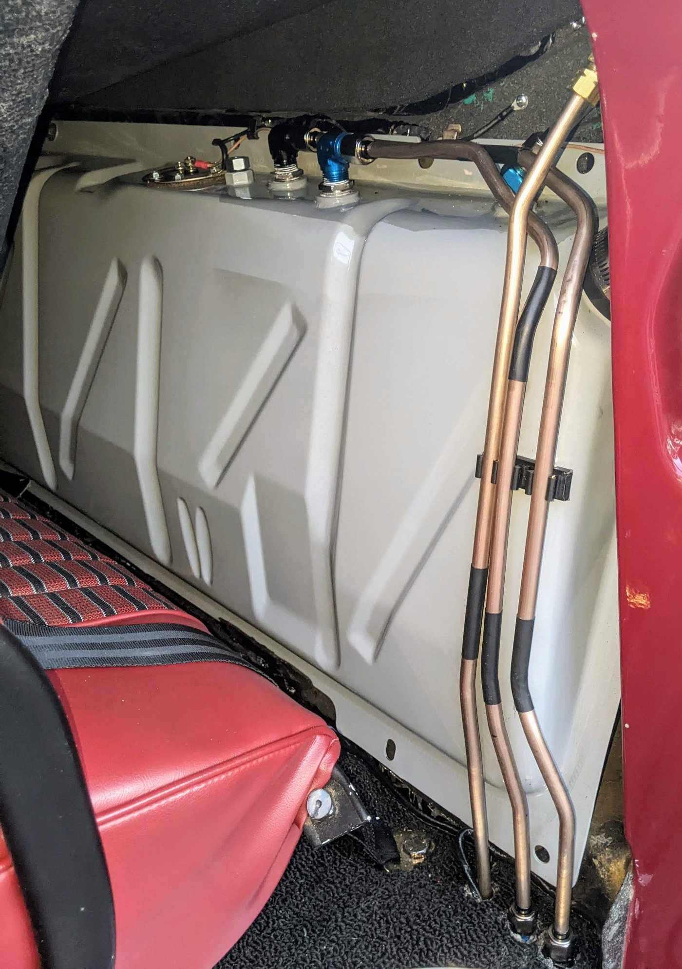

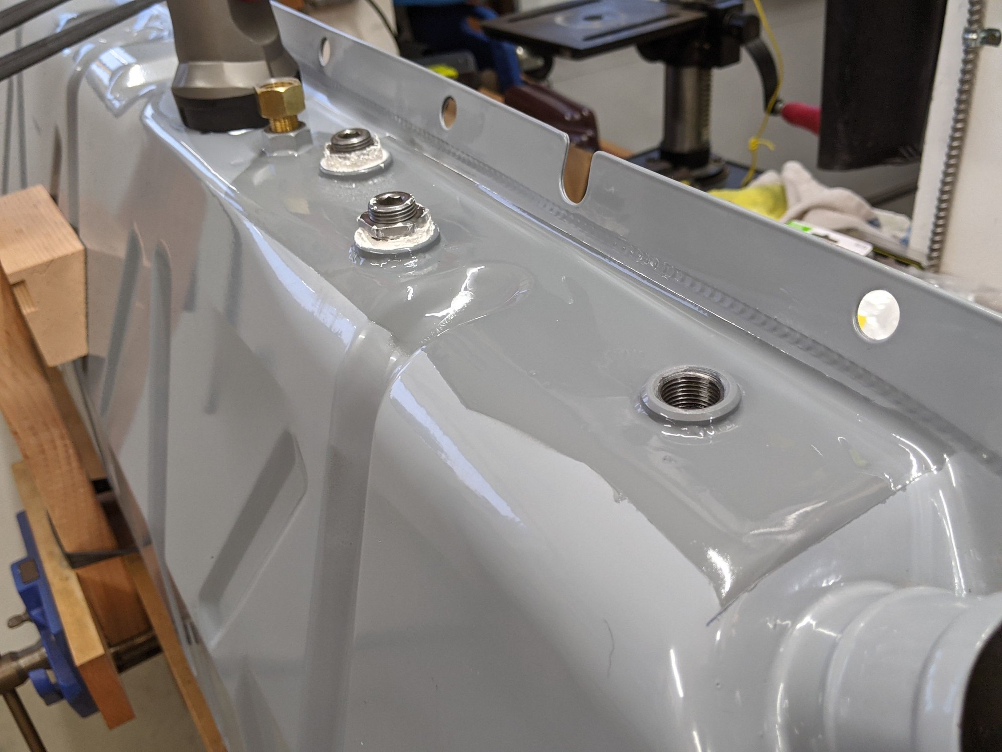

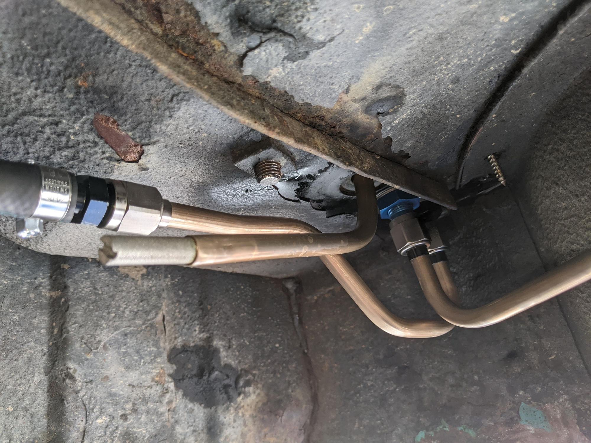

And since you are running a Sniper, the tank needs to be well vented for pressure, so that the return line flows easily back into the tank. I believe the proscribed install for Sniper is to have a dedicated air vent, rather than rely on a vented cap. So keep an eye out for pump or fuel delivery problems related to that. I installed a dedicated vent, and can send photos if you'd like.

Here are the tank mods. Welded in bungs for pump feed, pump return, vent. I Wanted 3/8” line for feed, so I did not use the stock fitting/straw. Could have used that for the return, but did not. My original fitting is now capped. The vent has no straw – just a hole at the top of the tank.
Here’s the routing from the tank. Black is the return, blue is the feed, the vent is blue and obscured behind the copper. Also some pics of the pass-through holes in the cab floor. I used the stock pass through for the vent, and did not use a bulkhead fitting for that – just bent the tube in a way that I can fish it in and out of place.
Here is the finished vent. Always pointed downhill, so I don’t create a p-trap for any fuel that might get in the tube. Added a sintered plug to keep the tube from getting plugged somehow.
Here is the detail in the cab. The vent tube needs a large vertical loop so that fuel does not slosh into it and pour out the end. (You could alternately consider a check-valve approach) My first effort was a continuous 3/8 hardline that looped up behind the cab corner gusset. I did not get that loop tight enough to go high enough up back there, and fuel was sloshing over the loop and coming out the end. I cut out that portion of the hardline and replaced it with ¼” hardline which was much easier to build a loop that went high enough and worked. This is ni-cop. I formed the basic 180 degree turn on the bench, then I just pushed it up behind the sheet metal while also bending it bit-by-bit to create the bend along the long axis. This allowed me to create a loop that can be installed/removed. I cut it to length and spliced it into the 3/8 hardline with compression fitting adapters.
Simple carpet does a fine job in covering the mess
